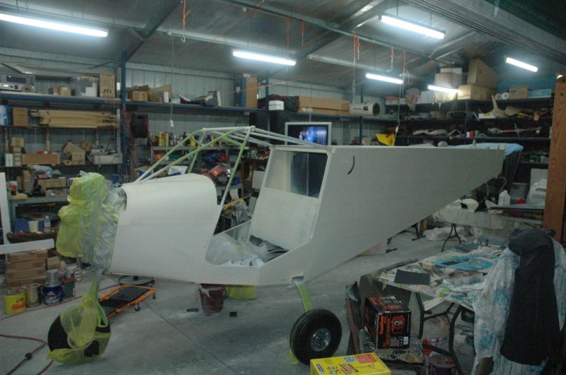

Sorry for the lack of communication and updates on our Norfolk Island Sav S build. Getting there slowly....... Still a hand full of jobs to do and a bit of painting to finish off but most important thing of all......still enjoying every moment of the build1920745878_SavMay2014005.jpg.1a96a7874f562eae41a1a1cb09dc2ad7.jpg .
Looks good hadyn good to see she has made it to the hangar. It will be interesting to see how those solid rods goMark
Thanks mark. Very happy with the throttle rods so far. I have read your concerns on this topic, if we are not happy it is very easy to change again. FYI the 767 actuator rods we used are exactly as they have come off with no length adjustment required, like it was ment to be....

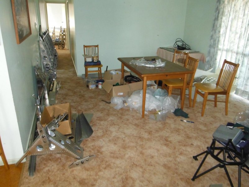

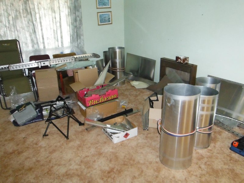

Guy, you just have to accept, as Derek Liston says, "life gets in the way" sometimes. When life leaves you alone for a while you will make some real pregress. Main thing is don't beat yourself up when things get busy and progress slows down. You can see the difference in the loungeroom you saw and the pictures posted in this thread, we are nearly back to that part of our year again, so I am getting keen.
