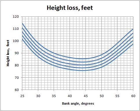

Dafydd Llewellyn Posted June 2, 2014 Posted June 2, 2014 Well, I thought I was writing in English, but judging by the responses on this thread, maybe not. The aircraft I'll be flying is a motorglider of fairly modest performance. My preparation for an EFATO will be, to have determined the height loss in the turn-back manoeuvre that I have described, on a hot day at altitude. I'll put a disc of thin perspex on the face of the altimeter, held on with a dab of glycerine, with a reference marker on it. Part of the pre-takeoff check will be to set the reference marker to a height equal to the runway altitude, plus the height loss in the EFATO turn, plus the estimated height of any trees , power lines etc that would have to be cleared when gliding back in, plus 50 feet. If the altimeter does not reach the reference mark as I climb out over the obstacles, I will know that I cannot make a turn-back until after the crosswind turn. The rest of you can do as you damn well please, but that's my way of tackling the issue.
M61A1 Posted June 2, 2014 Posted June 2, 2014 Well, I thought I was writing in English, but judging by the responses on this thread, maybe not. The aircraft I'll be flying is a motorglider of fairly modest performance. My preparation for an EFATO will be, to have determined the height loss in the turn-back manoeuvre that I have described, on a hot day at altitude. I'll put a disc of thin perspex on the face of the altimeter, held on with a dab of glycerine, with a reference marker on it. Part of the pre-takeoff check will be to set the reference marker to a height equal to the runway altitude, plus the height loss in the EFATO turn, plus the estimated height of any trees , power lines etc that would have to be cleared when gliding back in, plus 50 feet. If the altimeter does not reach the reference mark as I climb out over the obstacles, I will know that I cannot make a turn-back until after the crosswind turn. The rest of you can do as you damn well please, but that's my way of tackling the issue. A china graph pencil may work well for this, easy to mark, easy to stow, easy to clean off.

rgmwa Posted June 2, 2014 Posted June 2, 2014 A steep turn is defined in the day vfr syllabus as 45 to 60 degrees. You may not call 45 degrees steep and you may use 60 degrees, but it's right out at the edge of the syllabus and was not taught for PPL in aircraft which had a much higher degree of dynamic stability design than many of the aircraft we see in RA today. I was taught 45 and 60 deg steep turns as part of my PPL training, and was tested on both. rgmwa

Dafydd Llewellyn Posted June 2, 2014 Posted June 2, 2014 Not heard of it, It just sounded like a lot of effort when I could just use a chinagraph pencil. Even Mirage pilots used them to write stuff on the canopy, like call signs and frequencies. Either way would do it. However, if people wanted a simple gadget to make the pilot conscious of the turn-back height-loss issue, then one could put two marks on the perspex disc, spaced apart by a suitable margin to cover a typical turn-back manoeuvre plus, say, 100 feet - and just turn the disc to align the lower mark with the altimeter large needle as part of the pre-take off check. One could add "not above" and the density altitude at which the zero-flap climb gradient equalled the best glide gradient. The chinagraph pencil way does have the advantage of requiring the pilot to think about it, I suppose. This thread asked for constructive suggestions as to how to improve the turn-back accident rate; making the pilot conscious of the physics of the situation and giving him a simple go/noGo criterion would seem to me more constructive than arguing about the definition of a steep turn. There seems to be an underlying misapprehension that the steeper the turn one can make in a turn-back manoeuvre, the better. This is incorrect; there's a trade-off between how long it takes to fly the turn, and the rate of height loss due to the increased induced drag. RAA aircraft are certificated for "normal category" flight manoeuvres, which include turns up to 60 degrees angle of bank. In a 60 degree turn, the load factor is 2.0, so the speed needs to be not less than 1.5 times the stall speed. Now, the minimum drag speed (at which the parasite and induced components of drag are equal) is usually less than 1.5 times stall speed, so the induced drag may contribute perhaps 40% of the total drag, in level flight. However, the induced drag increases in proportion to the square of the load factor, so in this case, the rate of sink would increase by (0.6 + 0.4n^2), where n = load factor, compared to level flight. At 60 degrees bank, that gives 2.2 times the level-flight rate of sink. Therefore, there is an optimum angle of bank in order to turn back with the minimum loss of height. It works out at 44 degrees for the case I analysed, but as it depends solely on the bank angle and how much above the speed for minimum drag one has to fly, that's not going to vary much from one aircraft type to another, and so the optimum bank angle isn't going to vary much from one aircraft to another. This is hardly rocket science; all you need to know is what the minimum drag speed is in a level glide, and even the average flight instructor should then be able to work out what the optimum bank angle is for that aircraft. 1 1

motzartmerv Posted June 2, 2014 Posted June 2, 2014 Daffyd, the load factor is not 2 in a 60 deg angle of bank DECENDing turn. Only a level turn. :) just sayin. If we are going to be constructive, we need to be accurate hey? 2

Dafydd Llewellyn Posted June 2, 2014 Posted June 2, 2014 Daffyd, the load factor is not 2 in a 60 deg angle of bank DECENDing turn. Only a level turn. :) just sayin.If we are going to be constructive, we need to be accurate hey? If you want to be precise about it, the load factor is 2 in a balanced (i.e. no slip or skid) 60 degree turn, whether it's climbing, level, or descending. However, I agree that one can turn the aircraft via a variety of other manoeuvres - even a stall turn if you have sufficient speed in hand - that involve a lower load factor whilst you are actually turning; but they all involve a recovery that DOES require an increased load factor; in a sense, they simply postpone the increased load factor. They're all aerobatic manoeuvres, however, and can easily exceed the flight envelope of a recreational aircraft. Since it turns out that the optimum bank angle is less than 60 degrees, the turn-back manoeuvre I described is well within the flight envelope, and also within the normal pilot capability of an RAA pilot. The cable-break situation in gliding is relevant to this discussion, I believe, because it does NOT require any extreme flying whatsoever; once you have the nose down and the speed back to what it should be, the rest of it is ordinary flying requiring no special skills. However, if you make the mistake of racking the glider into a turn as soon as the nose is down but before the speed is back up, all seems to go well until you come to try to roll out of the turn - at which point you discover that the glider is actually in a fully developed spin; the result is almost inevitably fatal. So hasty or fancy flying is the LAST thing anybody should be teaching. The KISS principle applies, with a vengeance. 1 1
