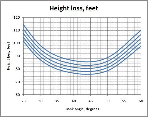

Dafydd Llewellyn Posted June 7, 2014 Share Posted June 7, 2014 Is competence then, well educated or well practiced, or both? It seems that we sure get a lot of education thrown our way. Both. I see this issue as being fundamentally one of inadequate training. It comes down to this: 1. Either you have sufficient height to perform the turn-back manoeuvre at the point of engine failure, or you do not. 2. If you do not, then DO NOT TURN BACK. 3. To know that you have sufficient height to turn back, you need three things: (a) A knowledge of the typical height loss YOUR AIRCRAFT will undergo in the turn-back manoeuvre AS FLOWN BY YOU. You should find this by performing the manoeuvre necessary to get you back to the point at which the engine stopped, heading in the opposite direction. Do this test at 5000 feet AGL, a number of times, average the resultant height loss, and multiply it by 1.5 or so. Add 100 feet for obstacle clearance. This becomes the "safety height" at which you must cross the upwind end of the runway, on climb out, in order to have sufficient height to turn back. (b) A means to readily verify that your height exceeded the "safety height" as you take-off - e.g. a mark on the altimeter glass. © Your climb gradient up to the point of engine failure, must exceed the best glide gradient for your aircraft. This will set a maximum density altitude beyond which the foregoing criteria will not be valid. The necessary information to determine that should be available in the flight manual; if it is not, you will have to determine it by test (something to do whilst you are flying-off the mandatory hours, on a -19 or experimental aircraft). If you change the propeller, this will need to be re-established. One could constitute the criterion in other ways; however it needs to be a black-or-white criterion, so the decision is already made for you as you cross the upwind end of the runway. 1 Link to comment Share on other sites More sharing options...

Dafydd Llewellyn Posted June 7, 2014 Share Posted June 7, 2014 Surely, the AGL criterion needs to be varied according to terrain? For instance, if taking off from Mittagong (YMIG) on 24 with a bit of headwind, you could get to 600 AGL fairly quickly- and before the curl-over from the hill south of the 24 runway, but the turn back would have you end up in the downwash, dumping you on the ground rather sooner than a simple climb gradient/glide gradient calculation would indicate? There are a number of factors that would bear on a simple criterion; however, since it's based on a still-air condition, if you're taking off into a headwind, your upwind climb gradient will be increased and your downwind glide will take you further, so to a degree, the downwash due to the headwind coming over the ridge would be compensated for by the advantage due to the direct wind velocity. The further upwind you get before the engine quits, the greater the effects from both causes, so it all balances out, to a degree. I've outlined the basic principle; the refinements to it will surely become obvious as people start to apply it. 1 Link to comment Share on other sites More sharing options...
