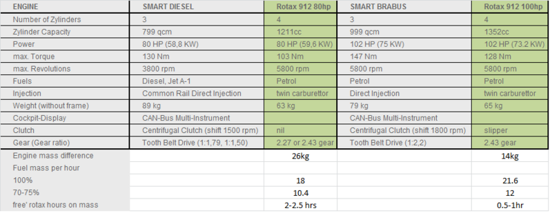

kasper Posted April 21, 2015 Share Posted April 21, 2015 Well auto conversion with redrive nearly always comes at a weight penalty to an equivalent aircraft specific engine. Look at the SMART engines converted to aircraft use by FlyEco - one a turbo diesel and the other turbo petrol - handy that they are 80 and 100hp as they compare to rotax 912 nicely. In both cases the engine mass on an 'equivalent' basis is greater in the auto conversion ... and looking at the fuel burn of the rotax the rotax gets hours of fuel for the same installed weight of the auto-converion engine. Short of the auto-conversion engine being cheap as chips (they are not) the sums do not add up. So going diesel at 80hp is more about the availability of jetA and the diesel injection and all the nice automotive stuff rather than the installed mass ... 80hp diesel ecofly is actually more weight that the 3300 jab and is close in weight to the continental O200 So basically the weight on this 80hp diesel does not kick in as fuel mass saving due to lower burn until the 6th hour of flying starts ... not a lot of microlights run this long in a single leg and even training organisations. 1 Link to comment Share on other sites More sharing options...

bexrbetter Posted April 21, 2015 Share Posted April 21, 2015 It has an aluminium block I remind you that 1kg of aluminium weighs exactly the same as 1kg of cast iron. No one knows the weight of the Honda diesels. The 2.0 Subaru flat 4 diesel weighs 170kgs and that is a lot more than many cast iron block 4 cylinder engines I can name. According to Honda the diesel has 58% of the economy of the petrol. So some weight could be gained on fuel load. So maybe they weigh the same at liftoff, but when you land with low fuel, the diesel is still heavier. Then there's the torsional vibrations. I'm not against diesels but if they made sense people would be using them. Link to comment Share on other sites More sharing options...

bexrbetter Posted April 21, 2015 Share Posted April 21, 2015 cessna 172 diesel is becoming more popular bex, these are based off the MB 2.0 engine I know them well. So you reckon 150kgs and $100,000 (installed) cost is ok? A viable aircraft diesel might actually be a 2 stroke./ I'm hearing some good things about the WAM, not sure of the cost etc though. Still 130kgs it's getting a bit much for our typical sized craft. Link to comment Share on other sites More sharing options...
