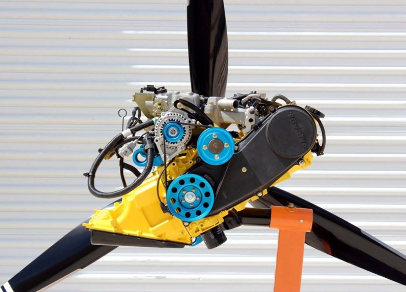

Marty_d Posted April 24, 2015 Share Posted April 24, 2015 Oh that's good news for the light aircraft industry, a few more take this up and modern engine conversions may really start to gain ground.Looks like a Suzuki Swift M series engine btw. Bahahaha, good one, now what's the real price? No idea, they haven't told me. The Suzuki motor is produced by "aeromomentum" (aeromomentum.com) - interesting slanted mounting position - According to their table it's only 4 pounds (under 2kg) heavier than a Jab 3300, fully water cooled and fuel injected. I'd be interested to hear reports of it in use. Link to comment Share on other sites More sharing options...
dazza 38 Posted April 24, 2015 Share Posted April 24, 2015 No idea, they haven't told me.The Suzuki motor is produced by "aeromomentum" (aeromomentum.com) - interesting slanted mounting position - [ATTACH=full]35274[/ATTACH] According to their table it's only 4 pounds (under 2kg) heavier than a Jab 3300, fully water cooled and fuel injected. I'd be interested to hear reports of it in use. Yup that is the same engine Aero are selling with their Aventura sea plane. Link to comment Share on other sites More sharing options...
bexrbetter Posted April 24, 2015 Share Posted April 24, 2015 The Suzuki motor is produced by "aeromomentum" (aeromomentum.com) - interesting slanted mounting position - . That's a stock Chinese mini van usage Suzuki sump setup, very common over here. http://www.alibaba.com/product-detail/High-Quality-G13-engine-long-block_1801830573.html I don't understand the "1500" part though, maybe just their model name rather than the G16B 1600cc Suzy that it is (for 117hp quoted it would need to be the 1600, not the 1300 or 1500). I think the 117hp is optimistic too, none ever the less, a true 100+hp would be available and bulletproof. Setup for them by Raven I presume who have more experience at setting up Suzuki's than most put together ... http://www.raven-rotor.com/ Link to comment Share on other sites More sharing options...

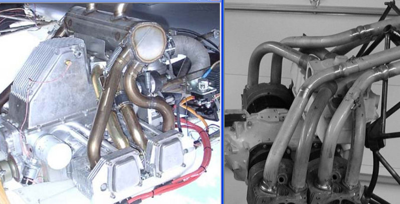

bexrbetter Posted April 24, 2015 Share Posted April 24, 2015 While I'm rambling away today as I got a seriously stiff neck today (viagra got stuck in my throat) so not doing much, I offer this; When you look at a Jabiru engine, note the underside is nearly always a 'dog's breakfast', and creating restrictions for the airflow to be able to be negotiated with ease, I give you this Jab Vs Lyc comparison to consider for yourself. 1 Link to comment Share on other sites More sharing options...
Marty_d Posted April 24, 2015 Share Posted April 24, 2015 Does the Lyc setup usually go 4 into 1? Do they usually have mufflers or is it straight through? Link to comment Share on other sites More sharing options...
bexrbetter Posted April 24, 2015 Share Posted April 24, 2015 Does the Lyc setup usually go 4 into 1? Do they usually have mufflers or is it straight through? Scott. Scott me buggered, doesn't change the Jab's somewhat restrictive setup though. 1 Link to comment Share on other sites More sharing options...
