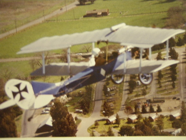

Guest Maj Millard Posted June 29, 2012 Share Posted June 29, 2012 'Scratch-built' is generally a term used when a person designs (from scratch) a completely new aircraft, and proceeds to build a prototype. The term may have come from the habit back in the 20s and 30s, of designers (particulary in the US) drawing aircraft profile on hangar floors with chalk, and then building from those profiles, as opposed to actually producing drawn plans. The methods of construction that you are proposing to use would be generally termed 'plans-built, or 'kit-built' as in the case with the Pietenpol or Zenith/ Savannah etc.The current state of the computerized factory-produced, complete kits, (Savannah in particular) is at a very advanced level indeed, and allows even first-time builders to produce a very good, and consistant product, in a relativly short period of time. A first attempt at designing and 'scratch-building' an aircraft would generally take on average at least a couple of years, and may account for many more than that !!..Time better spent flying in my opinion, unless your very, very driven with the idea. The 'scratch-built' original biplane in the attached photo took me at least four years to design and build, and another year to actually get into the air. There is of course no finer feeling of success or achievement, when you do finally fly something like this........................................................................ Maj... Link to comment Share on other sites More sharing options...
