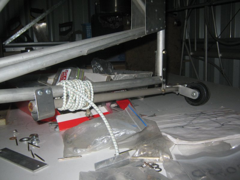

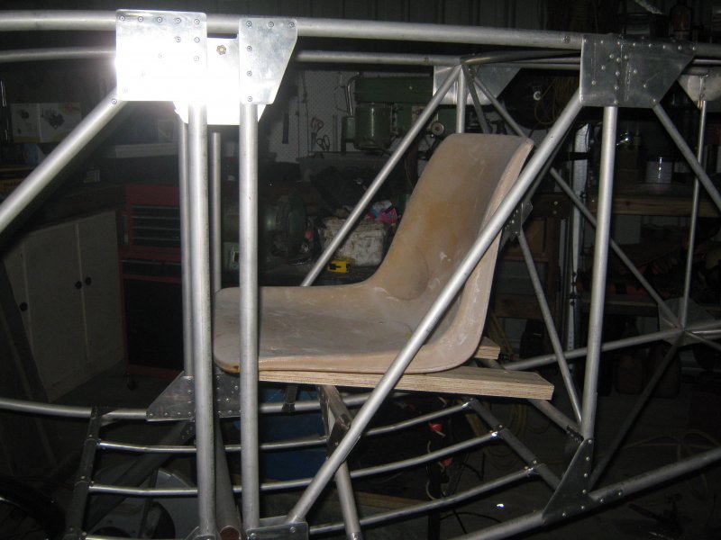

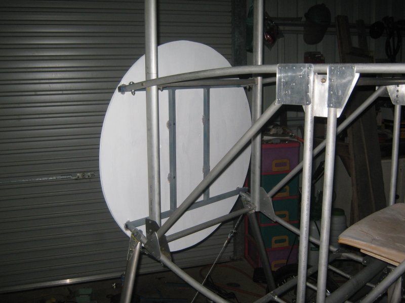

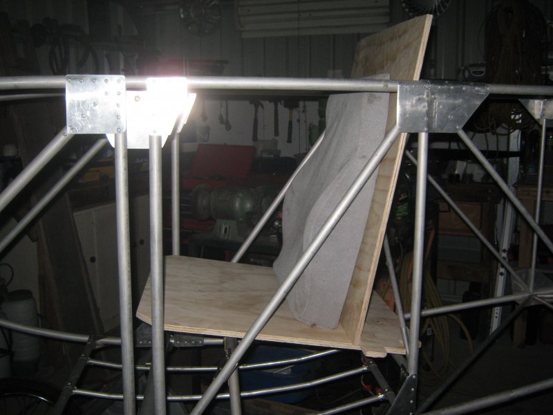

Pilot Pete Posted August 27, 2012 Author Posted August 27, 2012 A couple of picies of the firewall, tailwheel, and the seat, which i will be removing and replacing with a ply base and back. The plastic one flexes too much for my liking. 1
Pilot Pete Posted August 29, 2012 Author Posted August 29, 2012 New seat in ply with a contoured foam backing. Solid. Will be good with a piece of foam on the seat. If im smart enough I shoud be able to use the excess hieght as a bulkhead
Piet Fil Posted August 30, 2012 Posted August 30, 2012 i thought you could have contoured the top of the seat back to fit neatly under the front hoop for the turtledeck. A nice close fit and it would look dead sexy! Phil
Pilot Pete Posted August 30, 2012 Author Posted August 30, 2012 This is the Pete Austin designed Nieuport where all surfaces are flat, no curves. Just wait till I do the front deck. It should look like a toolbox with wings when I'm finished. 1

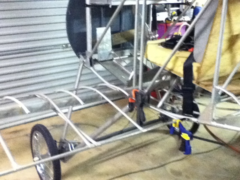

Pilot Pete Posted October 11, 2012 Author Posted October 11, 2012 The rudder peddles were part of the package I bought off Andy. I think it is a Robert Baslee set up as it also had the control stick, aileron linkages, pushrods and push/pull tubes for the elevators.I just need to chase up some aileron belcranks for the top wing. 1

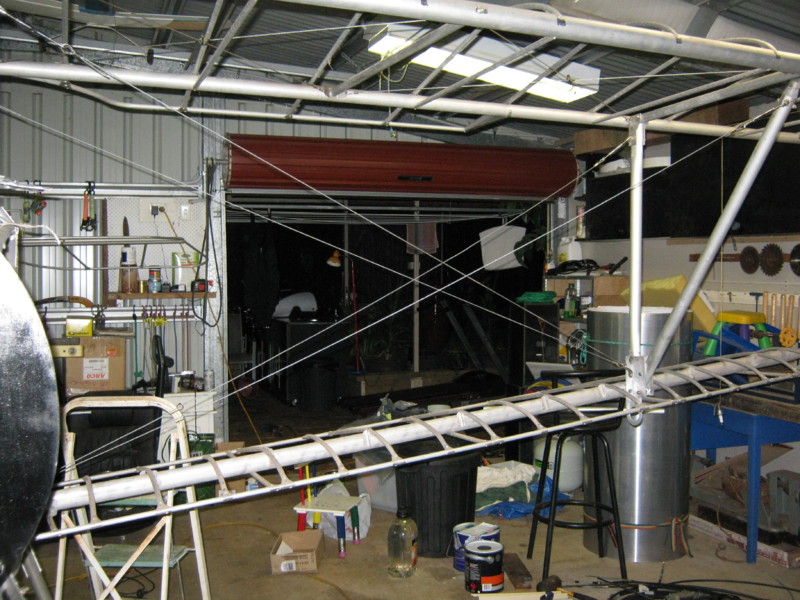

Pilot Pete Posted February 2, 2013 Author Posted February 2, 2013 Ok...........Top wing joined and sitting on cabane struts. Why is it that even when you measure, calculate. and then cut the parts when you go to set it all up it still doesnt go right ? Everything was set upto have a 2deg incedence but I still need to cut more out of the rear cabanes to get it lower. Not happy with the rear wing mount either so I will make another. No worries......just a few more hours on to the build time. 2

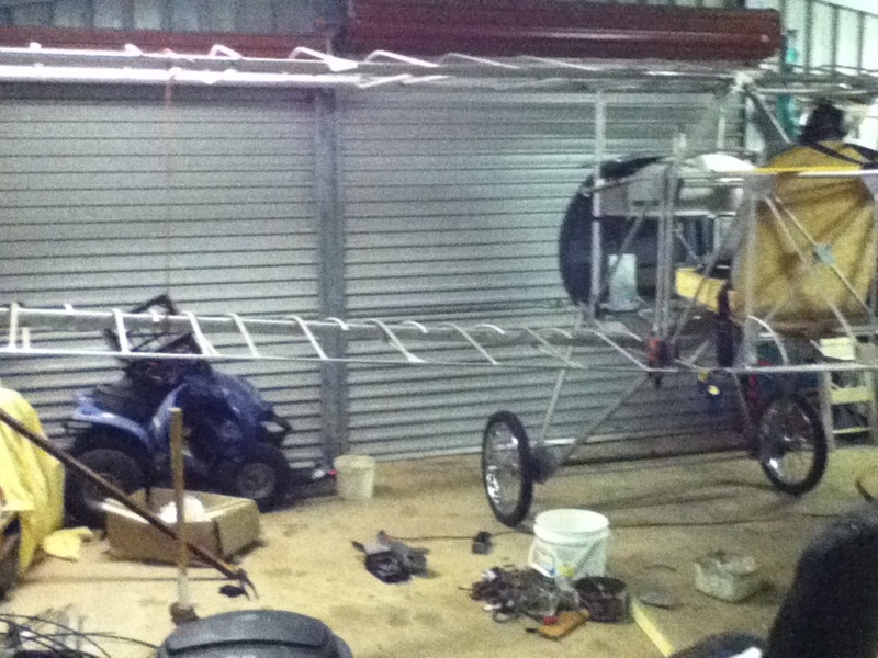

Pilot Pete Posted April 5, 2013 Author Posted April 5, 2013 Wing struts and lift cables in place on the left side. 2
Piet Fil Posted April 6, 2013 Posted April 6, 2013 Pete, Its starting to look exceptionally plane like, she's coming along nicely Phil
