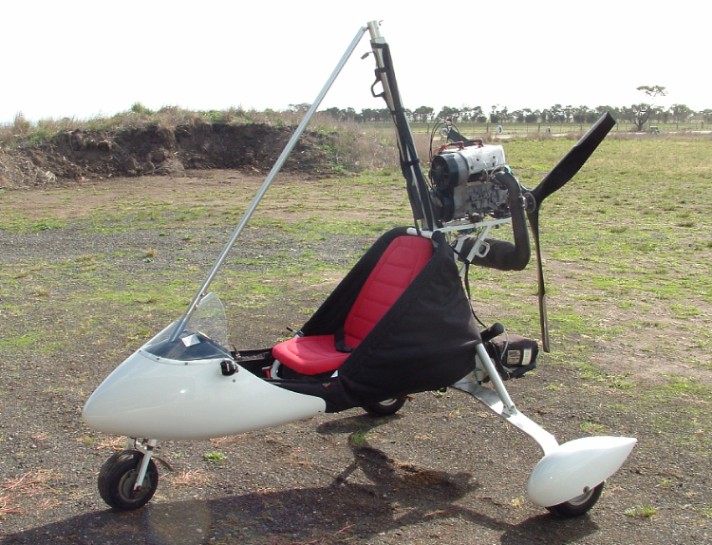

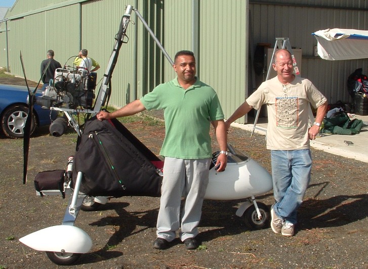

drifter_driver Posted May 7, 2007 Posted May 7, 2007 The good stuff I just driven back to Sydney today from Melbourne having picked up my single seat trike called Pursuit 10. This trike was built by Peter wood using Aerialpursuits plans (Original design based on Chaser-S trike in UK) Peter`s workmanship is second to none as can be seen from the build quality/finish of the trike. I am bit tired now having driven all day so will just post some photos. In photo one Peter and I are standing next to trike frame and the flying photo is from peter`s collection. Will post more info on the trike in next couple of days. The bad stuff I don’t know how to fly a trike as yet (hopefully not for long- and no I am not using the manual called how to teach yourself to fly a high performance single seat trike)
Ultralights Posted May 7, 2007 Posted May 7, 2007 now that looks like fun! just 1 question though, where does the fuel go?
drifter_driver Posted May 7, 2007 Author Posted May 7, 2007 the fuel tank is integreted in the pilot seat. it holds 42 lts fuel.

drifter_driver Posted May 21, 2007 Author Posted May 21, 2007 From Darrens photos it looks like I was having fun but I really did have a tough time trying to control the trike base on the ground. The greatest problem was reverse inputs on foot pedals. Also when trying to apply breaks (on left peddle), couple of times the nose wheel turned to right and in trying to rectify this the throttle kicked up (by right foot –which controls left turn and throttle) any inputs / views from fellow trikers in ground handling would be highly appreciated. Original Chaser S trike (Pursuit 10 is pretty much identical) was known to be bit tricky in ground handling . Following description of Chaser S is from a UK microlight website. Originally manufactured by Cyclone Airsports, the Chaser S is a very attractive single seat microlight which features a noticeably small wing and which lends itself extremely well to competition flying. Cyclone Airsports and Solar Wings later merged to become Pegasus Aviation and subsequently the Chaser became the Pegasus Chaser and was marketed as a high performance single seat microlight favoured by the competition pilot. The small nature of the trike can make getting in and out a somewhat more difficult task than most 2-seaters yet the Chaser will accommodate tall pilots with a little practice and perfection in entry and exit technique. It has often been said that you don't sit in a Chaser - you wear it. The seating position is quite reclined and is actually very comfy. The control-bar position is quite different to most dual seaters yet its feel compliments the rest of the aircraft perfectly in the air if a little tricky on the ground handling. The Chaser is known for it's tricky ground handling characteristics but this is not a problem for the experienced pilot. The Chaser is commonly seen with the Rotax 447 engine but is also available with a 377 two stroke or the Rotax 503 engine. General Information : Type: Weightshift Seats: 1 Introduced: Unconfirmed No. Produced: Unconfirmed Price when launched: Unconfirmed
Guest Crezzi Posted May 21, 2007 Posted May 21, 2007 I intend no offence but I think the key part of your quotation could have been but this is not a problem for the experienced pilot. Believe me - any 3-axis pilot is going to struggle with the ground handling of a trike at first & its good to see you doing the best thing and practising it :-) I owned a Chaser for a couple of years (in the UK) and the comments you quoted are basically accurate. The caster angle of the front forks is rather less than on other trike models which makes the steering quite twitchy - its something you have to get used to . I'm lanky & 6 foot & it took me a little while to get used to the Chaser. One specific problem I had was difficulty bending my ankles up enough to not be unintentionally pressing on the pedals when steering. I was taxying with half throttle and dragging the brake. This was solved by making new pedals bent back a few degrees so in the non-applied position they were further away from my feet. Hope that helps John
