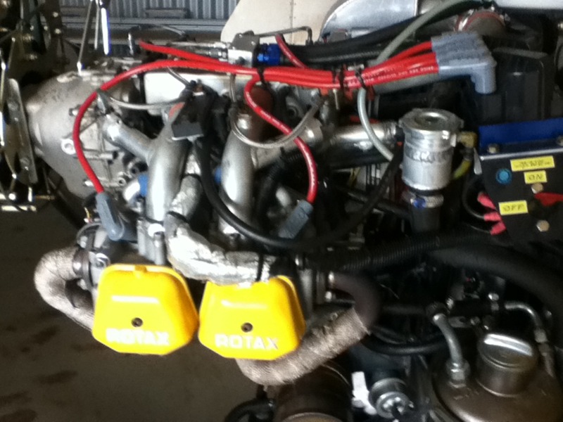

wannafly Posted January 17, 2014 Posted January 17, 2014 I was looking at a youtube clip that Hongie posted on the "what are your favourite youtube clips" thread. The highlander was a very impressive performer. I read the comments and, after someone asked the Highlander owner what made his engine so powerful, he wrote this comment:"It's a 912S (100hp) with the compression lowered to 9-1 and then turboed exactly like the 914. It's about 150cc bigger than a regular 914 and it makes something around 140 hp. A 914 makes 115 hp." I know that the Rotax 914 is really a turbo-charged 80 hp motor. However it had never occurred to me that the 100 hp (912S) motor could have the same turbo gear fitted to this to increase the performance to 140 hp ...once the compression has been lowered somewhat. This probably means that you don't need premium unleaded to run either. Does anyone know others that have done this (possibly in Australia). I for one would like to know the expected engine life of this arrangement. I would also be very interested to know if anybody else has done this particular conversion??
wannafly Posted January 17, 2014 Posted January 17, 2014 Well ok i import a brand of aircraft(that im not allowed to mention cause its in breach of rules) that has a 80 hp rotax that has turbo that produces 135hp of course this is for only a couple of minutes, but it is about 110 hp 100%, and the only real difference between it and the 914 is no computer crap, it is absolutely great performance and good fuel econ. i have one machine in Oz that has about 800hr mustering time and still going strong, the simplisity is so well simple it beg to wonder why rotax did the crap they did with the 914.I will have another brand new machine in town this coming week end so they are definately popular. Sounds great, could you please tell me more info on this motor eg: what sort of turbo are they running, who did the conversion and an approx cost.Thanks
Kyle Communications Posted January 18, 2014 Posted January 18, 2014 Reg Brost has a "Predator" motor in his Savannah.. It is a modified 914 I believe. Not sure on how much HP but more than 115 for sure. The guy used to make the engines for the predator drones…he doesn't sell them anymore..I don't know why

rankamateur Posted January 18, 2014 Posted January 18, 2014 Reg Brost has a "Predator" motor in his Savannah.. It is a modified 914 I believe. Not sure on how much HP but more than 115 for sure. The guy used to make the engines for the predator drones…he doesn't sell them anymore..I don't know why Jason Parker was building Rotax extreme engines in America from ex-drone 914 engines an adding fuel injection. US military changed their policy and all drone engines now get scrapped instead of sold off as surplus, so the supply dried up. He was quoting 140 Hp but he made lots of claims.
