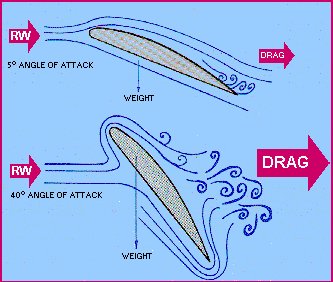

eightyknots Posted July 14, 2012 Posted July 14, 2012 :yikes:That Zenith pilot would have to be careful to avoid this also: 1
Ballpoint 246niner Posted July 14, 2012 Posted July 14, 2012 Good STOL always respects the Attitude/Power envelope. You can only use one without the other for so long, play on one end of the see-saw at your peril, as any two year old knows, swing off one end of the see-saw and you will hit the ground, and get a sore butt! Best angle climb, like credit card debt, is not sustainable -borrow but you eventually have to pay it back.... Just some STOL philosophy for those who care. 3

Guest nunans Posted July 15, 2012 Posted July 15, 2012 Best angle climb, like credit card debt, is not sustainable -borrow but you eventually have to pay it back.... Just some STOL philosophy for those who care. G'day, I'm someone who cares and is interested but I don't understand yet. Best angle climb, if that's the climb at speed Vx, why is it not sustainable? I think a plane can climb steeper than the best angle climb where it uses some inertia from fast level flight or a dive then pulls up very steeply and as the speed washes off levels out before reaching the stall speed or goes right over the top I guess,
Guest nunans Posted July 15, 2012 Posted July 15, 2012 Best angle climb, like credit card debt, is not sustainable -borrow but you eventually have to pay it back.... Just some STOL philosophy for those who care. Why isn't best angle climb sustainable? or are you talking about climbing steep enough so that the plane can't maintain airspeed.
Ballpoint 246niner Posted July 15, 2012 Posted July 15, 2012 Best angle will give max height for a given distance, perfect for clearing obstacles etc but while lift is greater- so is drag so we now have a situation where thrust is losing the battle over drag therefore airspeed is now declining. Starting to make sense?, get your CFI to explain with pics, if necessary of lift/ drag curves and where the polar curves intersect.

djpacro Posted July 15, 2012 Posted July 15, 2012 best angle of climb is a steady state condition therefore sustainable (until the ceiling is reached) but in many airplanes not a good place to be at low altitude with engine problems 1
