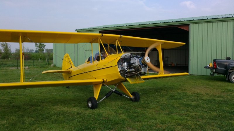

Gentreau Posted May 4, 2013 Posted May 4, 2013 One thing that is sure about D-Motor is the excellent level of service they give. A guy at our club bought one of the early 4 cylinder engines, which produced 80hp. It ran beautifully and he really liked it. It started first time every time using an 800g battery and he had about 50 hours trouble free flying with it. However, that orignal design has now been superseded by the improved LF26. Two days ago a guy from D-Motor drove down from Belgium (8 hours) with a replacement engine which he helped our guy install as a replacement on his Sherwood Ranger. The engine tests were completed yesterday and he now has the new version (93hp). What did that cost our guy; nada, nothing, not a cent ! 4 2

turboplanner Posted May 14, 2013 Posted May 14, 2013 One thing that is sure about D-Motor is the excellent level of service they give.A guy at our club bought one of the early 4 cylinder engines, which produced 80hp. It ran beautifully and he really liked it. It started first time every time using an 800g battery and he had about 50 hours trouble free flying with it. However, that orignal design has now been superseded by the improved LF26. Two days ago a guy from D-Motor drove down from Belgium (8 hours) with a replacement engine which he helped our guy install as a replacement on his Sherwood Ranger. The engine tests were completed yesterday and he now has the new version (93hp). What did that cost our guy; nada, nothing, not a cent ! So, even though the existing engine was fine, for no other reason than they wanted to, they gave him a new engine?
Gentreau Posted May 14, 2013 Posted May 14, 2013 So, even though the existing engine was fine, for no other reason than they wanted to, they gave him a new engine? I understand their reason was to have only one version of the engine out in the wild. See their Installations page here: http://www.d-motor.eu/nl/installations-5.htm . 1
turboplanner Posted May 14, 2013 Posted May 14, 2013 Ah, I see - that IS smart marketing - the customer is not saddled with any potential problems on the prototype, plus there are cost savings in not having to maintain a parts inventory for one engine. Great service as you say!
Gentreau Posted May 14, 2013 Posted May 14, 2013 I must say that having spoken to the guy from the company, they certainly seem to be very serious about 'doing it right'. Another example he gave me is that the ECU is fully programmable (I watched him setup the idle on the Sherwood Ranger using his PC plugged into the ECU) and you get the software with the engine to allow you to log data and monitor conditions. If later you have a problem and you contact their telephone support service, and they determine that it requires modifying the ECU, they will give you an access code which is valid for 24hrs only to allow you to make the necessary changes, following their guidance. .
