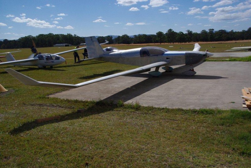

graham brown Posted August 17, 2013 Posted August 17, 2013 Went to Taree yesterday to load test the touring motor glider wing. ( ie Sit on it.) A good time was had by all and...... the wing did fine!! 1 1
dazza 38 Posted August 17, 2013 Posted August 17, 2013 As as ex aircraft technician , she looks strong, well above what is needed. Well done guys and that represents negative g

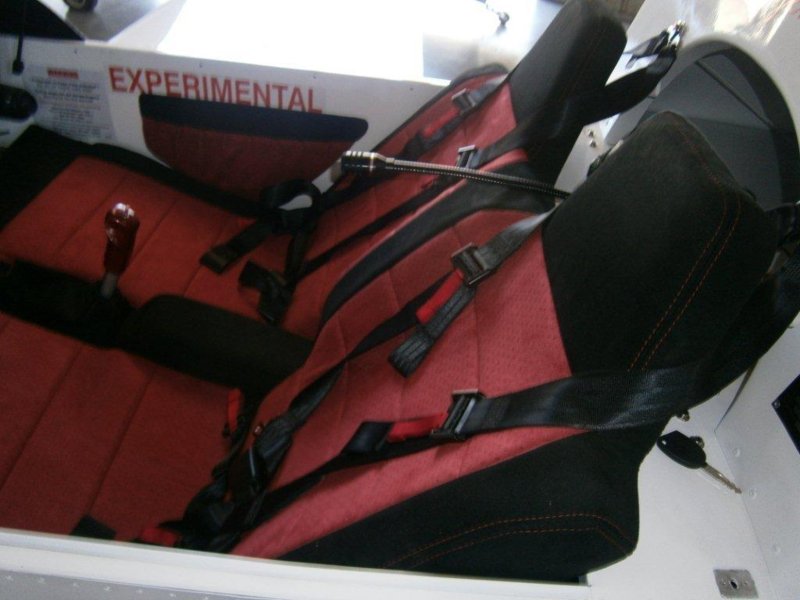

Guernsey Posted August 18, 2013 Posted August 18, 2013 Stone the crows!!! FOURTEEN passengers and no seat belts. . Well done Gary. PS Gary emailed me with some more photos taken on the day but I don't know how to post them from an email. Alan. 1

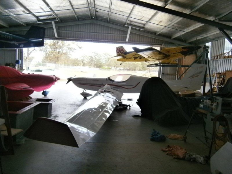

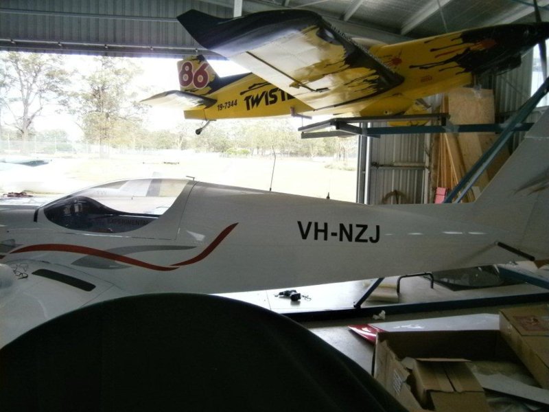

Garry Morgan Posted October 25, 2013 Posted October 25, 2013 Off to the paint shop next week, panel to be wired in ,and then ready for the paper work with GFA. 2

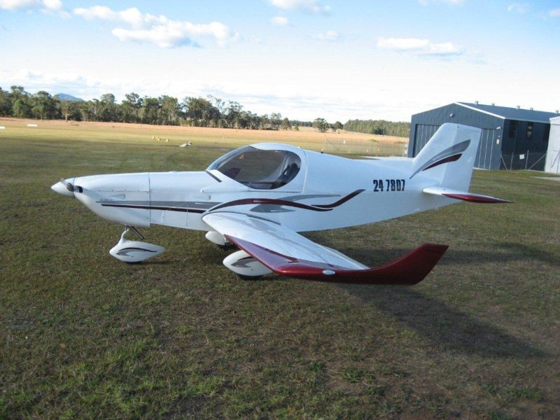

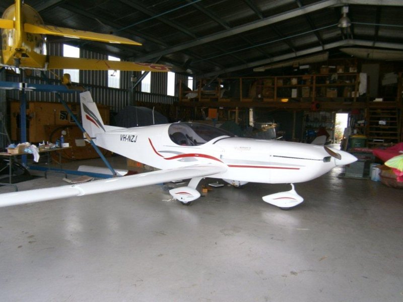

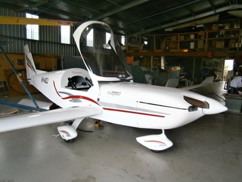

Guernsey Posted February 14, 2014 Posted February 14, 2014 Hi everyone, Had an email recently from Gary Morgan (He was in New Zealand) advising that the new Motor Glider will be at Natfly; he also sent the latest photos but I had forgotten how to put them on this forum from an email so I forwarded the email to Ian. Gary asked me to do it but Ian hasn't responded.??? Alan.
Blueadventures Posted February 14, 2014 Posted February 14, 2014 Alan Thanks for the update. I'm looking forward to seeing the photps of the finished aircraft. I actually called in and Gary showed me the motor glider and his stable. I was impressed with what aircraft he has designed and made and the time and information that he explained to me. He is a great knowledgable guy. The first flights will a pleasure after all his hard work. Cheers Mike

Guernsey Posted February 15, 2014 Posted February 15, 2014 Love the colour scheme....look familiar? Alan. 1
Guernsey Posted February 16, 2014 Posted February 16, 2014 Might be worth swapping the Sierra for the Motor Glider??? Alan.
