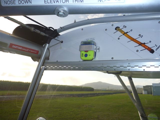

Fitted in a 42 minute after work fly this afternoon. Nice weather and a bit of burn off smoke around. Fitted the PLB birthday present (one less bit of safety kit to pack before long flights as I used to borrow the boats EPIRB) and put a little more colour on the cowls of the Nynja. Cheers Mike

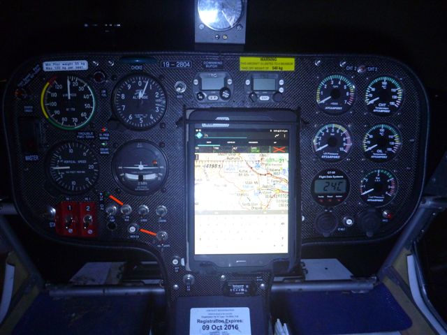

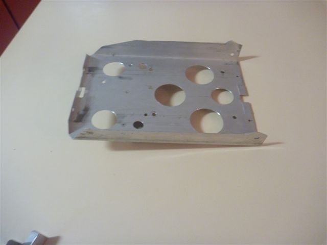

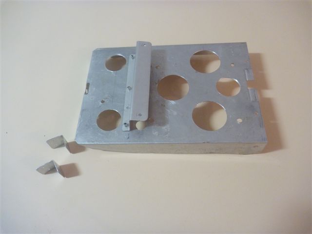

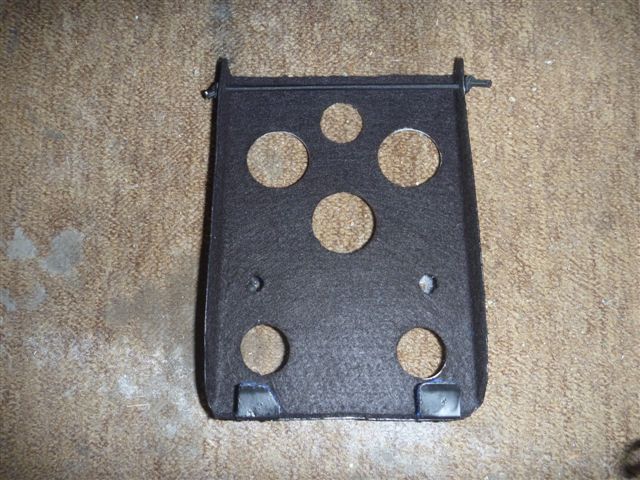

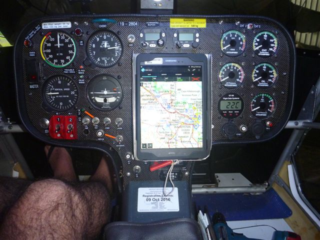

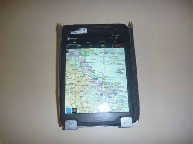

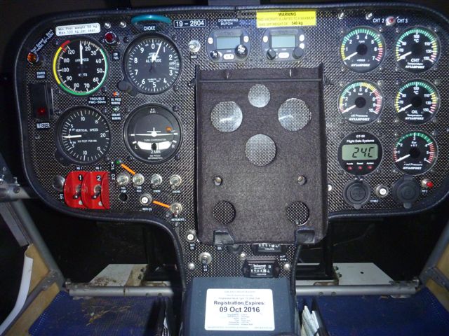

No flying this weekend as were at the 48 hour mark of continious rain. Can't complain as had a great Thursday, Friday, Sat and Sunday when got to fly 3 out of the four days. While its wet I have decided on the Samsung mini mounting and fabricated it today. I'll fit it to the panel tomorrow with four nut plates and screws so the mount iseasily removed if required. Attached is some images of it (yet to be painted matt black and have the retainers soft riveted.

Finished off the mini samsung mount, all trimming done; just need to paint and its ready to install and hold the tablet on future flights.
Finished off the mini samsung mount, all trimming done; just need to paint and its ready to install and hold the tablet on future flights.[ATTACH=full]44323[/ATTACH]
I love it! It fits well.

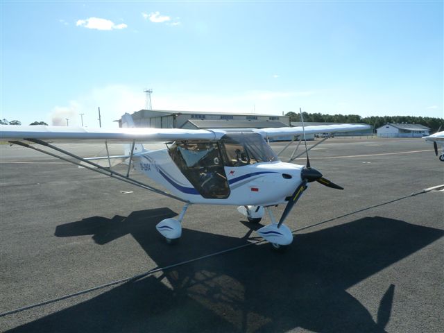

Flew the Nynja to Watts Bridge last weekend. Caught with Ken and his Nynja there. Time 4.7 hours down and stopped at Kingaroy on the way down and at Maryborough, Emu Park and a private airstrip on the way back. Very enjoyable in the Nynja. These are some of the sights.
Overnighted Emu Park
At Maryborough Qld

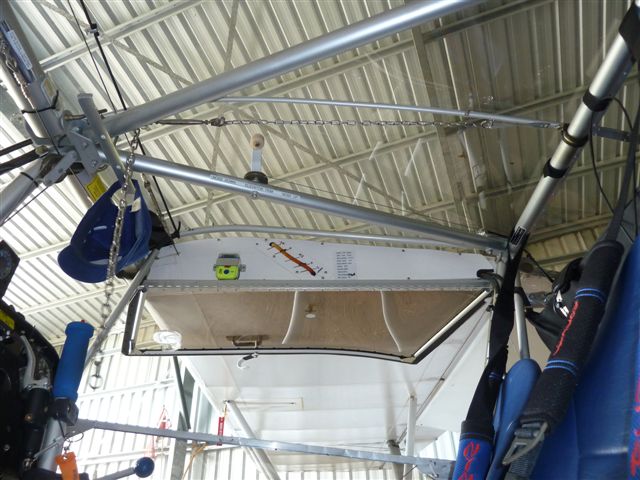

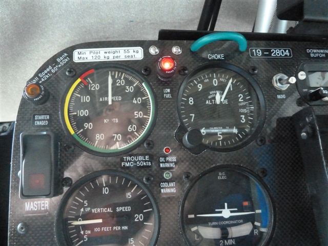

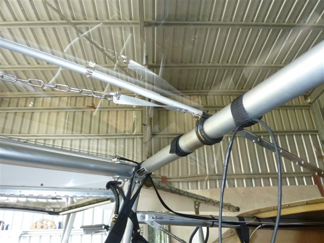

Yesterday and today I finished a couple of small jobs I had on my list of things I wanted to do. 1. was to get the low fuel light working and verify it worked, 2 was to put a little more tension on the center lexan tube and 3 was to do a check of the engines pneumatic carby balance; engine running smooth but always worth a check.
Got the low fuel light operational and drained some fuel to verify it was working correctly; then did a pneumatic carb balance with a syncromate unit (What a great piece of kit) only required a 1/3 of thread adjustment to what it was. And then put about 9mm move forward on the centre lexan support tube. (This had me beat as its a bit tight doing the adjustment; I had a few ideas in my head about how to redo it; then recently I had a thought and used a turnbuckle and some small chain. Worked a treat.)
So with all that done I whent for a fly this morning up the Lakeside Airoark and saw some friends who had been busy doing some fabric work on a Lightwing. Great flting weather and now have 88 hours on the Nynja. Can't wait for the next flight; very soon. Cheers Mike
