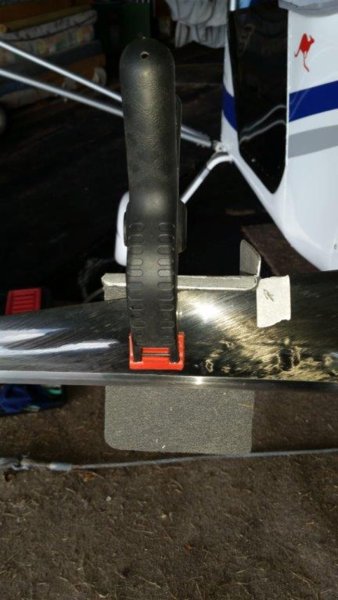

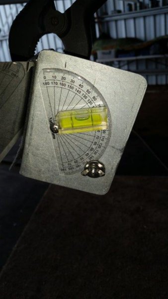

This weekend I was needing to adjust my prop on the Nynja's Rotax 912ULS2 aiming for between 5,500 and 5,600 rpm. I originally had it at WOT level flight 5,375 rpm then recently while doing the engines 100 hourly I re-pitched to 19 deg giving WOT 5,750 level flight - this was too fine now. To redo the pitch setting I needed a better tool so I made the following and it works great allowing easy placement and good judgement of the pitch angle degree. I happy with this 'mk1' version. Now at 20 degrees for the DUC propeller. Looking forward to a flight next weekend to see the results as getting ready to do some trips. Cheers

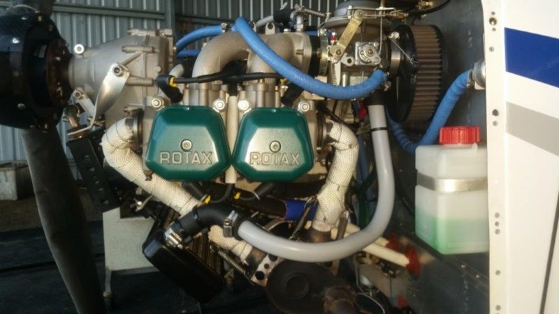

Finished the annual service and fitted the factory skyranger nynja coolant pipes that I purchased form UK for the 912. Also fitted exhaust heat protection for the hose connection areas. All going well will have a fly on Saturday. (The golden brown colour of the heat wrap in places is a different brand being used at that area.)
