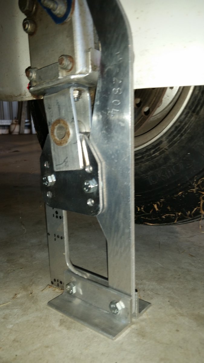

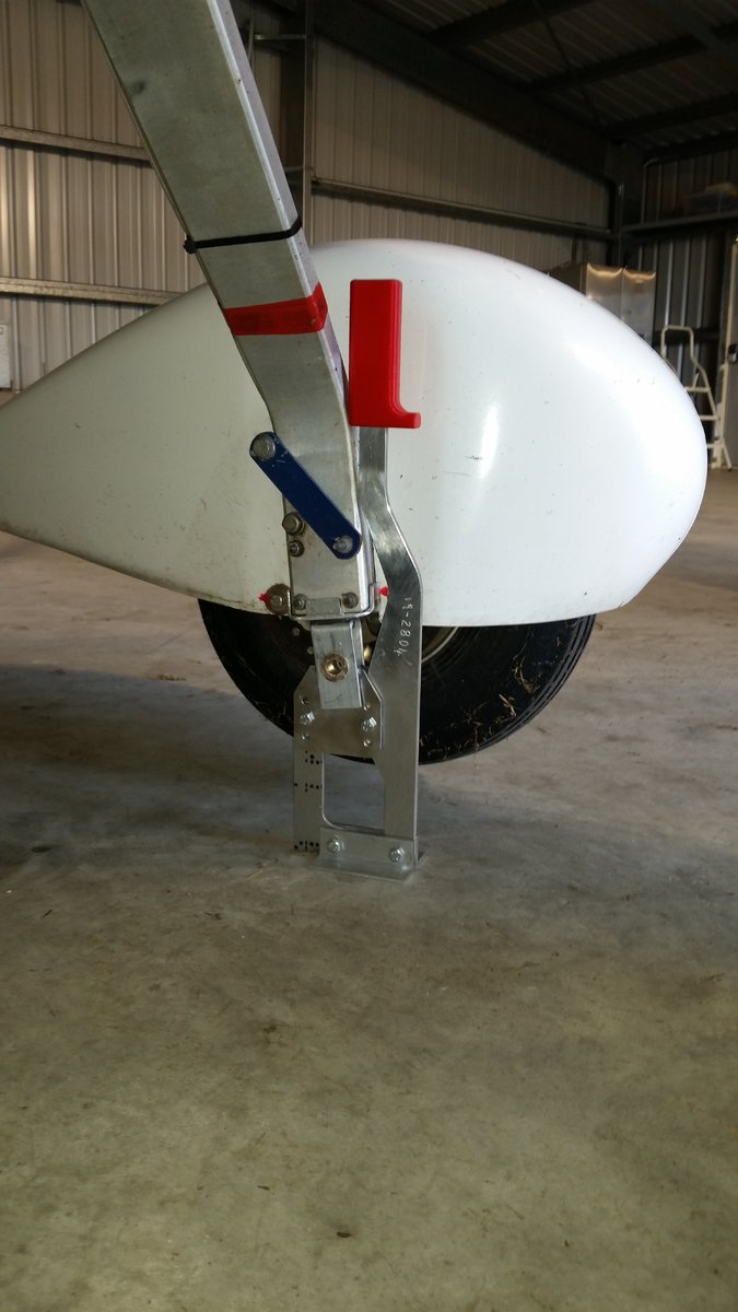

Tried out the wheel jack I bought from Peter Anson and fitted an attachment unit for location under the Nynja's undercarriage.  All worked a treat.  The jack is a nice light piece of engineering by Peter Anson.  The lift takes one arc movement and the lever is over centre retained in the raised position.  Cheers

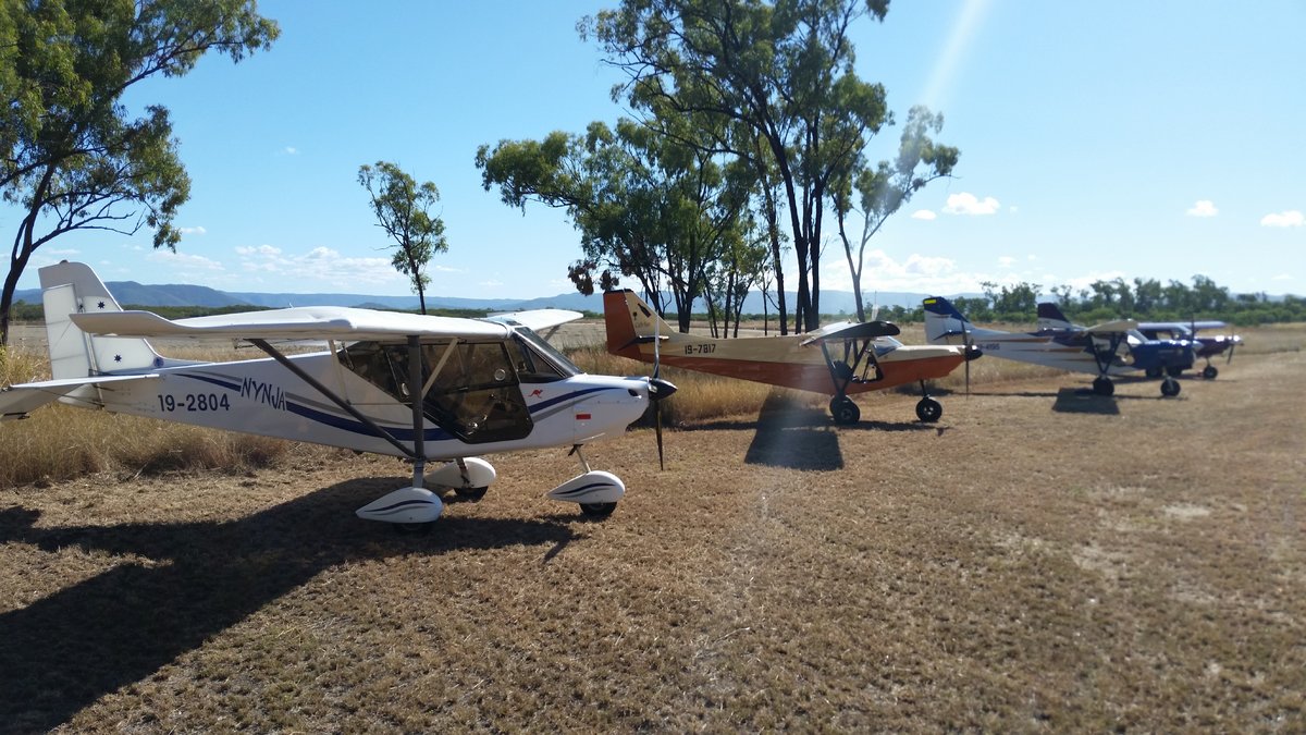

Had a nice 2 hours plus flight on Sunday to the south of Mackay and caught up with some flying friends, who were on their way back from Watts Bridge via a dew nice airstrips over a few days, for a cuppa.  The recent early morning rain before sunrise cleared the skies.  Now have 140 hours on the Nynja and looking forward to putting on some more over the next few weeks.

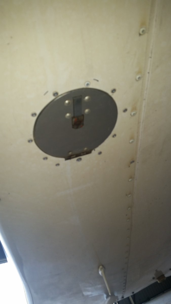

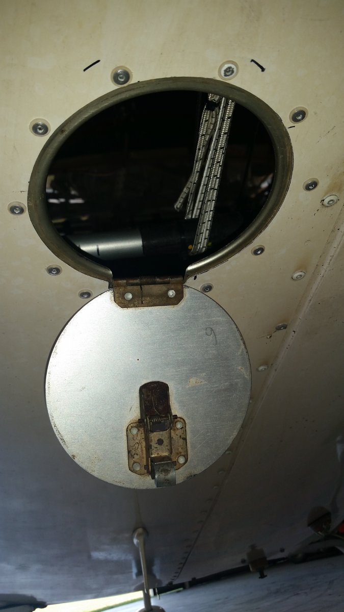

Rudder bungee. Just for info. I've recently been adjusting the Nynja's rudder trim. I should have adjusted it sooner. I needed to put light right rudder pressure to keep ball in centre. After two more flights today I now have the bungee at 46mm to port of my centre reference. Ball is now centred and flys hands off great. To get at the bungee I fitted an inspection hatch which I salvaged from an old damaged glider 'Blanik L13' wing I had a few years back. I had two of these hatches. I put one at the rear under fuse during the build, were the access hole is. The one I fitted this week under the bungee makes adjustment easy and quick. I put some yellow paint dots either side of the bungee position so I can see if its ever moves off position. Best regards Mike
I just love seeing those hatches on your Ninja Mike.   That really makes it perfect.   Do you have a hanger at Palmyra these days?  I gave up the full size flying and don't have any plans to get back in to it at least any time soon but would love to visit and have a look at your machine with my RC glider flying buddy Steve.  He's a pom and only flown in a jumbo to come to Australia.
Sounds good. let me know a time that suits.

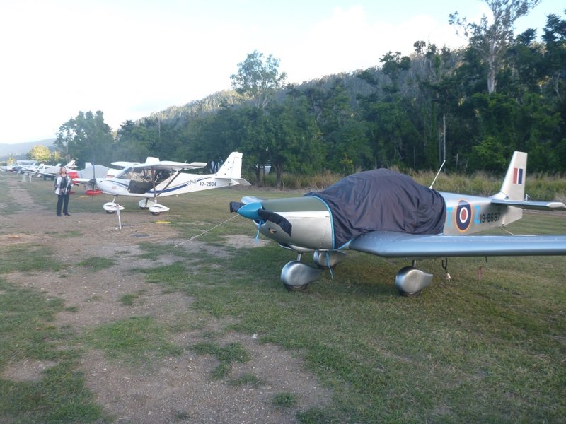

Finished the annual late last week and flew to the Whitsundays Saturday for the nice Runway Dinner they do.
At the annual I replaced the wing tank contents hose, lifted the nose wheel to allow dropping the nose wheel to give it a re-grease and fitted a throttle lock plus all the usual things that need doing. Then did a check fly on Thursday and loaded up for an overnight (Sat and Sun) to Shute Harbour airstrip for the Runway dinner they do. Being also my birthday it nice that they put on the occasion :) :) One of my presents was a propeller balance master from Daniel and I'll fit that in the next few weeks.

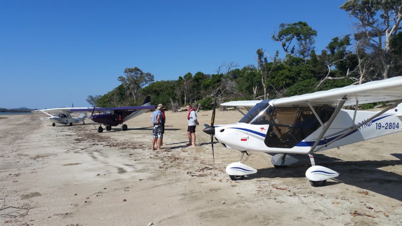

Had the first fly of the spring season today and went to the beach. A good thing with the sand is you can assess how you go keeping the front wheel up after the mains are on. Fitted a new brake master cylinder kit and the brakes are back to 100%. Also gave the outside a good wax and polish so looks shiny again; will try and keep it there now. Had a cuppa with Bill on the forum, so a great morning fly all in all. And a Searay called in for a quick G'day. Cheers.

Tried out the wheel jack I bought from Peter Anson and fitted an attachment unit for location under the Nynja's undercarriage. All worked a treat. The jack is a nice light piece of engineering by Peter Anson. The lift takes one arc movement and the lever is over centre retained in the raised position. Cheers[ATTACH]60769[/ATTACH]
[ATTACH]60770[/ATTACH]
The jacks look like the go, where can I get one of them mate?
