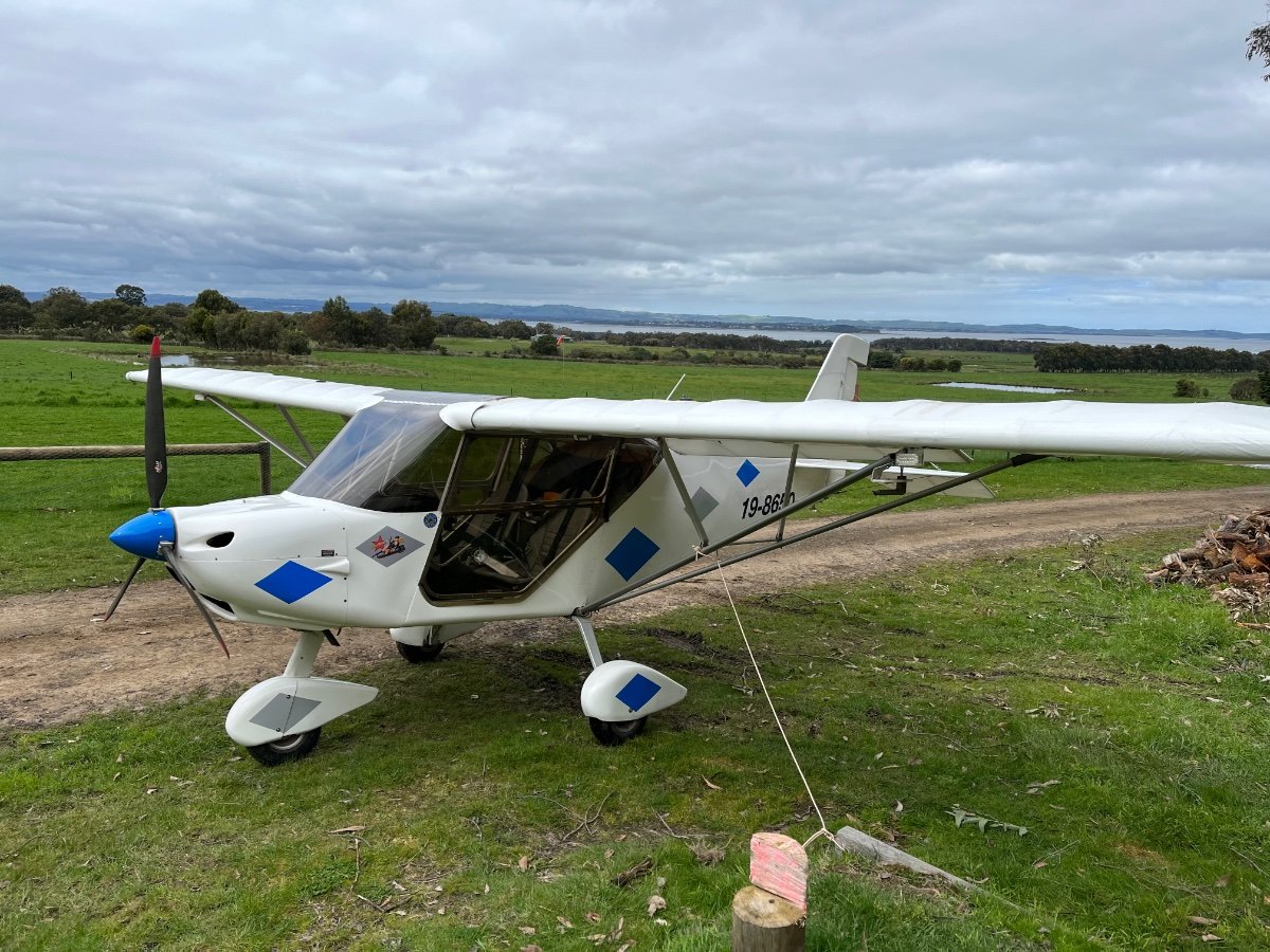

Mondays flight a section of a 1.5 hour fly to the north of the home airfield. Including a fly along a local creek at 500 feet in south westerly winds.
  • Like 3

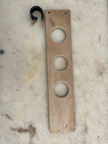

Starting on an armrest for between the seats.  Chris with the NT now SA based Nynja made a similar one so I'll try one out.  It will hinge up and be supported by a wire at the hight that's comfortable.  Using 10mm ply and two WDG14 pipe clamps.  Other image is what a guy in the UK did.
  • Like 4

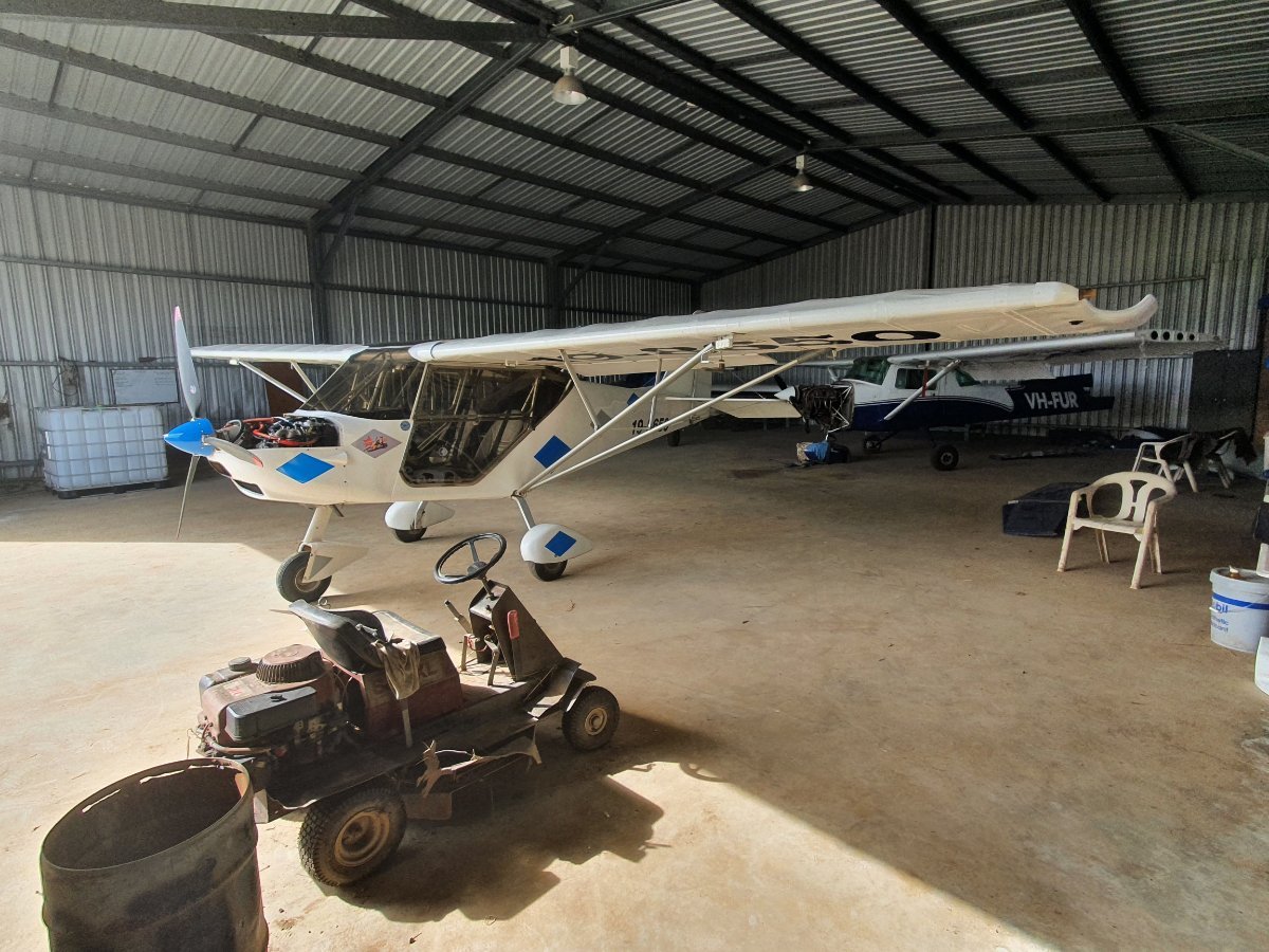

Thankful to John for bringing Guy down in that beautiful 4 seater tail wheel. Wish I’d gotten a pic. TD Used to live at Tyabb until John purchased 4 months back.
I managed a horrible landing at Dubbo. Guy did 2 circuits in the Nynja with me right seat and way better landings. 6:50am departure, stop at Tumut for fuel I didn’t need and wheels down at Dubbo 11:35am. 400nm averaged around 100-103kn gs.

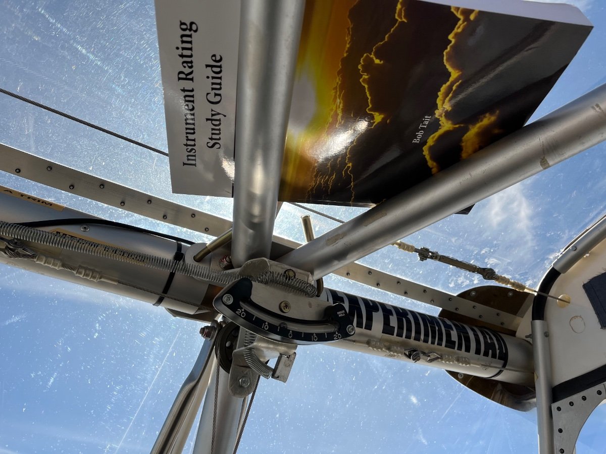

I finally worked out how to work that spring up top. You can lengthen or shorten it to get exactly the right wind correction for course. It’s just in front of Bob Tait wrapped around.

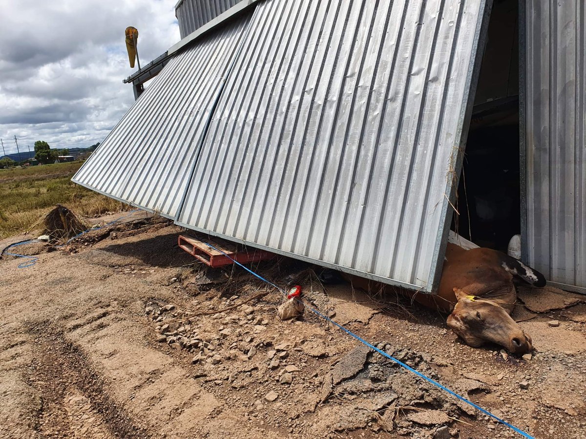

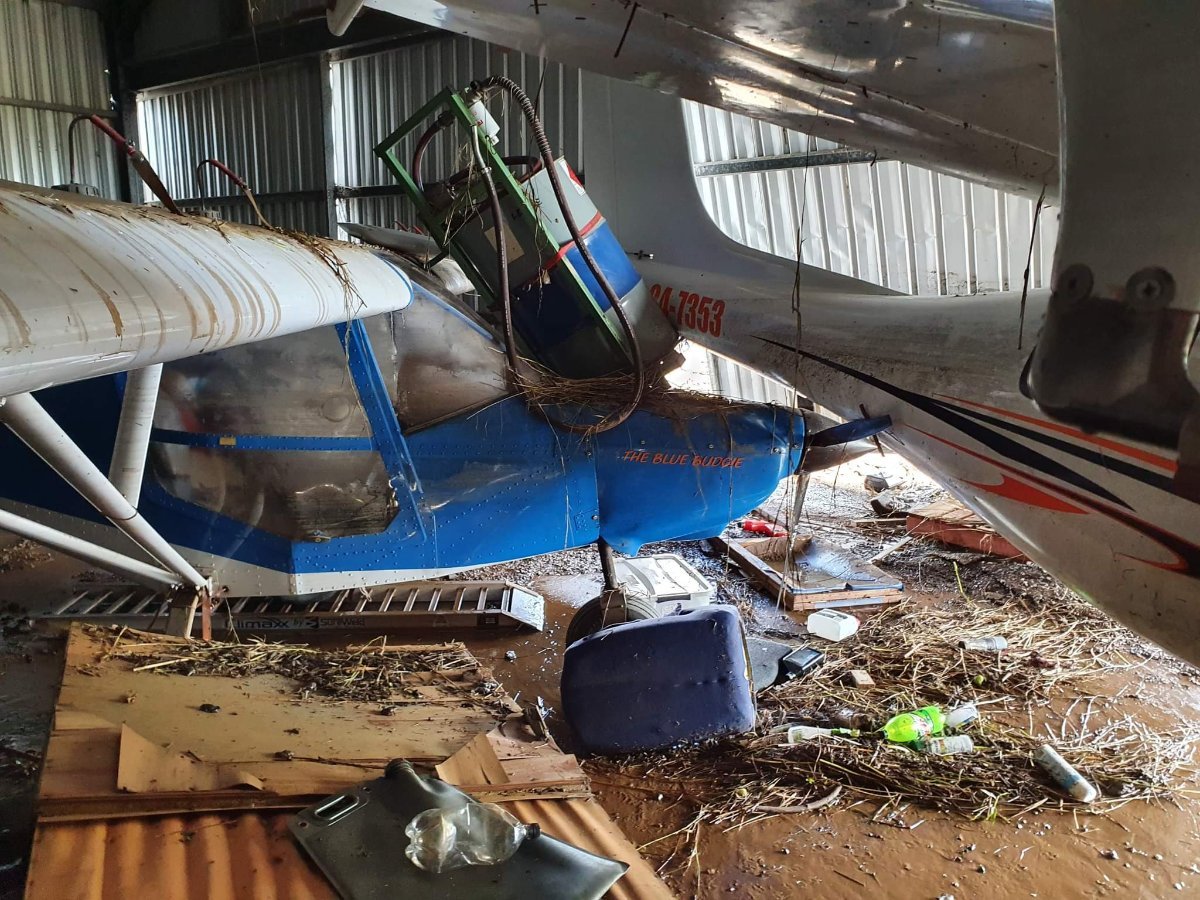

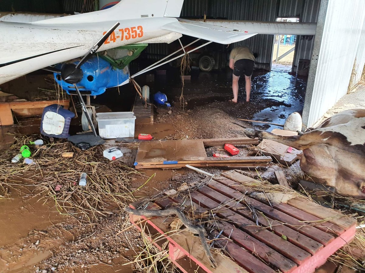

After losing the Blue budgie (Savannah S) to Lismore flood waters (Northern Nsw) and the bottom end of Qld late feb which was devastating on a huge scale.

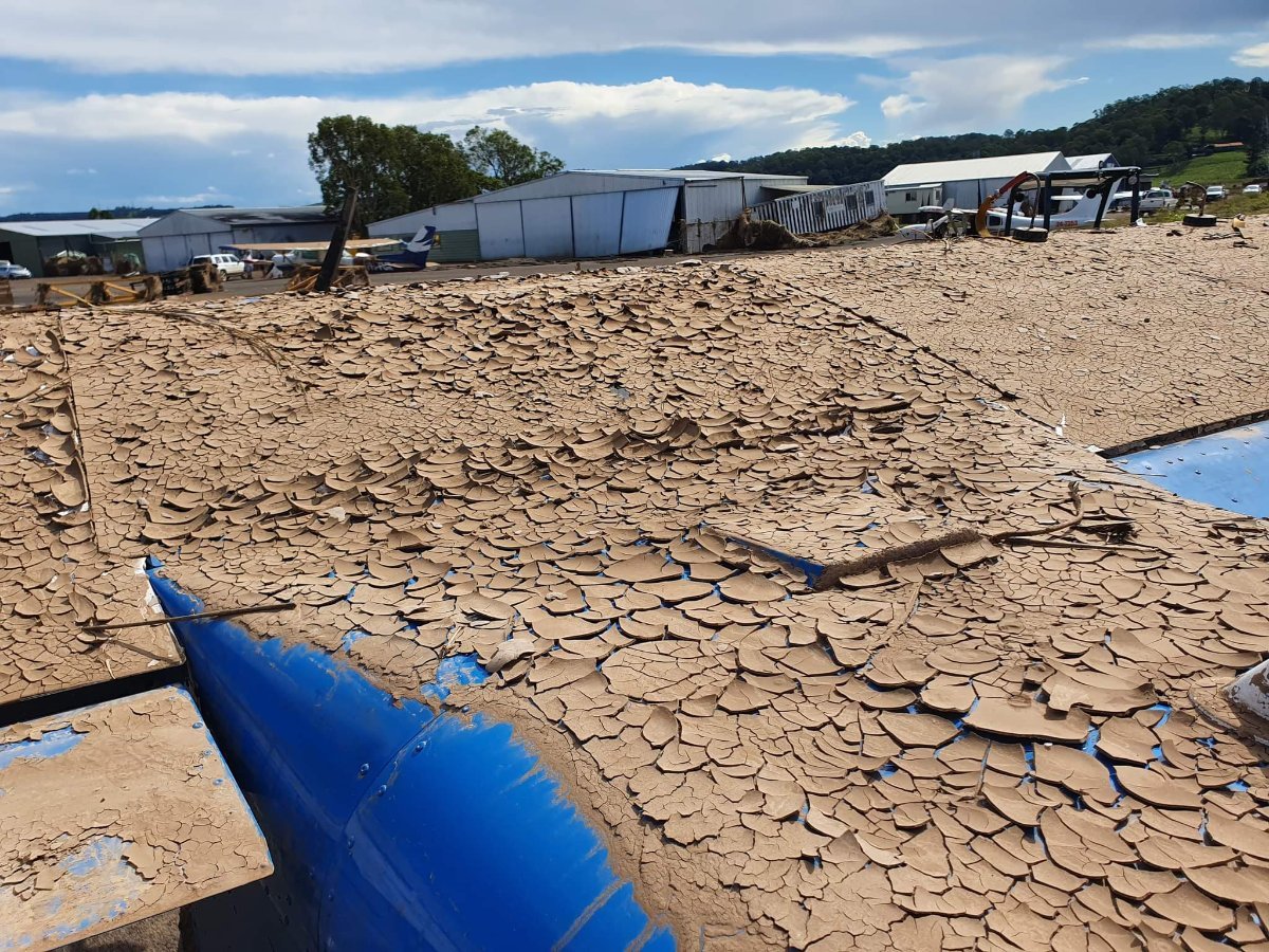

I've attached some photos of what I saw the first day I was able to get into the hanger and spent the day walking around bewildered and in shock.
I plan on rebuilding the Savannah,  which virtually had very little damage surprisingly, except for the leading wing edge. I'm going to de-laminate the whole leading edge so i can clean out the mud properly and put new skins on. I have all new gauges, wiring harness etc but I reckon it will take me a few yrs to do get her flying again.

That damage is very confronting. You guys have been through an awful lot.

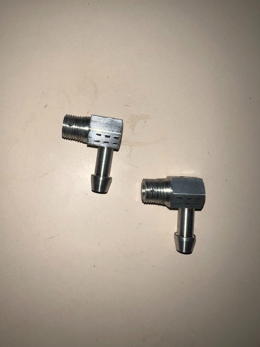

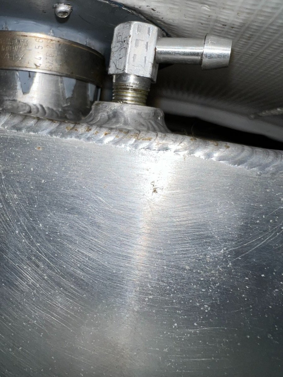

Received in the post two check valves for my wing tanks vent arrangement.  Made by Peter Anson Engineering and will stop the fuel flow out the vent pipes when taxing with full tanks.  I'll commence taxi on the tank that the return line is plumbed to.  Hopefully fit tomorrow or in near future.  They have a 3/16" ball inside that is positioned that it lets in the outside air and when fuel flows out of the tanks the ball seals.
$35 each and valve for money as specially made the Nynja wing tanks and vent setup.

Fitted the non-return fuel tank vent valves to the wing tanks today.  Fiddly job but all done now.  Used 577 locktite to seal.  Keen to try out with filled tanks.

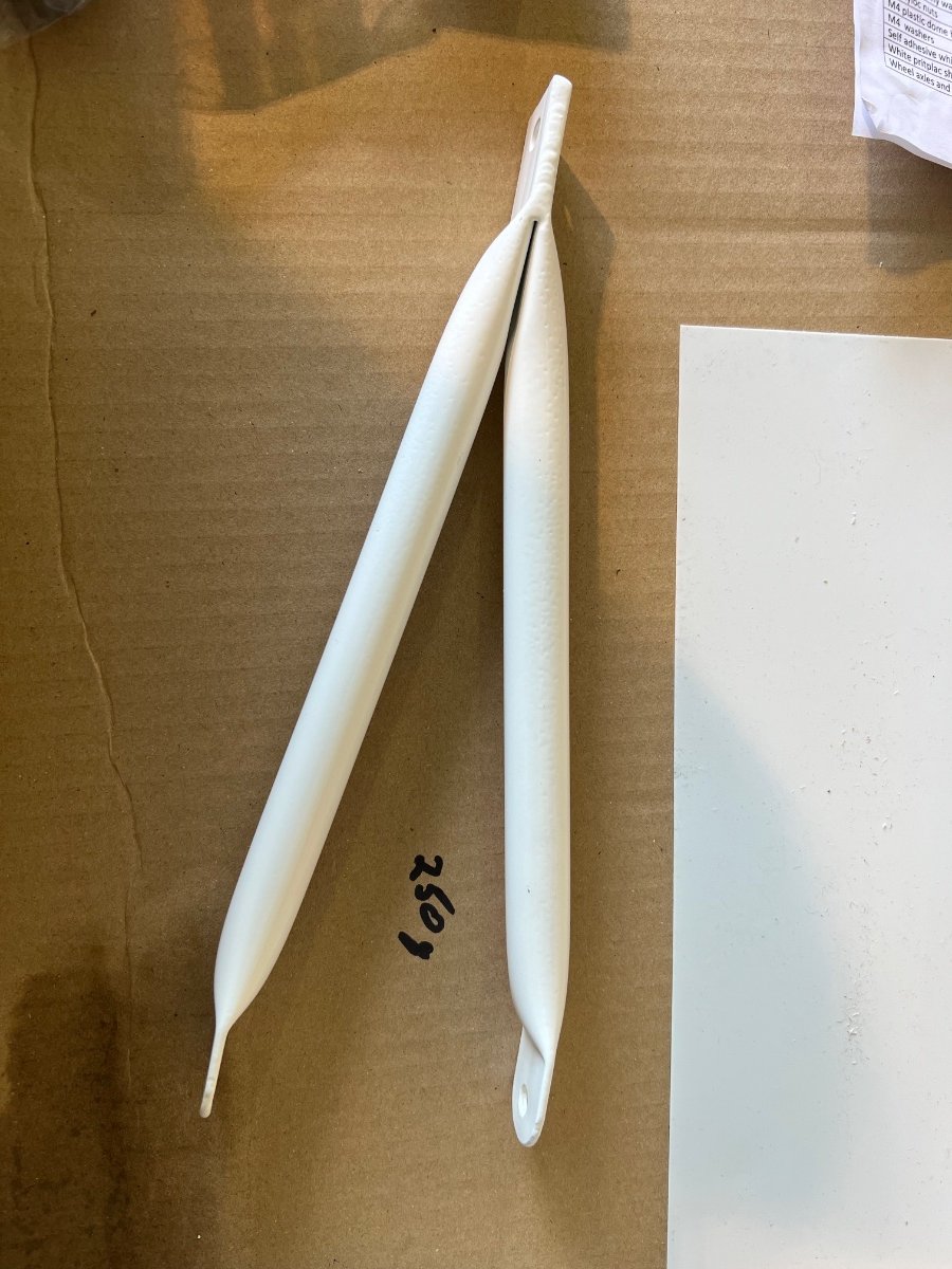

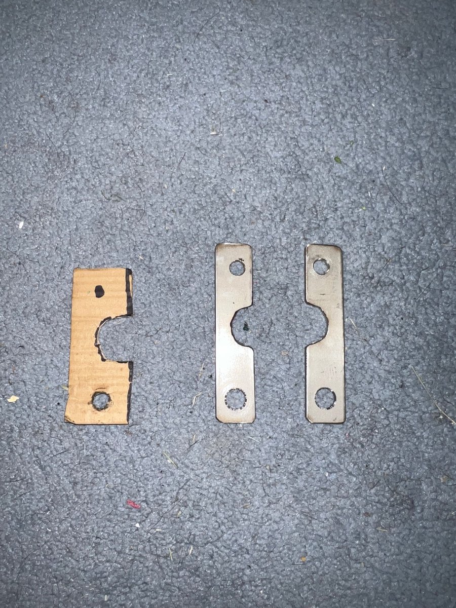

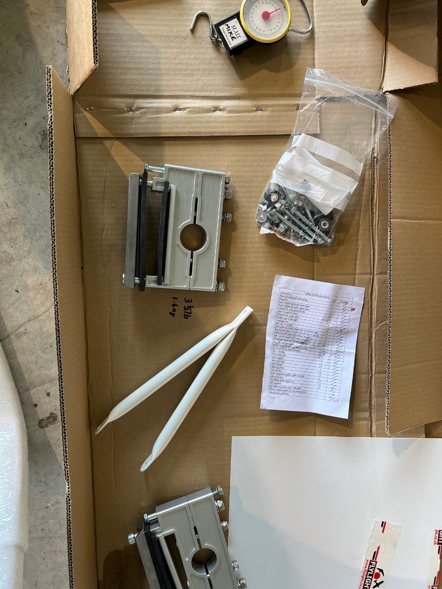

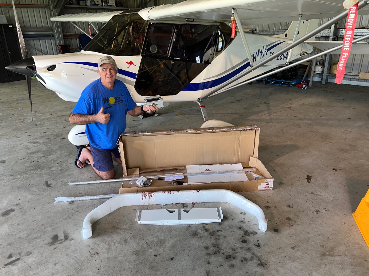

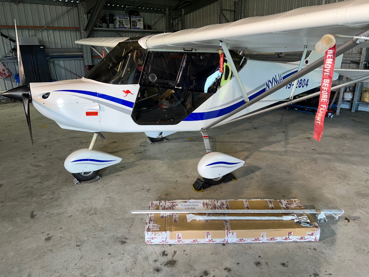

Have the 600kg upgrade kit on the way to be fitted, undercarriage first then do the wings upgrade. Also viewed Barry’s build that is a new 600kg variant.
  • Like 5

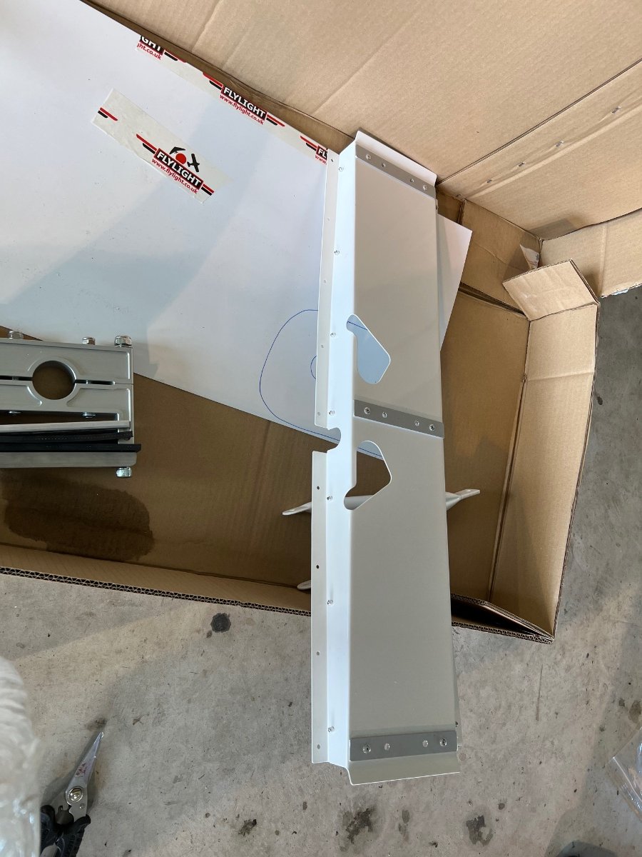

Unpacked the upgrade kit today.  Weighed the items so I have a record of the new structural bits.  I’ll weigh the respective bits removed. A new w&b will be carried out on completion.  Doing the upgrade in two stages, undercarriage first then later the wing upgrade then I’ll be the 600kg variant.  Caving up two lift attachment plates to allow suspending the aircraft without removing the wings. Cardboard template and being made in 25 x 3mm flat bar, made and just need dressing the edges.
  • Like 3
Very interesting Mike!  Looking forward to further reports. That solid one-piece undercarriage member is very impressive.  The U-bolted individual legs of the earlier Rangers never did inspire a lot of confidence (though they seem to work ;- )
