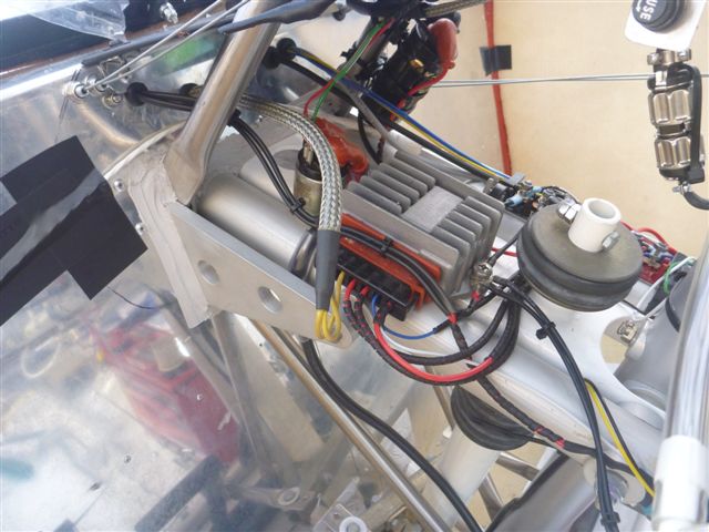

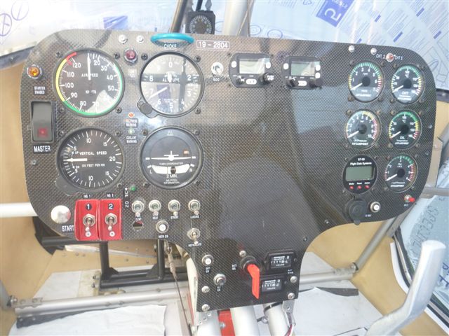

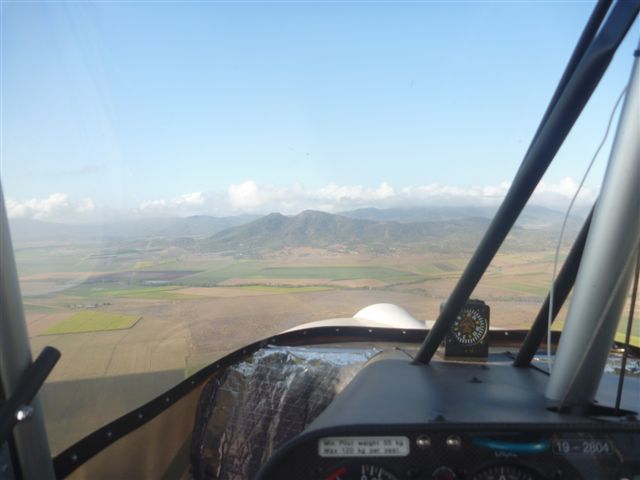

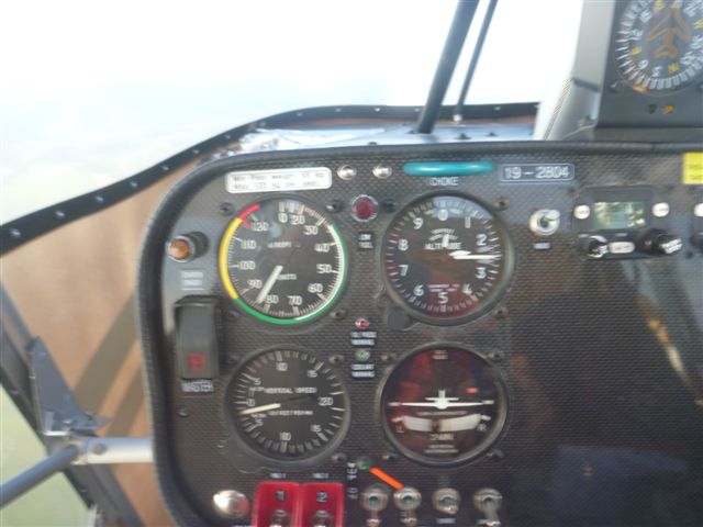

You say you moved the compass after testing. Can you explain/show from where to where, exactly. And for what reasons? Ease of viewing? To better avoid interference?
And what methods did you use to calibrate it to your satisfaction?

You say you moved the compass after testing. Can you explain/show from where to where, exactly. And for what reasons? [see below.] Ease of viewing? [better.] To better avoid interference? [Yep.]

Hi Gary
I first put it up at the firewall end of the top piece of the binnacle as I had seen that on another aircraft. However as my starter solenoid and the regulator is under there it was affected by about 25 degrees on starting the engine. So I moved it two days ago to the front of the binnacle top and it is not effected by operation as it does not move when switches are turned on and engine running. To swing the compass I set up transit alignment bearings off the map features [ eg bridge over river on VTC to a beacon on a mountian, cross roads to a sugar mill etc.] and flew those and adjusted the compass using an alunimum screw driver. It takes a little time but the effort is worth it. I have to do a further 4 hours of cross country and the required 2 hours solo x/c, so electronic gps displays are out.
Images arn't the best but shows were the compass was at the firewall end and now above the instruments plus were the start solenoid and regulator are located.

Thanks for the info and pics, Mike.
That's just what I wanted to know. I have a compass in the same place you did (at first) with the same problems. That venerable (and mandatory) gizmo does just one thing, so we may as well set it up to do it right.
And the method of calibration you used makes a lot of sense. With ground compass swinging, I suppose you never know if the mix of cockpit magnetic interference will match cruise flight values. And flying gps rectangles and doing the maths seems like quite a complicated exercise.

No worries. As some extra info I mounted the compass bracket onto a piece of aluminium bar 40mm by 1.6mm and that is attached to the binicale top using the existing top screws [2 one either side at 300mm between and its tight. I'll take some better images tomorrow and post. Glad to be of help as I got plenty of ideas from Greg, Scott, Steve and other Skyranger and Nynja owners.
Re the transits, I line up over the first feature and fly direct to the other and compare the compass reading and make small adjustments; it also passes the time a bit as I'm flying off the 25 hours.
