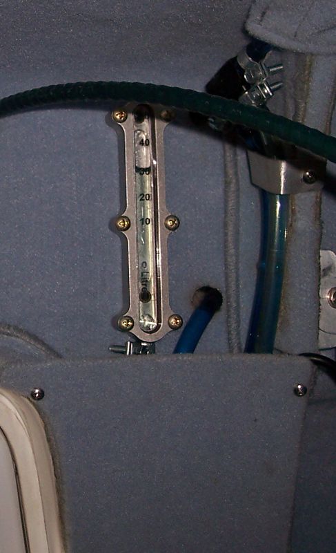

Guest Andys@coffs Posted May 12, 2007 Posted May 12, 2007 Hi Guys Today, as part of a pre-flight activity on my Jabiru J230 I came across a problem that, to me, had flight safety implications, and as such I will be submitting a report to RAAus shortly, however wanted to bring your attention to the problem asap. On entering the cockpit I identified that there was a smell of fuel which was more than normal. After looking around I identified that the internal carpet lining around the wing fuel gauges was wet with fuel and that in a number of places the blue die in the fuel had dried to a significant trace. The bottom line is that the hose clamps that were used to clamp the fuel line to the fuel gauge at the bottom was fully tightened, to the point that no more turns of the tightening screw were available, yet the clamp was able to be moved, under finger pressure around the hose. The looseness was allowing capillary leakage of the fuel to wick down the fibreglass body, onto both the outside of the Aircraft and the inside onto the fabric lining. This was occurring with significant leakage on the passenger side, where the lining was wet for a radius of 7-10cm around the gauge and on the pilots side to a radius of 2-3cm. The attached photo shows the area (passenger side) and the style of clamps used. The fuel piping is the blue plastic type that is around 9mm in outside diameter. The attached photo was taken on the 17th of February this year and shows no sign of leakage. No work around the gauges has occurred since that time. On removing the original clamps it became clear that the clamps originally worked, however not ideally in that they were at the end of travel, however over time the fuel hose has compressed allowing the clamps to become ineffective. I have replaced some of the clamps with the worm driven hose clamps that we are all used to, however I note that they have the potential to cut the fuel line with the worm drive slots on the bands. Tomorrow I’ll be looking at the remainder, however I already note from the photo that some of the other clamps that can be seen are also at full closure suggesting that they too need to be replaced. The particular clamps that most needed to be replaced cant be seen in the photo, indeed they can only be accessed when the fibreglass flashing on top and bottom of wing where the wing joins the fuselage is removed. Can I ask that you other Jabiru drivers have a look at the clamps on you aircraft to ensure that you aren’t shortly to have the same problem. In my case the fuel piping where the problem occured is used extensively as are the clamps that were effectively too big for the job, as such the checking that I will do goes from the wing tanks right through to the carbbie and all points in between. Regards Andy [ATTACH]2007[/ATTACH]

Ross Posted May 12, 2007 Posted May 12, 2007 Hi Andy I have noted the same thing with my J160 kit (yet to fly) which has the blue fuel lines. The hoses can be turned on the fittings when the clamps have been tightened to as far as they will go. So far I have not done anything about it. If (when) the NSW Government legislates (as stated in a news item a couple of days ago) to make it compulsory for all petrol in NSW to have a compulsory ethanol component the hose clamps may not be our only problem! Regards

Captain Posted May 13, 2007 Posted May 13, 2007 Andy Good topic and great post. Like Ross, I am not yet flying my build, but I have to say that I have never liked the look of those blue plastic lines, nor the Manual's requirement to replace them all every 2 years. I have upgraded to thicker solid black pressure rated (but not EFI rated) fuel lines similar to those supplied by Jabiru with the engine between the mechanical fuel pump & the carby. From your post it looks like I did the right thing. They are larger OD and turn corners via a bigger radius which makes them a bit more difficult to install in some places but they look to be much higher quality & longer lasting. Am not even using the blue ones for the head tank vent lines. Regards Geoff
