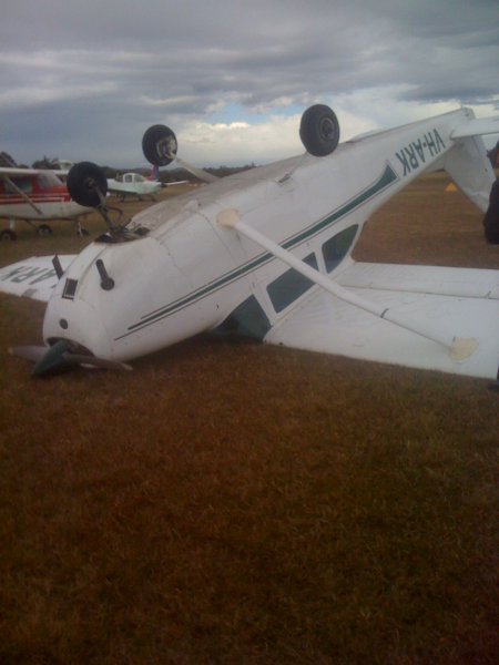

Tomo Posted August 18, 2012 Posted August 18, 2012 Wouldn't that make you sick, turning up and finding your plane like that. I even tie down the C206 when I bring it home, only takes a few minutes and it can save you some serious sweat!

bushcaddy105 Posted August 19, 2012 Posted August 19, 2012 3 Screwits held my plane down at Avalon 2009 while 2 star pickets (fence droppers) failed to hold down the aircraft 3 feet off my left wingtip. I believe this was purely due to the nature of the wind event - my aircraft may have been just on the edge of the wind stream. Close inspection of the damage to 2 other overturned aircraft (I helped dismantle one of them the following day) suggests that had they been tied down any more securely the wings may well have been torn from them, such was the intensity of the sudden lift forces. Both had struts torn from the wing spar at the attachment point. My conclusion is that there is a limit to what you can expect from portable tiedowns, and there is little that can be done to combat freak events of nature, hence the option of insurance!
