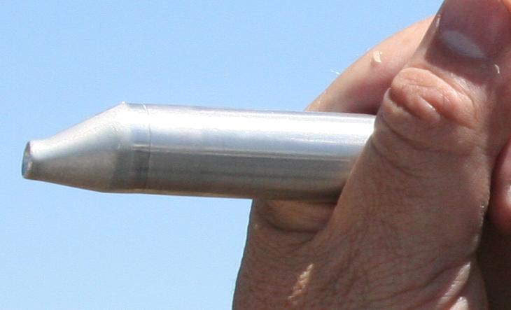

Guest pelorus32 Posted May 22, 2007 Posted May 22, 2007 Now Nev, settle down. I might be able to tell you what...but as for how....it's all magic to me. However as for AOA - that's measured by what looks like a glorified pitot probe. It has the main pitot inlet and then underneath on a beveled surface a series of other tubes. As the AOA increases the relative airflow strikes the subsidiary tubes more directly and so AOA is "measured". Regards Mike
Admin Posted May 22, 2007 Posted May 22, 2007 Like this one although it is upside down and you can't see the little holes in the angles part of the tube
