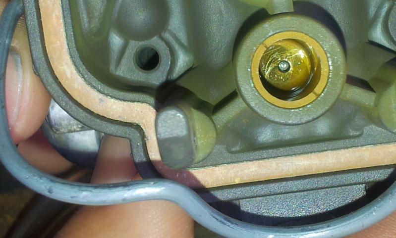

johnm Posted October 30, 2012 Author Posted October 30, 2012 problem fixed ! .......................... and 'lil old motor runs smooth as facthunter suggested - it was the seat - photo is underside of the top portion of carb - the circular brass thing is the seat cleaned / lapped ? all this up - valve now seals against the seat why did the rubber seal and seat leak in the first place - don't know what caused the scratches on the seat - don't know (at attempt 2 a cotton bud was used to lightly clean the seat) 1
