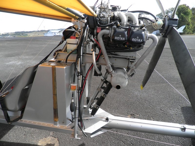

I talked to Wayne about the conversion, and got a few pictures. Looks like I'm going to begin designing a mount for the 912. I'd rather go with a 80hp 912 instead of the S, so we'll see how that goes.
Can't get the parts through Wayne because they were never actually produced for the Austflight Drifter. He said he saw the one at the factory, but didn't build or design it. He did, however, say that it used the 582 mount, adapted for the 912. He also sent me pics of the Fisher MKI 912. He's a hell of a guy.
If my numbers are right, I don't think it will be incredibly hard. I'm pretty sure the prop shaft offset will allow for a 64" prop. This might require 4 blades and lots of money. Maybe I can raise the engine a bit for a bigger diameter 3 bladed prop.
Thanks for those links. The dynafocal mounts on the Titans look pretty sweet. I'll have to call them to see if they'll sell me the machined blocks.
This is the way Wayne mounted the 912 on the Fisher MK1. Looks brilliant to me, and also looks like it could be adapted to the Austflight SB582. Any thoughts ?

Progress is slow, but progress none the less. I've acquired an 80 hp 912 that had a bad prop strike. I'm now going through it to verify everything is ok and replace the out of spec stuff. The plan is to replicate the mount pictured above. Still in the collecting phase though....

One thing to keep in mind.......see those 3 rivets in a line just aft of the fuse pan......I'm fairly sure that Wayne installs a doubler that runs up under the engine mounting point. Although it may not be necessary if you have the model with the pan fairings. I had a Drifter fitted with a 74 Kg (160lbs) Verner that was certified.
Hmmmm, good point. My Austflight bird does have the aft pan fairings, and they're very sturdy. I remember the previous owner mentioning it was an option. They do get in the way of inspection, but I have a borescope that can get in there to inspect the outside of the tube. I was actually thinking of redesigning the lower bracket (the one that both engine mount tubes bolt to and tie into the main tube. Looks to me like I could just use a longer bracket to better distribute the load on too the main tube.
Will probably be fine. I had a WB A582 converted to take the Verner with nothing more than an adapter plate on the original upright engine mount. The mod had an engineering order done by a local CAR35 engineer and approved by the AUF as it was then.

I found a guy who installed a subaru engine on his lockwood drifter (gained 75 lbs he says, no thanks). He sold me the majority of his old motor mount assembly. I also sourced a used prop and oil cooler. The prop is a 4 blade powerfin 64". Now I just need a radiator and to fab up a few bits like the bottom bracket.
Looks like this might actually work !
