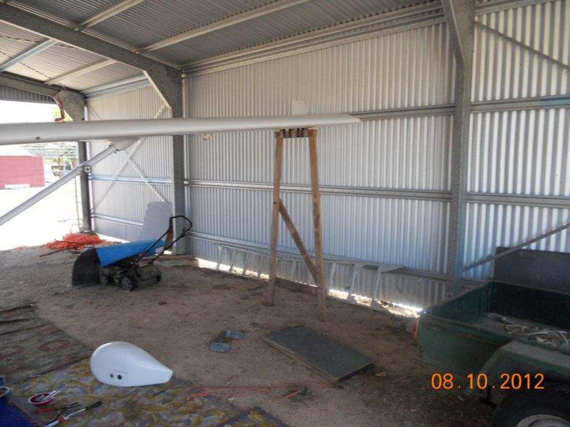

frank marriott Posted November 9, 2012 Posted November 9, 2012 This is what I use if it is any help. It is a copy of what they use at the factory. FrankM

nong Posted November 10, 2012 Posted November 10, 2012 [ATTACH=full]19701[/ATTACH]This is what I use if it is any help. It is a copy of what they use at the factory. FrankM Wondering if you should reduce wing bending loads by placing wing stand closer to lift strut pick up. Would be a shame to overstress your aircraft without leaving the hangar. :-)
jetjr Posted November 12, 2012 Posted November 12, 2012 Wondering if you should reduce wing bending loads by placing wing stand closer to lift strut pick up. Would be a shame to overstress your aircraft without leaving the hangar. :-) Thats what I thought too, but apparantly thats the recommended method from Jabiru I lift mine just outboard of the strut The shudder Im talking about is more like shopping trolley, very hard and violent just before takeoff and just on landing. Basically when the weight of not fully on legs. Can be strong enough to break spat.
biggles Posted November 12, 2012 Posted November 12, 2012 Thats what I thought too, but apparantly thats the recommended method from JabiruI lift mine just outboard of the strut The shudder Im talking about is more like shopping trolley, very hard and violent just before takeoff and just on landing. Basically when the weight of not fully on legs. Can be strong enough to break spat. Regarding wheel alignment ,I used a few long pieces of wood and ,with the aircraft empty , set the toe-in at 20 mm (each wheel) , level with the nose wheel by shaping the wedge to align both camber and toe-in . I changed the tyres and tubes at 200 hours even though they still had plenty of tread left . I have not heard about that violent shudder you describe , but would be advising anybody with those symptoms , to have a real good look a the undercarriage also , before next flight . Jabiru also recommend to lift the a/c at the strut which makes good sense , would hate to doing it with near full tanks . Bob
