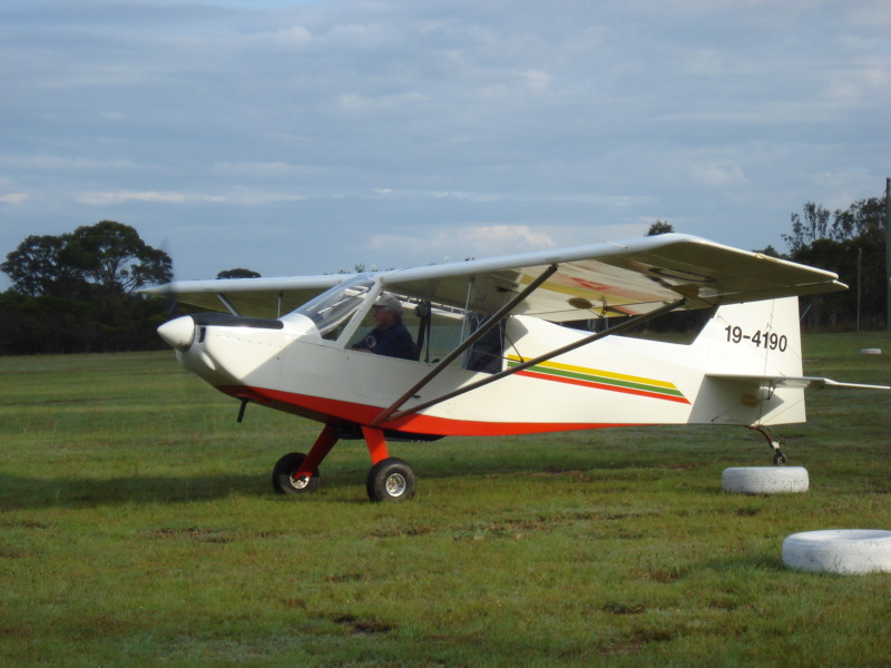

gregrobertson Posted November 10, 2012 Posted November 10, 2012 Have a look at a Skyranger or Nynja. Quick build, proven design, STOL capability, High wing, Float friendly. Good cruise speed (90-100 kts). www.bestoffaircraft.com.au Greg. 1

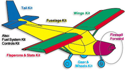

eightyknots Posted May 23, 2013 Posted May 23, 2013 Zenith Aircraft do component kits: http://www.zenithair.com/stolch701/7-price.html#COMPONENT KITS or http://www.zenithair.com/stolch750/750-price.html#COMPONENT KITS for the CH701 or CH750 respectively. If you want a 4-seat plane, there is the CH-801: http://www.zenithair.com/stolch801/kit.html I believe that the Zeniths can all be fitted with floats. However, as rgmwa pointed out, Savannahs are worth looking at. The only problem with the Savannahs is that the kits don't come in sections but I understand from many people that the Savannah is a better aircraft. Unlike the Zenith planes, Savannah have never developed a folding wing option for ease of storage (e.g. in your own garage). I hope that helps. 1

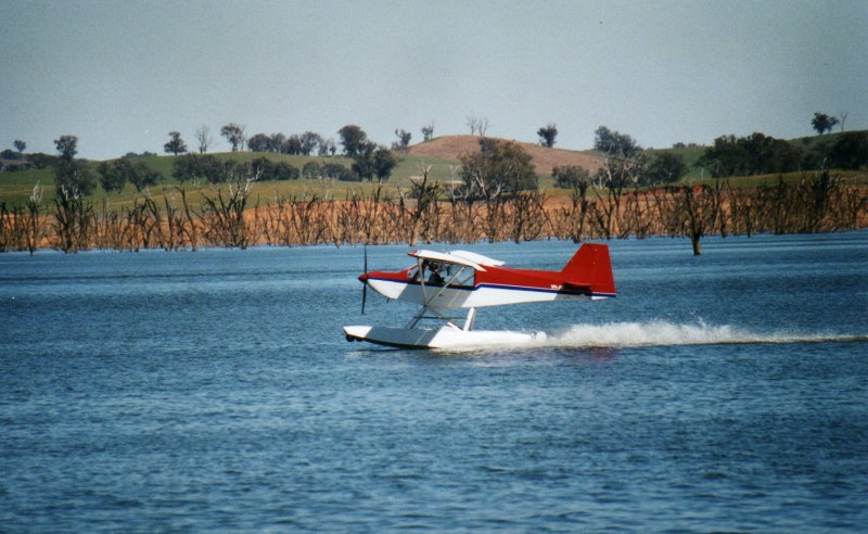

FlyingVizsla Posted May 30, 2013 Posted May 30, 2013 An amazing site for RANS aircraft - http://ohiobushplanes.com/1/ Go to Videos, Other and watch "It's A Rans Man" (now I can't get that tune out of my head) or Videos, Flying and watch the Aerocross (taking off and landing on little strips all over the place in a few minutes). The RANS is a versatile little craft. The official RANS site is www.rans.com Here's one on floats.
