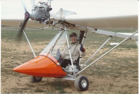

Guernsey Posted December 1, 2012 Posted December 1, 2012 Hi JimG, you are correct when you say that the Tyro is very pitch sensitive so I extended mine and put a 'goose neck' in it to position it closer to me. Looks a bit odd but worked very well. Alan.
Head in the clouds Posted December 1, 2012 Author Posted December 1, 2012 Hi JimG, you are correct when you say that the Tyro is very pitch sensitive so I extended mine and put a 'goose neck' in it to position it closer to me.Looks a bit odd but worked very well. Alan.[ATTACH=full]19890[/ATTACH] Good solution Alan. Helicopter cyclics (joystick equivalent) are very sensitive too and most folks adjust their seating so that they can rest their right wrist on their leg to provide extra stability. I got really used to that and now I far prefer aircraft with sensitive controls so I'm going for an all-flying elevator on OzMoz to be sure of it. So Jim, don't be worried about the sensitivity, as long as you're expecting it it won't worry you. Nice looking Tyro in the photo Alan! Cheers, Al
newairly Posted December 2, 2012 Posted December 2, 2012 Surprising how things come from the past. The Tyro shown in the picture is 19-1219 which I bought nearly 5 years ago, but have not flown for 3 years. It is quite sensitive in pitch, but not difficult to get used to. Having the stick nice and close certainly makes it easier. A bit like some gliders I once flew where you could just rest your arm on your thigh and just use your fingers only most of the time. The thing I found difficult with my Tyro is the lack of much pitch stability making it difficult to trim for a constant attitude. This probably comes from the stabilator which has no anti servo tab. It is hinged at the centre of pressure so seems to be happy to stay wherever it is put. Phil
JimG Posted December 2, 2012 Posted December 2, 2012 Thanks Guys for the input about the Tyro pitch situation. I think that during the build stage it is much simpler to introduce systems than once its builds. So with this in mind here are my plans to tackle this. 1. is to ensure the that the C of G of the aircraft is always in the front half of the manufactures ranges in all load conditions. Nose heavy = pitch stability at the expense of elevator authority , but I'll keep it sensible. 2. Mass balance the elevator. 3. Install a anti-servo tab similar to the Evans Volksplane and have the push rod mount at the fuse end on an adjustable level controlled from the cockpit for trim adjustment. 4. Longer, better positioned control stick as mentioned above. Anyone see anything suspect or have any notes of caution would be welcomed as I'm very much a novice aircraft builder. Cheers JimG
