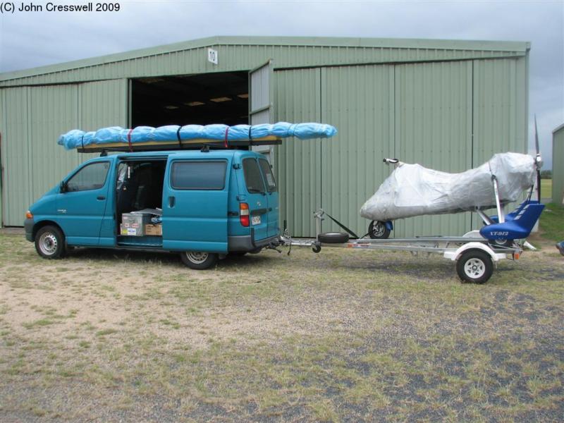

Guest Crezzi Posted December 9, 2012 Posted December 9, 2012 I've always favoured support under the wing too - I have a wooden frame with foam padding. Although its more convenient, I'm not keen on carrying the wing on the trailer as the vehicle suspension is (usually) better. PS the plastic coating was just for a 800km drive in torrential rain. Cheers John
