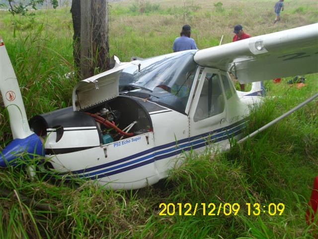

Kiwi Posted December 10, 2012 Posted December 10, 2012 I had just refueled the plane before take off , fuel supply had come from 201 liters tanks transferred into 20 liter containers then transferred out to the pumped into the plane { real possibility } Glad that you are both ok. I was at the crash site on Sunday securing the aircraft with 4 others including John Mckeown (local Raaus rep and approved Raaus accident investigator.) I drained the remaining fuel out of the starboard wing and there was no evidence of water in the fuel.(I also filed up the ride on mower out of the same drum straight after Craig had filled 7200.) Another club member was flying over the Dam 30 minutes earlier in his Jab and experienced carby ice, (high time pilot) so that is something that needs to be considered. It will take quite a bit to recover the aircraft and while the insurance company might not be interested, Ian and the rest of our club plan to find out why the rotax stopped. Google coordinators are ....................... Google earth shows only the northern half of the Wyaralong dam, so I have included a photo taken from the air not long after the crash. (The jab pilot and I went looking for the downed aircraft while Dave went by car). I have also included some photos taken from the ground. Kiwi. 2
Viper Posted December 10, 2012 Author Posted December 10, 2012 Viper,You did it perfectly, your here and you and your daughter are alive and that is all that matters, the plane is replaceable life isn't. As for the CFI he can harp on why didn't you do this or why were you over there, fact of the matter is the fan stopped probably for a reason not linked to you. Your survival instincts kicked in more so with your child with you, you might have bent the plane but who cares your alive and that is all that matters. End of story. Alf King words Issac I appreciate that

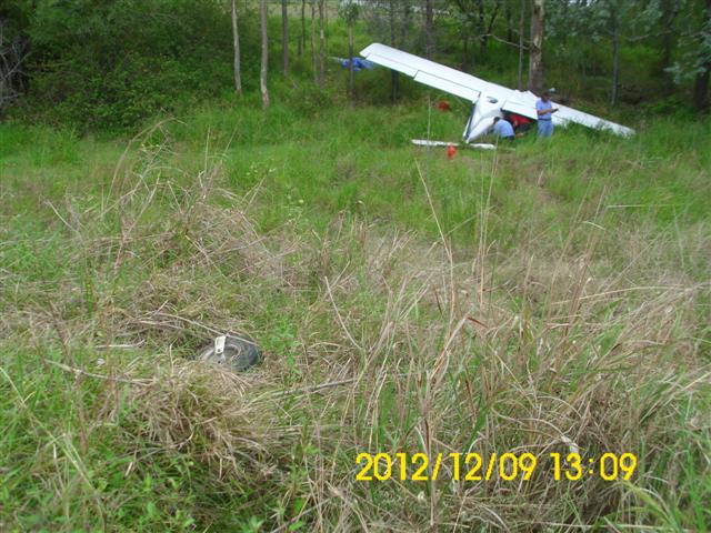

dazza 38 Posted December 10, 2012 Posted December 10, 2012 Just checked out Kiwi's photo's. I honestly think that, that was a good place to put down Craig. At the end of the day, planes getting bent doesnt really matter. People getting bent is the problem.Well done. 1
Viper Posted December 10, 2012 Author Posted December 10, 2012 Glad that you are both ok.I was at the crash site on Sunday securing the aircraft with 4 others including John Mckeown (local Raaus rep and approved Raaus accident investigator.) I drained the remaining fuel out of the starboard wing and there was no evidence of water in the fuel.(I also filed up the ride on mower out of the same drum straight after Craig had filled 7200.) Another club member was flying over the Dam 30 minutes earlier in his Jab and experienced carby ice, (high time pilot) so that is something that needs to be considered. It will take quite a bit to recover the aircraft and while the insurance company might not be interested, Ian and the rest of our club plan to find out why the rotax stopped. Google coordinators are 27 55 39S 152 47 37E Google earth shows only the northern half of the Wyaralong dam, so I have included a photo taken from the air not long after the crash. (The jab pilot and I went looking for the downed aircraft while Dave went by car). I have also included some photos taken from the ground. Kiwi. Hi Kiwi Thanks for all your help it was much appreciated at a terrifying time maybe carb icing could have been the reason I spoke to Ian this morning and asked what sort of investigation would occur ,his words to me were that he had spoken to every relevant authority including RAAus and no one would be taking it further , he also said that no one would bother to spend the necessary cash to investigate and at no stage indicated to me that he would do otherwise actually indicated to quite the contrary ( quite Flippant } I do know Ian is a very experienced pilot 20000 hours I think and I have nothing but respect for him as a pilot but this morning his $#@ happens attitude to this was appalling. I are not looking to find a scapegoat or blame anyone or in Ians words clutch at straws I just would like a explanation for my own self and for the safety of every pilot out there , surly this is nothing but due diligence
