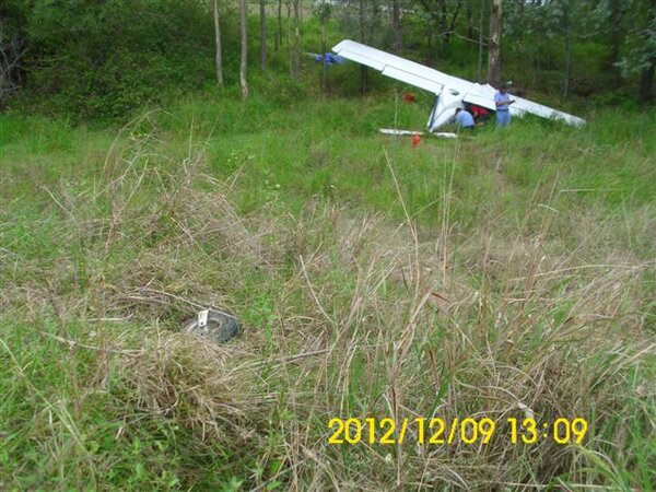

The main problem is that as soon as the crash happened the aircraft belongs to the insurance company, and with out their permission no one can touch the aircraft.
As no one was seriously hurt (I'm still amazed), the police and ATSB wont get involved. It will probably cost $2,000 plus for them to remove the aircraft, and they will be lucky to recover anything from the sale of the wreck.
Once the Insurance company have inspected the aircraft some of the club members plan to approach them to remove the aircraft at no cost to them (the Insurance Company) so we can inspect the aircraft and try to find out why it stopped.

The main problem is that as soon as the crash happened the aircraft belongs to the insurance company, and with out their permission no one can touch the aircraft.As no one was seriously hurt (I'm still amazed), the police and ATSB wont get involved. It will probably cost $2,000 plus for them to remove the aircraft, and they will be lucky to recover anything from the sale of the wreck.
Kiwi

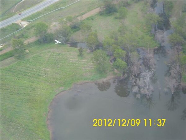

Thanks for the reply Kiwi I really look forward to hearing from you re the outcome, as to the crash fortunately for us at the end you would have noticed the 2 meter drop off ,it was this that scrubbed off excess speed so we actually hit the trees with not a lot of force even though it does not look like it

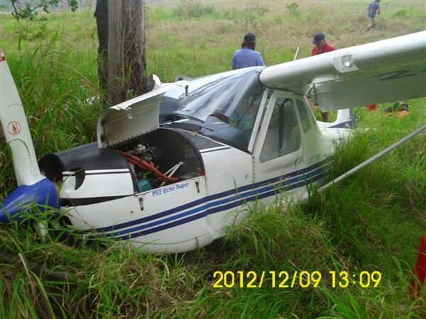

How did the inside floor of the cock pit hold up to the landing ..................... was there much / any internal deformation - was there any obvious failure of the frame in the cockpit area ?

the cock pit held up with only a small deformation jamming the left door We actually did not hit the tree very hard although it does not look like it most of the speed had been scrubbed off as we dropped off the embankment breaking the undercarriage hopefully see some of you at the next fly again thanks

I am very interested in the cause as I am a great believer in the 912 engine, Tecnam aircraft and I have a good few hours on this particular aircraft.
