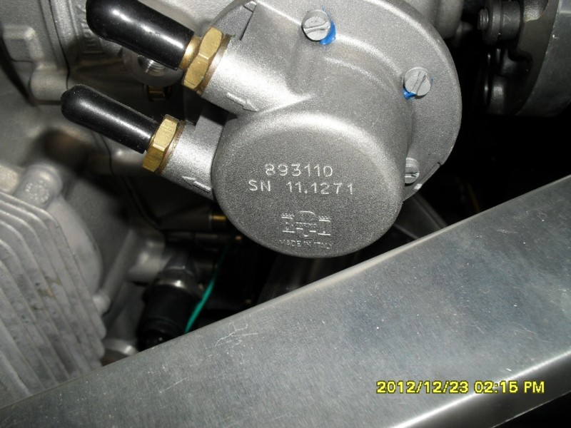

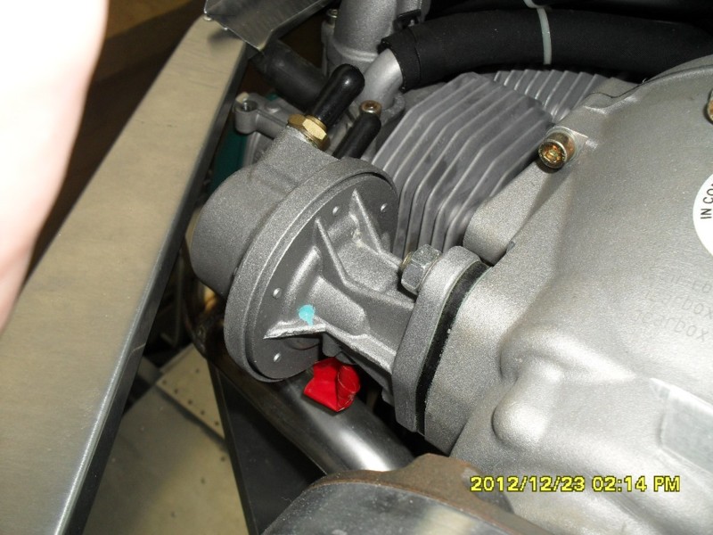

Head in the clouds Posted December 23, 2012 Posted December 23, 2012 Quote Most of the fancy Euro cars use Pierburg pumps such as Porsche, Mercedes, BMW etc etc............their's is an interesting website by the way.................................................Maj... Can anyone tell me what type this fuel pump is on the 912 I am fitting to my current project? And do they have a history, good or bad?
skyfox1 Posted December 23, 2012 Posted December 23, 2012 Hi it looks like the latest fuel pump that rotax have just bought out CPS sell them l have heard that some of them over pressurize the fuel system . l was going to replace mine with one of the new ones but decided to go with the original peirberg pump. cheers Geoff. Here is the link http://www.rotaxparts.net/scripts/prodView.asp?idproduct=1333
Guest Maj Millard Posted December 23, 2012 Posted December 23, 2012 Yes that is the new style pump. I have purchased one from Floods, but haven't fitted it yet. Still running my Pierburg. I chatted with Gary a couple of weeks ago, and he said they are doing fine. There was some discussion on US forums about these pumps producing too much pressure, but I haven't heard much lately. It always wise to fit a fuel-pressure guage as you don't want to produce too much pressure for the Bing carbs..................................Maj...
Head in the clouds Posted December 23, 2012 Posted December 23, 2012 Thanks so much for the feedback Geoff and Maj. I bought the engine a year ago, so those pumps have been fitted at least as long as that. Never considered a 'too much pressure' scenario so I'll check the manual about max pressure for Bings (unless anyone wants to enlighten me...). So what's the failure mode of the carbs with too much pressure? Flooding obviously... due to...? Pressure overpowering the float needle? And - how to reduce the pressure if necessary? Your experience much appreciated gentlemen, and ladies!
Guest Maj Millard Posted December 23, 2012 Posted December 23, 2012 Range on the Bing carb is 2.2-5.8 Psi. If they get too much pressure, yes you can overpower the floats which leads to a richer mixture , possible rough running and fuel being pushed out through the equalization tubes. Some installations have overpressure-orifices in the fuel system which bleeds off excessive pressure and takes the un-needed fuel back to one of the tanks. The Rotax installation manual should show various fuel-system set-ups..My boost pump tends to give me around 7Psi on the guage when it's on, but it is only on for a short time at takeoff, and just before landing ..........................Maj...
