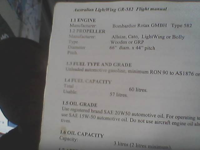

flyerme Posted January 3, 2013 Author Posted January 3, 2013 whats this? a 3 blade? This is the australian lightwing flight manual for aircraft type GR582 thats sits in my plane P.S just thought Id throw my boof head in the shot..thats BOOF head NOT BALD head...wise guys..I know you lot to well:roflmao:
flyerme Posted January 3, 2013 Author Posted January 3, 2013 Ok I admit sometimes I just don,t think...what a idget....I opened up the flight manual to page 3 and bingo, Propeller :ALLSIZE,CATO,LightWing or BOLLY Type : Wooden or GRP Diameter : 66".x 44"pitch No mention of blade numbers. and whats GRP?
