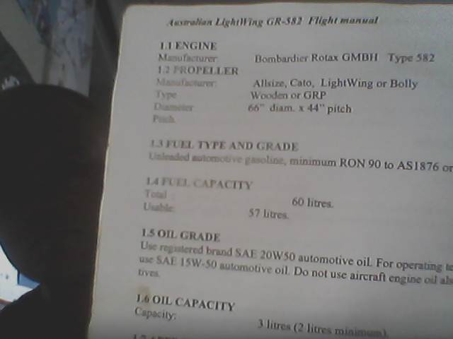

flyerme Posted January 3, 2013 Author Posted January 3, 2013 G'day flyermeCatto props are excellent,but did u mention to Howard that u had a E Gearbox on your 582,as that size seems too small(66 x 44).I used a 64 x 42 catto on my old 503 with B gearbox and got 6500 rpm,Just concerned about underpropping. Cheers Corky Hi Corky,Mine runs a G box,Not sure what ratio? I told howard this and he suggested the Catto,66"x44 fixed pitch 2 blade wooden (for my budget)I found that the only certified size is 66"x44"pitch, I have been offered a BOLLY GRP 3 blade 66"x44,,,, As this ticks all the boxs (SEE pic) but would like to have it ballanced(I have ballanced my old 95.10 props but I would like this done with a balancer device?)anyone know where Id go to have the prop ballnaced (near murray bridege)

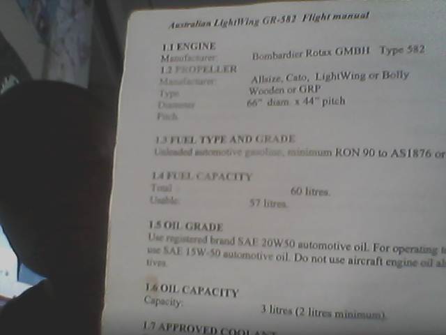

Teckair Posted January 4, 2013 Posted January 4, 2013 Ok I admit sometimes I just don,t think...what a idget....I opened up the flight manual to page 3 and bingo, Propeller :ALLSIZE,CATO,LightWing or BOLLY Type : Wooden or GRP Diameter : 66".x 44"pitch No mention of blade numbers. and whats GRP?[ATTACH=full]20158[/ATTACH] Hey Flyerme that book talks about engine oil, so I am thinking it might cover 912 Lightwings as well. Might be a good idea to check if you are not going to use the Cato prop just to make sure. Ending up with another wrong prop would not be good. Richard.

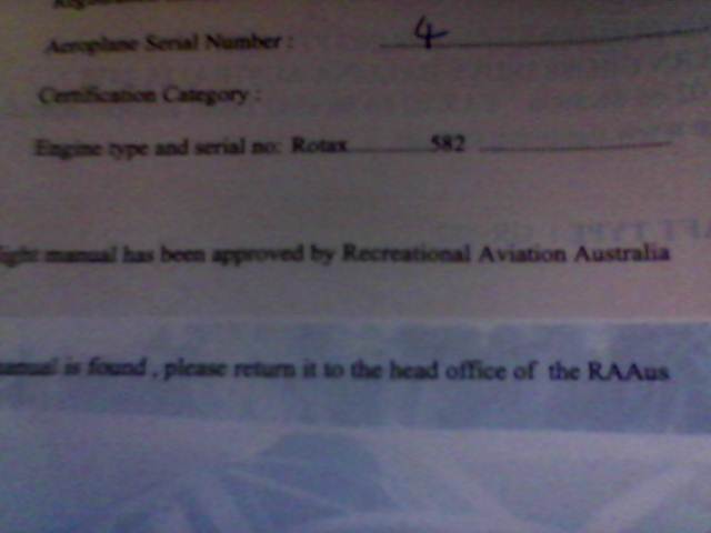

flyerme Posted January 4, 2013 Author Posted January 4, 2013 Its definatly just for the gr 582 ..not sure what the oil grade and oil capacity refers to .oil injection? anyway it states "this flight manual has been approved by RAA Aviation Austrlia" and is printed "only for gr 582".. so all good, I have photo copied the book and Howard Houghs is sending a signed letter to varify .take it easy ..

flyerme Posted January 4, 2013 Author Posted January 4, 2013 Hey Flyerme that book talks about engine oil, so I am thinking it might cover 912 Lightwings as well. Might be a good idea to check if you are not going to use the Cato prop just to make sure. Ending up with another wrong prop would not be good.Richard.[/qu Howard Houghs confirmed it refers to Oil injection that lubricates the waterpump bearings,He said just fill the reservoir with 2 stroke oil. Good as thats what ive been putting in there...
pylon500 Posted January 6, 2013 Posted January 6, 2013 If you are running the 3:1 C box on a 582, a 66x44 would probably be a bit under propped. 66 x 42 or 44 is more typical of a 582 with a 2.85:1 B box. Given the choice, I would choose the 3 blade Bolly and they are on special at the moment in the magazine. Interestingly, the prop on the manual looks like a GSC (Canadian) prop, just like was supplied with our GR582 after one of it's overhauls at Howie's Just remember NOT to use the oil stated in the manual (obviously a typo), keep using two stroke oil. 1
