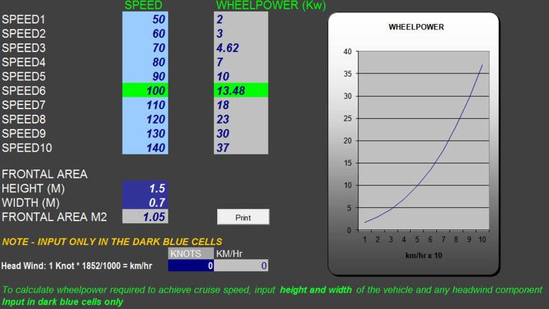

turboplanner Posted January 30, 2013 Posted January 30, 2013 Most motorbike motors are only used at the very low end of the hp range (circa 5-10%? on acceleration) for very short periods of time before effectively "idling" in terms of potential power output. Simple maths of power requirements to keep a 100kg rider on a 250 kg bike at 100 km/h including a drag factor of say 0.4 would give you a rough idea. This is clearly evidenced by the 250-350 km/h most modern bikes are capable versus the pottering around at 100km (or as in your assumption, 70 km/h average). Quite literally it is a very lightly loaded scenario. Note that a 1.5t car takes about 15kw to keep it going at approx 100km/h, and a bike has a hell of a lot less weight and frontal area to push through the air.Compare that with an aircraft engine that is rarely used below 80% of full power... If you subjected the M/C engine to the same test standard as an aircraft engine I think you would see the reliability and effective "TBO" reduced significantly. I just guessed the height and width of a motor cycle, and at this frontal area, your figure for power demand at 100 km/hr is roughly the same, but the demand is exponential with speed. So at 140 km/hr or 76 knots air resistance power has jumped to 37 kW - or nearly three times the power demand 100 knots is 185 km/hr so power demand is much more again 67 knots is still 124 km/hr, requiring nearly twice the power demand However, that's only the power demand to overcome wind resistance. To this power demand you have to add things like alternator, mechanical efficiency, rolling resistance etc. which all take their piece of available power. So depending on the desired cruise speed, a motor bike engine could have to contend with quite a large power demand in an aircraft. What saves the motor cycle's engine on the ground is that power demand is usually intermittent with the engine backing off through the gears and for speed restrictions. Aircraft use is a constant speed demand application, so there is no relief for the engine like there is on a motor cycle. Under those circumstances one of the design issues is to ensure the aircraft application does not exceed what the engine can live with at a constant, heavy load. 1
