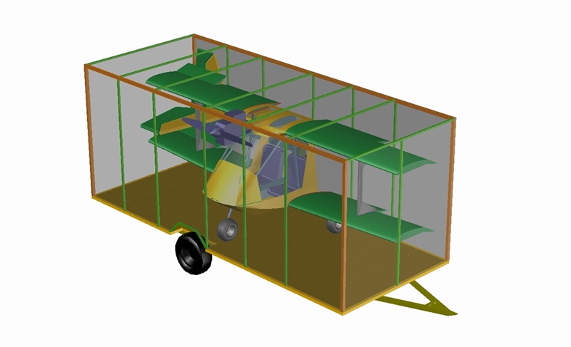

Bandit12 Posted March 28, 2013 Posted March 28, 2013 We wait with baited breath...... Have you and the other party looked at the market for a biplane? Personally I love them and would have little difficulty spending the rest of aviating days in only biplanes, but that may not be to everybody's taste. I can see from the point of view of the folding tail/trailer option the necessity of the bipe, but is there a big enough market for one? This was probably mentioned before, but my mind is like a sieve most days.....

Pilot Pete Posted March 28, 2013 Posted March 28, 2013 I truely think there is a market for a small plane that can seat two and be transported easily due to its folding fuselage and be stored at home in a small space (hangerage costs can be very high and restrictive) ande have a very unique look. Rag and tube construction seems to be one of the easiest and cheapest forms of aircraft building and therefore one of the easiest ways for a person to have themselves an aircraft,building wise. Since I am a rag and tube builder myself I maybe biased, but there you have it. 1

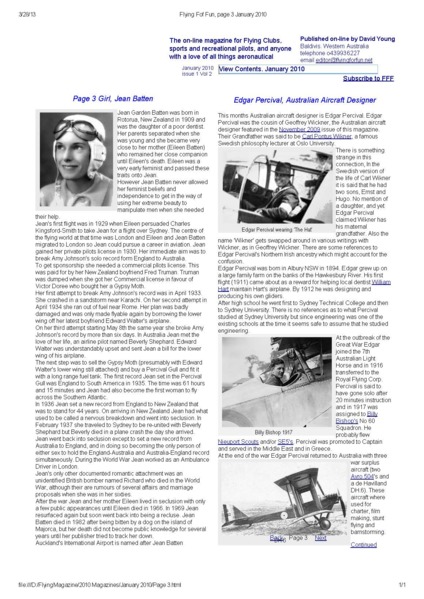

Head in the clouds Posted March 28, 2013 Author Posted March 28, 2013 Just so I don't get accused of holding out a tease on two fronts at the same time I'll try and upload an HTML page of what I think was David Young's first edition of the FFF magazine. Frankly I think it's a remarkable piece of work for a one-man publication and following his uni courses I'm sure they'll be even better. If the upload works this is page three of the six page January 2010 edition. Comments most welcome please folks. Please note that the links don't work on the pages because it's an HTML file and the other pages referred to aren't there... Damn, can't upload an HTML file here. I'll see what can be done to convert it to something non-interactive. I was able to 'print' my aircraft build log so maybe I can do something like that. Still within the editing time... try again - nope the file is too large, just a one page pdf, I'll try again...
bexrbetter Posted March 28, 2013 Posted March 28, 2013 I don't know HITC, I thought it was going to look more modern? . 1 1

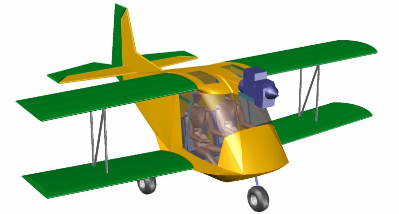

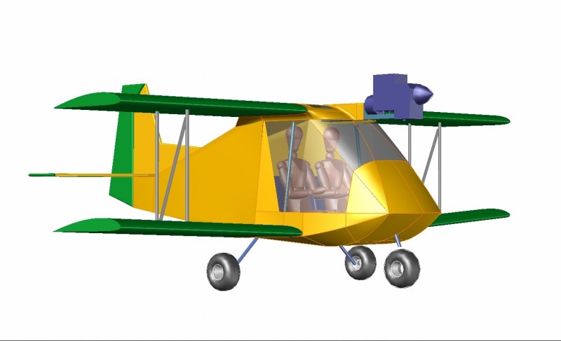

Head in the clouds Posted April 24, 2013 Author Posted April 24, 2013 No news yet, but it's still progressing. Meanwhile the shape continues to evolve, all comments welcome -

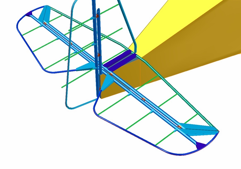

Pilot Pete Posted April 24, 2013 Posted April 24, 2013 Cute. Im still trying to figure out how the tail swings to one side without disconnecting controls.
Head in the clouds Posted April 25, 2013 Author Posted April 25, 2013 Cute. Im still trying to figure out how the tail swings to one side without disconnecting controls. Thanks. I'm doing the CAD work on the folding concept at this very moment. Won't be long before I can show it, sorry for the drawn out tease, not intended ... Speaking of teases, no-one ever did answer the Henry Ford question about why folks could have a Model T in any colour as long as it was black. There were two reasons, both related. As you'd know old Henry was the inventor of the production line process and was fanatical about efficiency, it was the only way to bring the automobile to the masses. And black paint dried quicker than any other colour. Not only that but in those days the paint was enamel and it was oven baked (baked enamel) once it had dried sufficiently to be heated without running. And - black could be baked at a far higher temperature, hence quicker, than other colours which got charred at higher temperatures.
DGL Fox Posted April 25, 2013 Posted April 25, 2013 Looking good, can't wait to see your finished project David

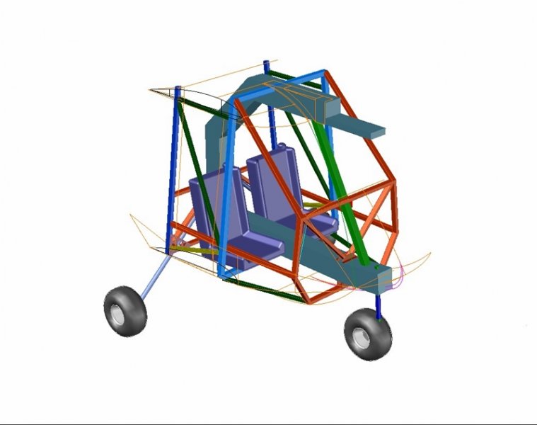

Head in the clouds Posted May 27, 2013 Author Posted May 27, 2013 Orrright it's a fair cop. Things have been plodding along, not as fast as I'd like but even so the progress is good. First face-to-face discussions lasting a week were had with the 'interested party' about getting the manufacturing done in a big way to get the costs right down. All the necessary aspects are available including the funding but we're still working on the details. The CAD modelling is progressing well, and as fast as I can, given that I have to do it between my full-time work, but I'm pleased with how it's working out. It's quite a battle though, keeping it very short to fit trailerable dimensions when folded, and still being able to get in and out of it easily. The interior is really quite large, bigger volume and taller than almost all LSAs but the maximum dimensions I can get for the door frame will mean a bit of technique getting in and out, but it's not as tight as some. At least there are good handhold positions to assist with it. In addition to the design work and planning for a prototype build I'm starting the research of the current process for getting a kit Approval - if anyone's been through it and is willing to pass on their experiences I'd be very grateful. Some of you may have noticed I posted a thread asking for a damaged prop so that a friend could run a 503 that's been standing unused for too long. Member Howe very kindly offered a 60x42 Sweetapple that's in fine condition for the giveaway price of $100. My friend is still battling financially so I said I'd buy it for him to look after the engine and it just shows how one good turn immediately brings another because the friend offered me the engine to use for the prototype of the Cheap 2 Seater. Ideally it would have 60-80hp but the 50hp 503 will do fine for initial testing. We tried to run the engine last weekend and glad to say the inside looks and turns over like new, no signs of any moisture inside, gladly the owner has been turning it over by hand for the last couple of years while it's been sitting still. But - there's no spark. It's a DCDI and neither ignition unit is putting anything out. The whole engine needs a clean-up so I've stripped the fan shrouds off, carbies, exhaust, recoil starter etc. The last 503 I had was equipped with a stator and points, and a pair of coils for single ignition so I don't know about the electronic ignition units on this one - anyone an expert out there please? The 'interested party' (hopefully the discussions will be concluded and agreed soon and he can be given a name) has also requested a name for the Cheap 2 Seater, for ease of discussion as much as anything, so we've called it the Dragonfly for now (Dragonflies have four wings and fly slow and dash about - gettit?), unless anyone has a better idea? Just so you know I haven't been slacking off here are a few images to keep the appetite whetted. For obvious reasons I don't want to give away too much detail just yet but you'll see the general idea. The folding is very simple and will be as quick as I first suggested. The cabin and tail feather structures are all tube and gusset/bracket rivetted and/or bolted and the wings are all pop rivetted, so it should be an exceptionally simple kit to assemble even for first-timers with two left hands and hardly any tools. I'm envisioning the kit to be a 'quick build' as well, so that everything that's left for the builder to do is self-jigging. I've also made a preliminary jig for forming the truss ribs, it's not hardened but will do to make a full set of ribs for the prototype, and I made a single bay section of wing for testing and strength/weight analysis, it's worked out very well, and is another easy assembly method for the homebuilder. Note that everything shown in the CAD images is still a work-in-progress, so don't worry about that doesn't look strong enough and all that, none of it is finished yet ... Comments invited and welcome as always, thanks. 3 1
