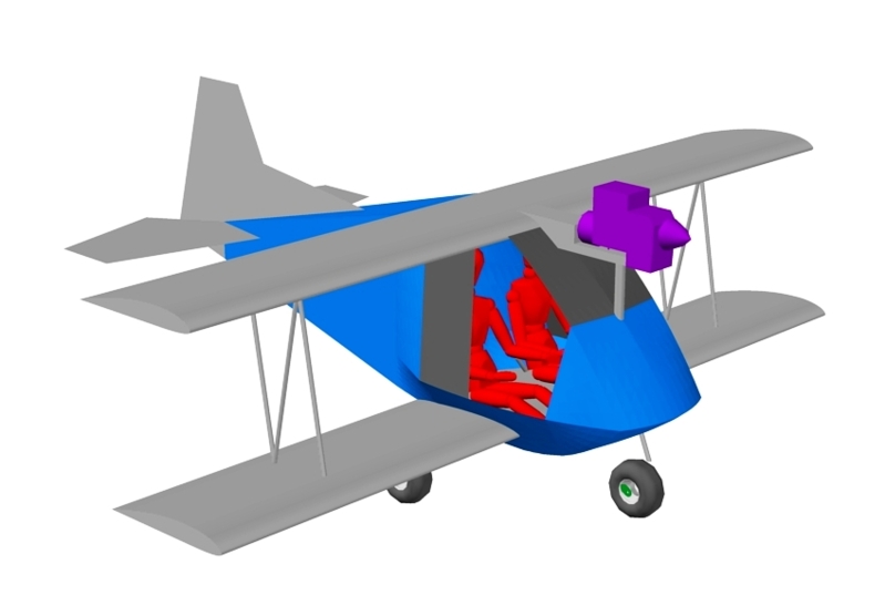

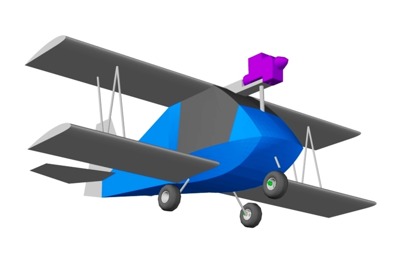

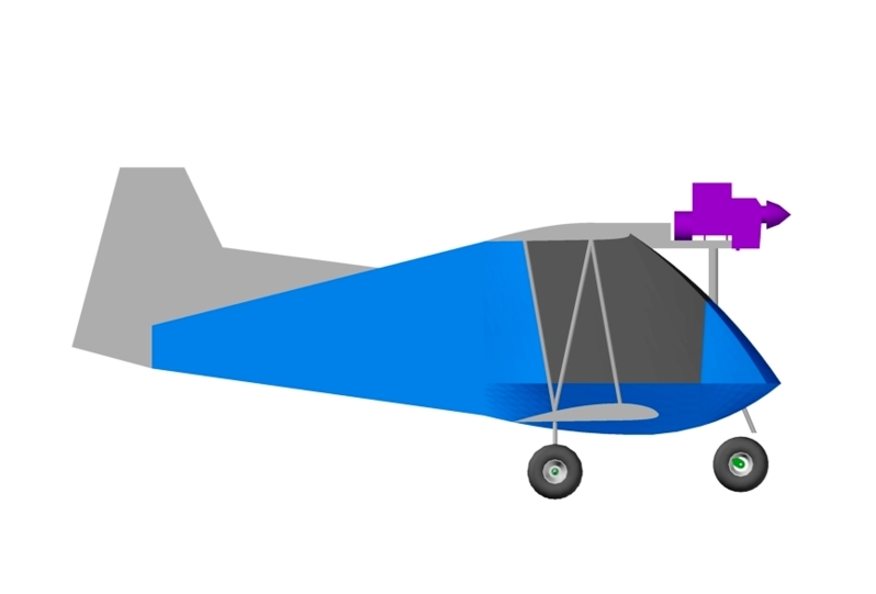

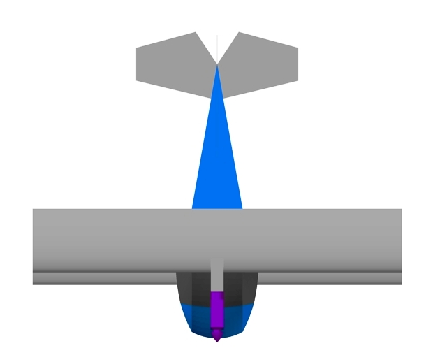

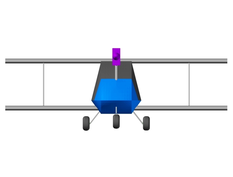

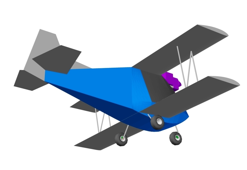

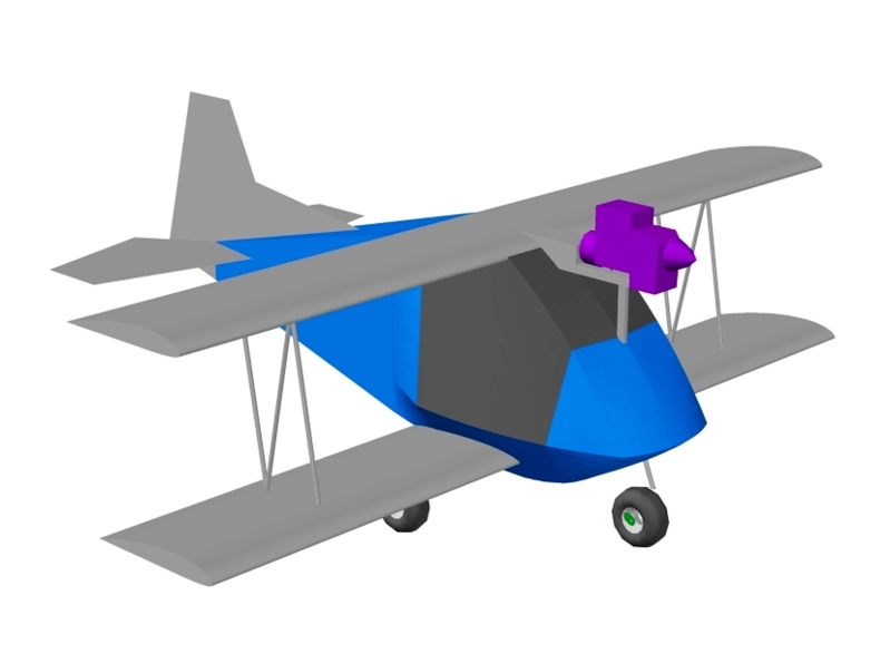

Head in the clouds Posted January 24, 2013 Author Posted January 24, 2013 Hi Paul, Welcome to the forum and thanks for your valued input. Sorry everyone who have been patiently waiting, I'm sorry I got caught up with work so haven't had time to put much work into the model. So I decided to just throw something together for discussion. It's very basic at present the crew compartment will be faired into the wings and all that, it's just a depiction so you can see the general configuration. See post #35 for a description of the folding concept. It's only letting me upload some of the files for some reason, I'll try the rest in the next post. EDIT - Some of these images load sometimes and won't at other times. I know they're working on the site at the moment so that may be the problem or it may be a browser issue. Anyway there should be 3 images on this post and 4 on the next post. If you see little boxes with no image just right click on them and 'open in a new tab' 1
Head in the clouds Posted January 24, 2013 Author Posted January 24, 2013 Hopefully the perspective views will load here. EDIT - still having constant problems with getting these images to open all together, so will put two of them here and two in a later post and see if that works... 3

Head in the clouds Posted January 24, 2013 Author Posted January 24, 2013 You're not getting bored with AussieMossie are you? Hah, no Doug, OzMoz design is completed and so now it's all about building it but I revel in the design side of things too. So I've always been designing the next one while building the previous one. As you probably remember from HBA the next was to be the Delta, my avatar, but I've changed my mind on that and am trying to work toward something with some mass appeal in the hope of kitting it successfully and the delta would be too much of a niche market. So, as a few have said, with the declining economy there is likely to be a better demand for lower upfront flying cost. And there seem to be quite a few of us that miss the 'old times fun' of slower aircraft which allowed us to go to places other than airports... 1

Head in the clouds Posted January 24, 2013 Author Posted January 24, 2013 The other two perspectives that won't open in the previous post - Stuff it, I give up. If you don't see three images in the first post, two in the next and two in this one then just right click on the boxes with the missing images and open in a new window. Sorry, I've tried to edit and fix this problem at least ten times for each post... EDIT - OK now try clicking on the thumbnails, see if that works (if there are any thumbnails there...)
DGL Fox Posted January 25, 2013 Posted January 25, 2013 Hi HIC, No I see it all, seems to be all there for me, the models look nice, so are you letting the cat out of the bag yet on how you intend to fold the wings? David
Head in the clouds Posted January 25, 2013 Author Posted January 25, 2013 Hi HIC,No I see it all, seems to be all there for me, the models look nice, so are you letting the cat out of the bag yet on how you intend to fold the wings? David Hi David, Oh yes, did that some while back, see post #35. The wings don't fold, being a biplane they're already a small package, the fuselage folds... I'll put up some images of it folded in the next couple of days. Cheers, Alan
