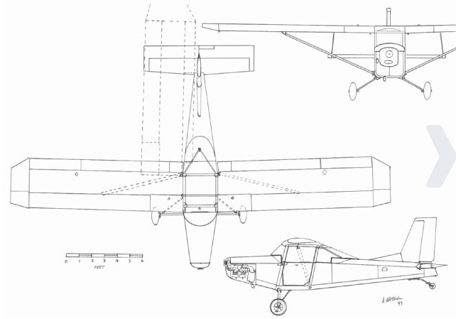

Head in the clouds Posted February 7, 2013 Author Posted February 7, 2013 The problem with the STOL planes is you need a tonne of power to go places fast, which rules out cheap. You have to live with compromises. You can put a T1 on a trailer, just need a longish one to fit it on. The wing is 20' and the fuselage 19'3". Takes two people but that's reason to be a club. T1 is still a 150-300 hours of work which is 1/2 the time for a Sonex or a Zodiac. Hey FT, I think we might be batting on opposing teams here. The whole thing about the old way of ultralight flying was the journey, not the destination. We were never trying to "go places fast", we were happy going anywhere, and going anywhere slowly gave time to appreciate the scenery. It's a bit like travelling by walking rather than driving. There was less stress, if your engine failed, oh well it failed, we'll land down there... and the others did so too, new spark plug and off we go again. If you fly a low performance plane you can land most anywhere, the higher the performance the higher you must fly to be safe. Compare outlanding a parachute or a Learjet to follow what I mean... We flew like the birds, literally, planning into wind outbound, and with the following wind on the way back, beware the sea-breeze and all that. On a good day you could take the last of the land-breeze to the coast and race home surfing the sea-breeze. Going inland plan it all a bit later out, and earlier back. It taught you much more about flying and the micro-met weather than GA or this more recent RAA toy-GA ever will. I didn't realise the T1 was such small span but what I propose is that 20ft (19ft actually, as a biplane) span for the 2 seater, and it wouldn't matter how much power you gave it, it wouldn't go fast, but with a big prop and low horses it'll still STOL and climb well. Ever seen a boat with too much horsepower? The extra engine weight destroys the design concept, there's not enough buoyancy. All they do is dig a big hole in the water at the stern and sit bows to the sky, make heaps of noise and spray and it really feels like you're flying along but the GPS says otherwise and the fuel gauge sends you broke. You simply cannot make a fast and strong 2 seat plane cheaply. So this thread is about a slow and cheap 2 seater that STOLs and climbs well and also folds easily in 2 minutes into a small package. That's the design criteria but I'm always willing to add to it if anyone can show me how. As a PS, the only way to make a plane go both fast and slow with low horsepower would be by hugely variable wing geometry (massive 3 stage flaps and slats probably) and that wouldn't be cheap...

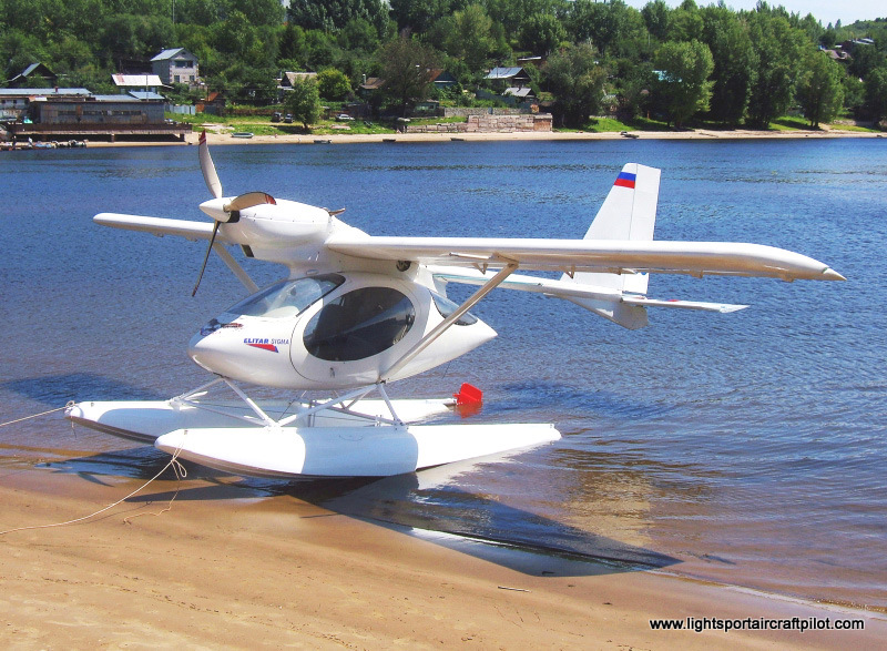

Head in the clouds Posted February 9, 2013 Author Posted February 9, 2013 I can't find the post now but someone at some stage said they didn't like the looks of the high tractor engine configuration and I commented that it's necessary for this design to get it short enough to trailer, and it also has benefits for STOL and soft ground ops. I also mentioned that I'd see one with an engine cowl that made it look pretty good. I finally found it, it's a Russian plane called an Elitar Sigma And here's one for you FT, should be fast enough I think Still working on the AirToy but mostly going backwards rather than forwards getting simpler construction sorted out, don't give up hope! 1
DGL Fox Posted February 9, 2013 Posted February 9, 2013 If the Sigma is the little one on floats, how cute is that...I will have one of those 2

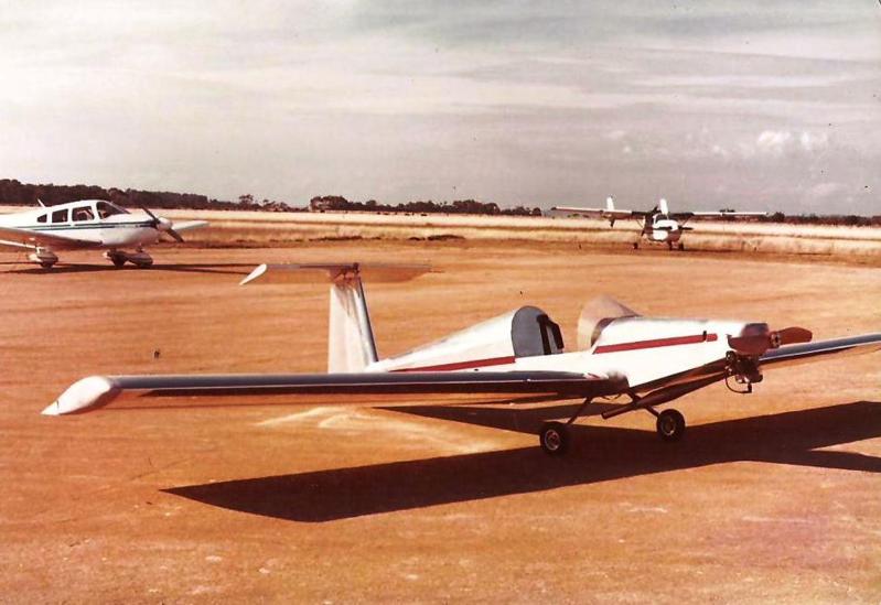

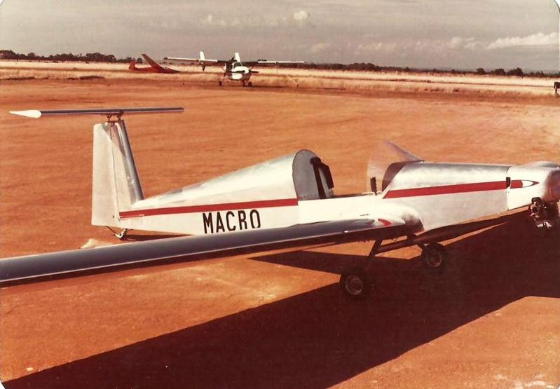

Pilot Pete Posted February 10, 2013 Posted February 10, 2013 As for Simple 95:10 single seaters, I think many would be interested in the Macro.... How simple was it? What does one of these look like?
Head in the clouds Posted February 10, 2013 Author Posted February 10, 2013 As for Simple 95:10 single seaters, I think many would be interested in the Macro....How simple was it? What does one of these look like? This was the Macro 1, built in '84 in 3 months, it used a Robin 244cc 18hp direct drive, 32" prop. Then I built 6 Macro 2 they were much the same but a bit larger, the later ones used R277 engines with gear redrive. They took a couple of months each to build. Following them I built one Macro twin which was the same construction method (bonded aly) with 2 seats side by side and twin wing mounted Robin engines and tri-gear. The new regulations didn't come out in the expected form so that 2 seater was never legal and so no more of them were built.
