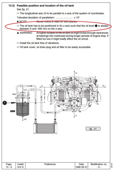

Downunder Posted June 18, 2015 Posted June 18, 2015 Different aircraft can have their oil tanks at different heights in relation to the engine. Rotax specify a range I think. A higher placed tank may run a lower oil level to stop oil draining into the engine sump. Be careful. 1
ozzietriker Posted June 18, 2015 Posted June 18, 2015 Different aircraft can have their oil tanks at different heights in relation to the engine. Rotax specify a range I think.A higher placed tank may run a lower oil level to stop oil draining into the engine sump. Be careful. Down under Thanks for your post, in my case - the oil tank sits slightly below the engine and can be ruled out.

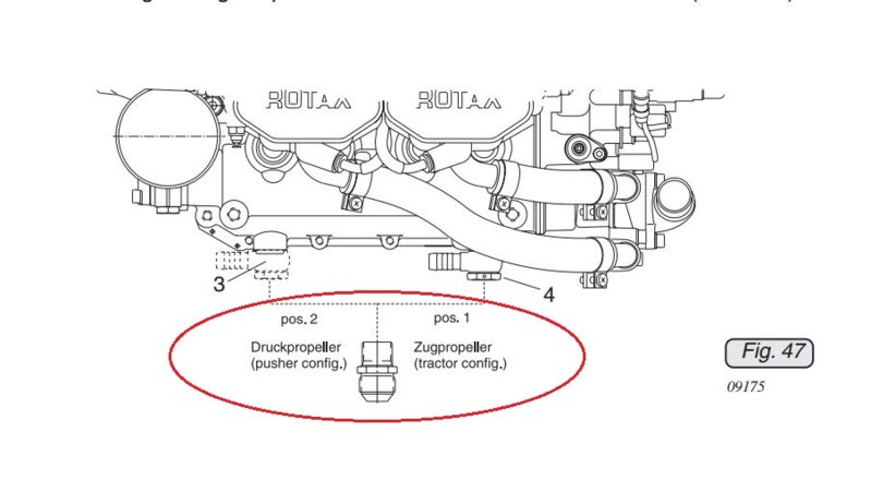

Downunder Posted June 19, 2015 Posted June 19, 2015 Here's something I'll throw up in the air. I think there are 2 return oil points on the bottom of the engine. One for tractor and one for pusher config. Check the right one is piped up. If you are checking the oil level, is the engine level? Could the engine (or whole aircraft) be on a slight angle and some oil is running away from the drain point and staying in the engine block? 1
Downunder Posted June 19, 2015 Posted June 19, 2015 Different aircraft can have their oil tanks at different heights in relation to the engine. Rotax specify a range I think.A higher placed tank may run a lower oil level to stop oil draining into the engine sump. Be careful. The key wording here is "oil level", not tank level. 1

planesmaker Posted June 20, 2015 Posted June 20, 2015 I had a cylinder hydraulic lock when left several months when overseas. Oil tank was mounted high. I remounted oil tank lower. I had to remove plugs to purge oil from cylinder. Tom
