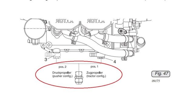

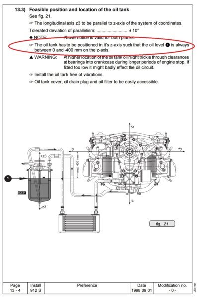

skippydiesel Posted February 3, 2019 Share Posted February 3, 2019 We all love the Rotax BURP & lubrication debate - Me ? I change oil in my 912ULS (800 hrs) every 50 hrs (cause it makes me feel good). I use 3 litres of AeroShell Oil Sport PLUS 4 (G.. what a mouthful). This usually takes the cold level, to slightly above max on the dip stick. In 50 hrs it will drop to max. I have never actually measured the old /wast oil, but I drain into a graduated automotive style drain bowl, estimate my oil usage to be about 150-200 ml, well within allowable specifications. On the oil level indication (stick) - it seems to me that variations in oil reservoir/tank location (particularly hight above crank case) will influence the indication. This can be the case even between aircraft from the same stable & model. BURPING - a deeply satisfying activity no matter how practices. With the Rotax, I do it when cold for all of the aforementioned reasons. I also do it several times between engine starts - I believe/hope this gives me the best indication of quantity, as to do it once will leave considerable residue slowly draining to the bottom of the crank case (not in the reservoir/tank where the dip stick is). I also hold with the idea that this is pre lubricating my engine innards (for less ware on start up) and removing any chance of hydraulic lock in the event of oil "bleeding" into a combustion chamber - this requires a few more than the minimum turns to BURP - I like to do several complete rotations of my engine (deeply spiritual). 2 Link to comment Share on other sites More sharing options...
