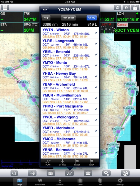

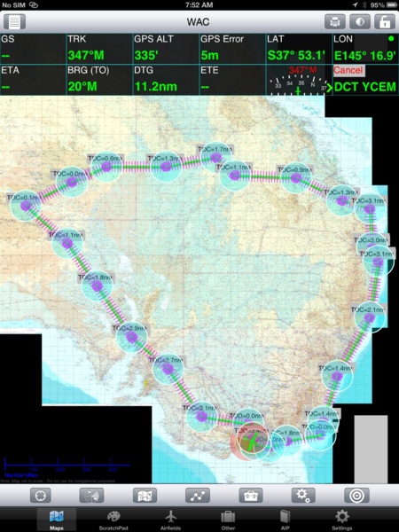

metalman Posted January 12, 2013 Posted January 12, 2013 Hi all, I've been thinking about doing a trip to Ayers rock later this year I'm just after advice ,or tips about which is the best way to go ( from Melbourne ) ,which communities are better for unleaded fuel , I'm looking at early September which will be a bit hot and bumpy but it'll be the earliest I'm able to get away, cheers Met Ive just added an ozrunways screen shot, a couple of places might need to find a servo to refuel
kaz3g Posted January 13, 2013 Posted January 13, 2013 Matt, you are doing very short legs... what is your range excluding reserves? I came back from Alice via Oodnadatta, William Creek, Maree, Broken Hill, Mildura, Locksley and got avgas at each of them. Beware the Aboriginal communities - you need permission for most of them and may not get fuel. Maree was the dearest and it was in drums. I went in August and it was really good. September should be ok, especially in the mornings. kaz
metalman Posted January 13, 2013 Author Posted January 13, 2013 My jigger has 3.5 hours at 80 knots ,the planning a in early stages but it seems I have the endurance to do short legs but not quite make the next spot, I'll have to get a better idea once I've put some hours on it ( very soon) and get some idea of fuel burn, I've talked to a few guys lately and they reckon there's a lot of servos on the sturt hwy with air strips at the back, met
kaz3g Posted January 14, 2013 Posted January 14, 2013 The noise stops in mine after 3.3 at 100 kn. I didn't do the Sturt south of Alice so don't know. There are a couple up closer to Tennant Creek but the road trains often park on them and cut them up. You will love the trip...it's fantastic country and has been in really good heart the last several years. I want to go back and head across to the Gascoyne via Meeka when I get the chance but have to buy a little buddy auxiliary tank to fill the big gaps. kaz

metalman Posted January 14, 2013 Author Posted January 14, 2013 Thanks guys, I'm looking so far at heading across to Port Augusta and then following the Stuart hwy from there, possibly go back via QLD and down the coast. I think Tomorrow got a kero burner to Alice and then did a joyflights around the rock, could be wrong though. ive been a bit conservative with the endurance so I could stretch it out once I've put some hours on the plane and got a better idea of what I'll get out of her. I also may have the option of another 30 l in an auxiliary fuel tank which will be handy. I've looked at going across the Simpson desert but I'm not real keen on that, I've flown around QLD a bit, once your past the range the roads are straighter than I can fly, the Stuart hwy seems pretty good for IFR , I reckon following it would be the way , just have to get the fuel thing sorted, I've got one stop at Prominent hill and then Marla, I haven't got to phoning for fuel yet but I think they look big enough to have a servo at least Met

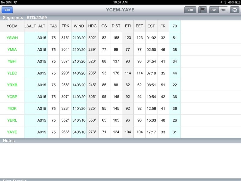

metalman Posted January 21, 2013 Author Posted January 21, 2013 Here's a tidier plan , looking at going in July now, a bit cooler and maybe less turbulence , also putting the word out if anyone wants to join us, a few pilots from my field are thinking of doing the trip aswell Met
matt walsh Posted January 22, 2013 Posted January 22, 2013 Hi MM, I fly a Gazelle out of Penfield near Sunbury and in June last year, 3 othe pilots and myself flew to William Creek and lake Eyre via Swan Hill, Port August(O/N) then to Maree and WC(O/N). Did some low flights over the Lake and east to Arkaroola (O/N) then home over Lake Frome via Broken Hill, Swan Hill and to Penfield. The country north of PT Agusta is brilliant as is the Flinders Ranges and highly recommended. AvGas at Agusta via BP Swipe card. At Marree a local chap comes out and serves up Avgas from a stationary tanker. At WC Avgas available at strip and cash/card from Wight AirServices. At Arkaroola Mogas available from Arkaroola station. I maybe interested in you mid year trip also. My Penfield buddies are considering anothe trip up to Birdsville way and back but would like to include yours too on this years plans so keep me in your planning loop. My email is [email protected] 1
747biggles Posted February 1, 2013 Posted February 1, 2013 Metalman Cadney Homestead (YCDH) have avgas, ULP and donga accommodation. 50 metre walk. 1200m gravel strip - a bit stoney. Also Kulgera roadhouse have ULP, good strip, 200m walk. Rather than spending $$$ at the Ayres Rock resort, consider Curtin Springs Roadhouse... 40nm east of the Rock. No Next G, so book ahead and overfly the roadhouse (beware the tower!!) and they will collect you from the strip, 2.2km away. They have good food, accommodation, camping, ULP. Walk back to the strip pre dawn, for a sunrise take off and fly the scenic pattern around the Rock and the Olgas. Ayres Rock airport has a CA/GRS service, so study up and phone them beforehand, as per ERSA. They are most helpful.
metalman Posted February 1, 2013 Author Posted February 1, 2013 Thanks mate , I'm still looking at different places, and not totally set on the time yet , just got caught in the QLD floods and had to have a week of unplanned holidays , so I have see if I have the time banked to go , might push it back to September , might be a bit warmer to
