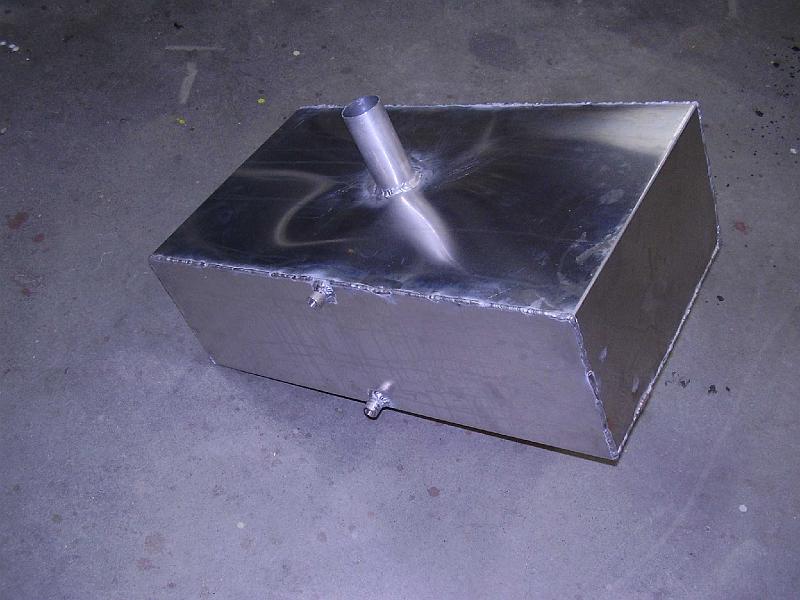

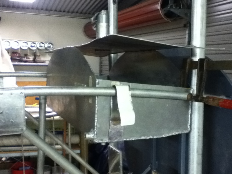

Pilot Pete Posted February 5, 2013 Author Posted February 5, 2013 I already have an aluminum tank for a Robert baslee nieuport that doesn't quite suit my Graeme lee designed nieuport and thought of making a newbie from fiberglass. Might try a cut and shut on the Ali one and get it tig welded

Pilot Pete Posted February 7, 2013 Author Posted February 7, 2013 Here is the fuel tank cut and ready to weld back together. Loose some capacity but gain room under tank to move
fly_tornado Posted February 7, 2013 Posted February 7, 2013 how did you calculate the strength of the design?

Pilot Pete Posted February 8, 2013 Author Posted February 8, 2013 Try this post for the pic of the tank. Its shaped to follow the curve of the top deck between the struts. It used to sit 120mm lower.
fly_tornado Posted February 8, 2013 Posted February 8, 2013 looks alright, what ally did yu use? how much fuel does she hold?
Pilot Pete Posted February 8, 2013 Author Posted February 8, 2013 Tank is made from .050 5052 H3. It used to hold 46ltrs but I think it will end up close to 40ltrs now the top has been rounded.
Pilot Pete Posted February 8, 2013 Author Posted February 8, 2013 This is how the original tank looked..........
fly_tornado Posted February 8, 2013 Posted February 8, 2013 how long will 40ltrs last with the VW? project is looking good by the way.
