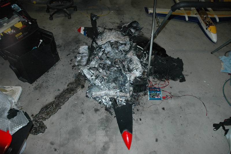

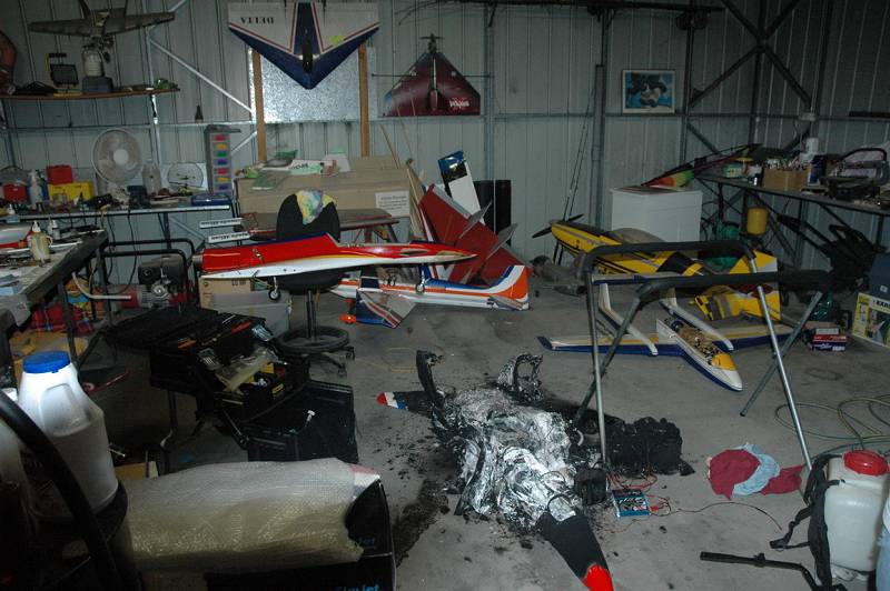

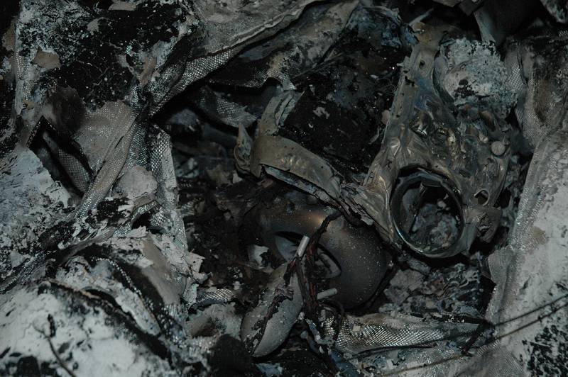

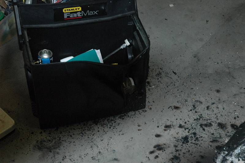

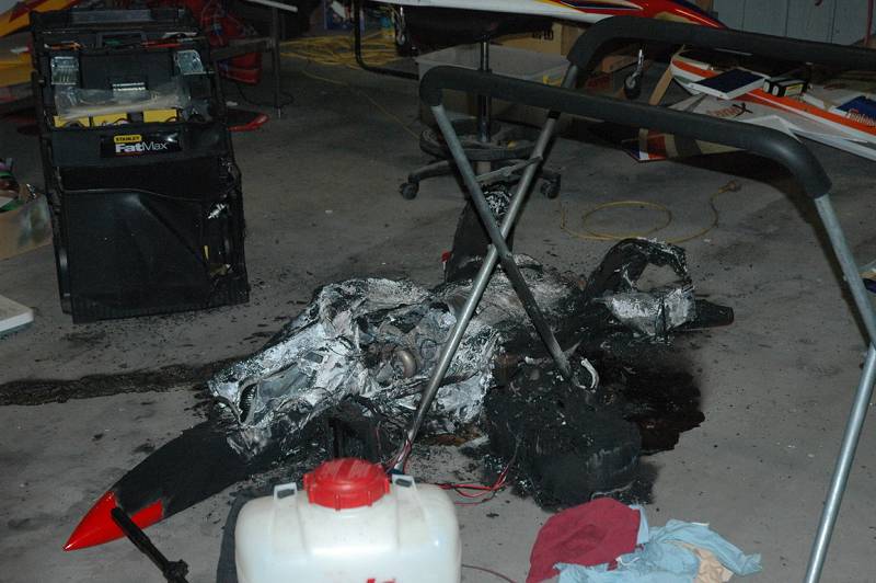

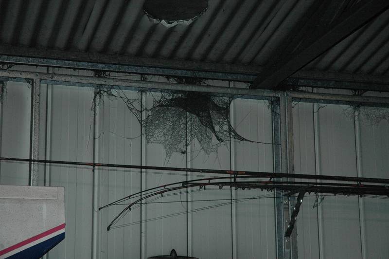

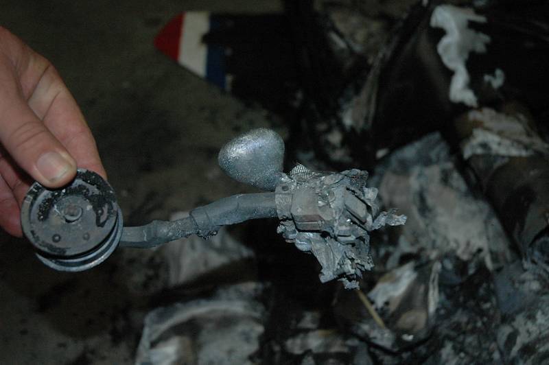

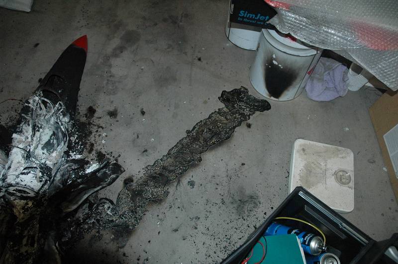

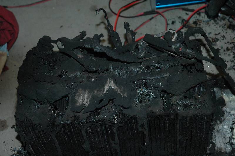

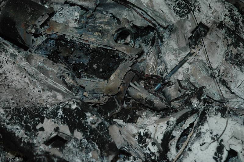

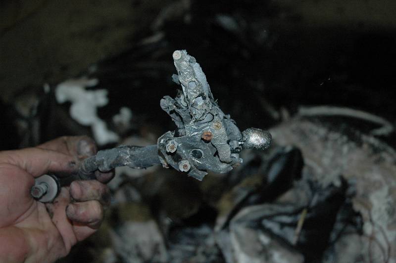

Kyle Communications Posted February 12, 2013 Posted February 12, 2013 Well this is what Lipoly batteries can do if you charge in the model and something goes wrong. It almost took out the whole shed as you can see the 20litre fuel drum and it is next to a 44 gal avtur drum that was full. There is a pic attached of what the finished aircraft looked like. sitting on top of the model was a $3000 radio transmitter as well total cost around $18,000...insurance actually paid out would you believe
