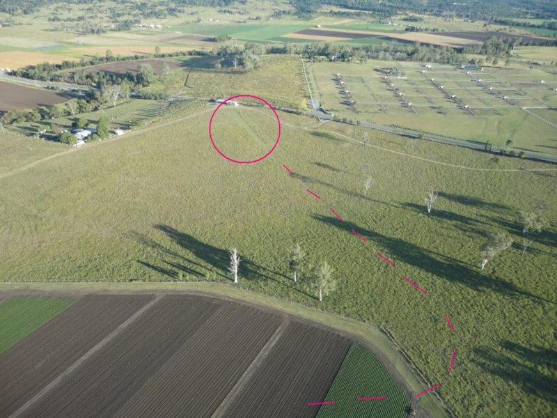

XP503 Posted February 18, 2013 Posted February 18, 2013 This was my strip before I moved to Boonah. Lots of fun but no room for error 1

rankamateur Posted February 18, 2013 Posted February 18, 2013 [ATTACH=full]20818[/ATTACH] This was my strip before I moved to Boonah. Lots of fun but no room for error Is that a horse stud's stalls in the back ground? Good neighbours for a landing area? 1
XP503 Posted February 18, 2013 Posted February 18, 2013 Hey Rank Yes it is actually, a very large international one! And they genuinely LOVED having my Drifter across the road, I took the stable hands for rides - they said the horses didn't bat an eyelid or care at all, same with the local farmers and pickers close by, they would always come up to me and say how cool it looked and how much fun I must be having..... The strip was just over 100 metres long but it runs up hill towards the hangar, one way in, one way out - no going around. I miss that place "Diggers Bridge" 1
