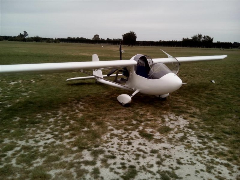

microman Posted September 17, 2015 Author Posted September 17, 2015 Well a few months ago I managed to get my Sapphire back - its an original 95.10 model - short wings with part fabric, fuel tank behind the seat, no flaps etc etc. Almost finished restoring it, and have fitted a twin-carb 503. Just have a couple of concerns and wonder if any other Sapphire owners or previous owners can offer advice - the 503 is quite a bit heavier than the original one I had on it 20 years ago what with electric start, twin carbs, fan cooling etc. I seem to recall that all Sapphires tended to have an aft C of G and wonder whether mine might now be too far aft - I guess the only way to know will be to do a W & B. Also, the 503 has a gearbox with the 2.58:1 ratio - I imagine the 2:1 or 2.24:1 would be preferable, especially as the 3-blade Ivoprop has had to be cut back to just under 50 in diameter to clear the tail-boom. Any advice appreciated. 2

pylon500 Posted September 17, 2015 Posted September 17, 2015 The later version Sapphires had a slight sweep-back in the wings to get the CofG better positioned. Many sapphire owners, not happy with the bungee trim system, have fitted 'anti-servo' trim tabs to the all flying tail, and can now fly hands off. Not much else needed on the Sapphire, it was pretty well sorted from the start. There may be the odd AD somewhere in the system, the top rudder pivot rings a bell....? 1 1
microman Posted September 17, 2015 Author Posted September 17, 2015 Many thanks for that pylon500 - I didn't know about the sweepback - that certainly explains why the later models could handle the 503. I have also fitted a trim tab and hope that I can overcome any slight tail-heavy tendency with that. Of course if its majorly tail-heavy I will have to think again. And I will check the top rudder pivot.

microman Posted October 26, 2015 Author Posted October 26, 2015 Finally flew my 95.10 Sapphire today for the first time after a total restoration - its fitted with a twin-carb 503, and even with the Ivoprop on full coarse it revs out at 6800 static so I can see that I will need to get the 2.24 gear ratio rather than the 2.58 on it currently as prop diameter is limited to 50 inches which is a bit small. Otherwise, plenty of power available and I even managed to 3-point it on landing. 3

pylon500 Posted October 27, 2015 Posted October 27, 2015 Ok as it happened, and the test flight didn't throw up any problems in that area. I have fitted a trim tab, but on the first short flight didn't get a chance to see what effect it might have. Stick pressure was light with no obvious tendency to pitch up. Fitting a simple trim tab may help a little although what's really needed is an adjustable 'Anti-Servo' tab to give better feel and stability. The 'Stock' Sapphires I have flown usually have a tendency to pitch down in cruise if left 'stick free'. There are various stories of people losing items from the (open) cockpit after such 'bunts'. An anti-servo tab will cure this problem. 1

microman Posted October 30, 2015 Author Posted October 30, 2015 Flew the Sapphire again today and only did one circuit - two issues - firstly the Rotax 503 runs smoothly up to 4500 rpm, then has a rough patch, surging etc, until it hits 6000 rpm and it takes off again - all the way to 7000 - if I let it go that far! My theory is that it is either running too lean or too rich in the mid-range and the circlip on the jet needle needs to be moved up/down (not sure which). Secondly, the pitch seems to be very sensitive - more so than I remember from when I last flew it 15 years ago. It is a constant effort to avoid overcontrolling and hence PIO. The stick is very short and I am contemplating adding an extension at the top to reduce its sensitivity. Any thoughts from anyone?
pylon500 Posted October 30, 2015 Posted October 30, 2015 If running a twin carb two stroke, you really need a dual EGT to see what's happening. A two stroke MUST have an EGT, it's as important as an oil pressure gauge on a four stroke. Also check that the carbi's move the same.. If the aircraft feels a bit sensitive than last time, have you lost weight? Are you the same weight with a now heavier engine? I know many sapphires with lead in the nose... Stick extension may work, but it's more likely an underlying warning of something else out of whack. 1
microman Posted October 30, 2015 Author Posted October 30, 2015 I have a single EGT - with the sender at the junction of the two exhaust manifold outlets - temps 600-650C so a little on the high side - have checked the carb slides and no issue there - I've gained 10kg since I last flew it (which probably compensates f0r the 10kg heavier engine) but I dont think thats the issue - stick pressure is negligible but tiny movements seem to have an exaggerated effect.. Will try for a richer mixture and see if that helps the mid-range.
pylon500 Posted October 30, 2015 Posted October 30, 2015 If you have a single EGT probe at the Y junction, it is probably too far away from the port for a correct reading (would read low), so you need to raise the needles (circlip towards the pointy end) If your prop is not absorbing the power, that will also give you a tendency to run hot, is it two or three blade? Do you still have the original 447?, it should have had a 2.21:1 box. It should go onto the 503..
microman Posted October 31, 2015 Author Posted October 31, 2015 Thanks pylon500 - You obviously have some experience of Sapphires - and 2-strokes - appreciate your input. You are right - the prop is not absorbing the power (even though its a 3-blade Ivoprop at full coarse) - due to its limited diameter - but I plan to get the 2.2:1 ratio gears and swap them - that should help, because not only will it give me some more revs at the prop but it should cut back the engine revs. Will also raise the needles as you suggest.
