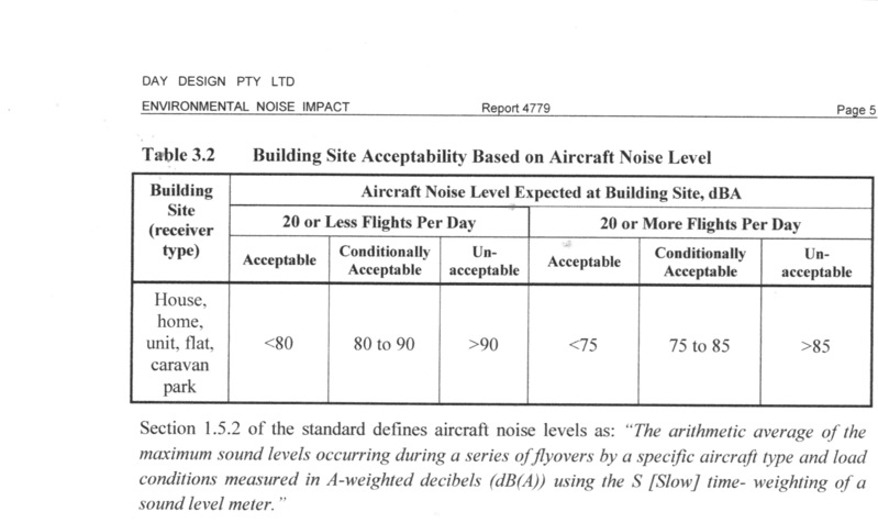

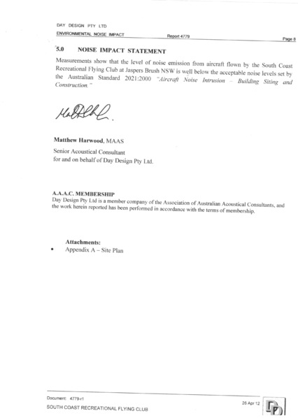

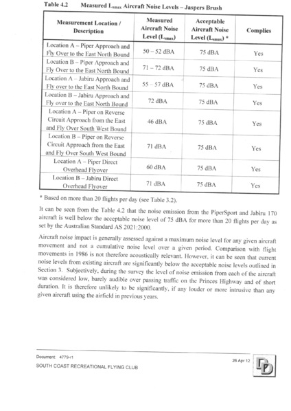

motzartmerv Posted March 5, 2013 Posted March 5, 2013 There ya go ozzie. The australian stanadard your looking for is in the doc. This was our noise study done VERY close to the takeoff path of the aircraft. I dont know if it helps you. 1
Guest ozzie Posted March 6, 2013 Posted March 6, 2013 Merv, who required you to do the noise study? Did you have to do it or was it just done by the council? Who paid? And were the results outside the certified standard? What was the outcome?
motzartmerv Posted March 6, 2013 Posted March 6, 2013 . Hi Ozz. The study was a requiremnt of the DA we submitted. We passed eith flying colors. It was an independent professional survey that we the club had to pay for. In your case I would say you need to get the readings done at the complainants residence, out the front of his house, 208 can crack some noise when you are beside them at low speeds, but the noise drops considerably (from the ptop) as the speed increases so unless this guy is right beside the strip id say you would be ok. See the doc for acceptable levels under the Aussie standard.
