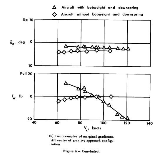

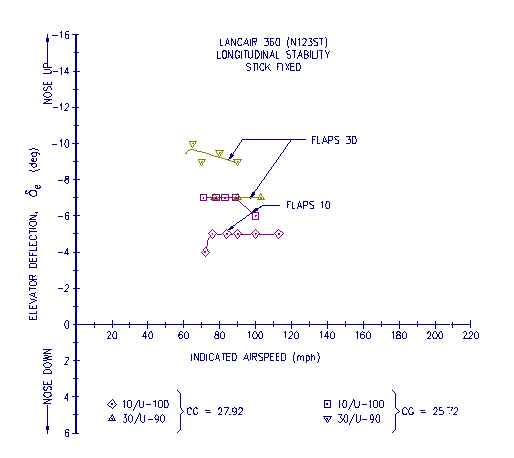

djpacro Posted March 24, 2013 Posted March 24, 2013 Seems to me that people are more likely to get into trouble in those aeroplanes which behave more aggressively than many trainers at the stall or which have nil or negative stick fixed static stability. For example, a nice tapered wing with not quite enough washout or the leading edge profile not exact enough can have quite unacceptable stall characteristics. The RAAF had a problem after wings of their Macchi MB 326s were rebuilt. Stick position movement is a function of stick fixed static longitudinal stability. If you fly a nice stable aeroplane then much of the above discussion applies - especially if you do an EMT course in an aeroplane with no flaps and you don't get to see the effects of cg changes. Longitudinal stability requirements for certified aeroplanes typically mention stick free stability. Pilots feel stick forces which relate to stick free stability. What about uncertified Experimental home-builts? The diagram below shows how elevator angle (treat it as stick position for this discussion - stick back is top of the diagram) varies with airspeed for trimmed, stable flight. Flaps 10 deg at aft cg the stick position remains the same for all airspeeds down to - oops, must be a nose-up pitch somewhere there to need to move the stick forward before it stalls, I guess. Where do you think the stall stick position might be? More info on this aeroplane at http://www.eaa1000.av.org/fltrpts/lanc360/hq.htm 1
facthunter Posted March 24, 2013 Posted March 24, 2013 You are talking of a design with unstable pitch reaction. In many quarters such a response would prevent the plane being allowed to fly. ( as I have been led to believe). Nev
djpacro Posted March 24, 2013 Posted March 24, 2013 They were flying around for a while like that, perhaps still. Nothing preventing a home-built to be built and behave like that. And some well-known older, certified GA aeroplanes have similar characteristics in some configurations. Take a peek at page 28 of NASA TN D-3726, "An Evaluation of the Handling Qualities of Seven General-Aviation Aircraft" at http://www.nasa.gov/centers/dryden/pdf/87726main_H-451.pdf You can see that the stick fixed stability is only neutral.
facthunter Posted March 24, 2013 Posted March 24, 2013 I'm a great admirer of Bill Whitney's approach to all this. He is very practical. He put out a disc and notes some years ago, which I would recommend to all novice builders and some a bit further on than that for consideration. The aerodynamics are proven and structures analysed thoroughly without you having to have a degree in physics and maths. I don't know whether he still does them but there must be some still around. It stops people having to re-invent the wheel and make the mistakes that someone has already done for you. he made the Whitney Boomerang and did most of the work on the Southern Cross replica, design wise. plus other stuff.. Nev 1
