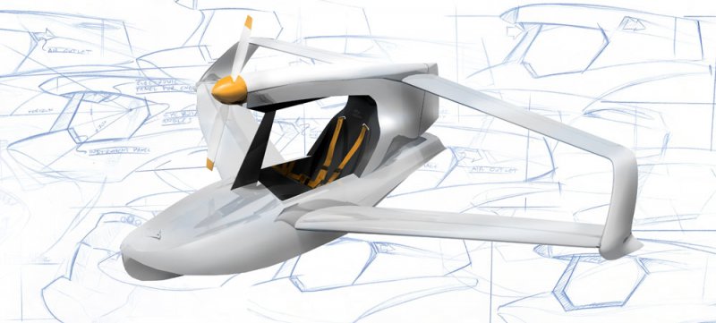

Gforce Posted April 8, 2013 Author Posted April 8, 2013 Any recent news you can tell about the Flynano? It's gone awfully quiet for the last nine months or so. I'm aware of the northern winter issue but we only saw a take-off with a conspicuously absent landing (last seen heading for grassland on the edge of the lake).I'm also interested about the configuration, I guess they must have their IP Applications filed by now so can you tell us anything about what they consider to be patentable? To me it would appear to be much the same as other joined wing, closed wing and box wing aircraft some of the concepts of which have been around since the 1920s, some examples pictured below. Also - do you know what has been done to address the inverted stall issues that seem to plague this general design concept? It seems to be insurmountable in the Stratos and the Flynano looks very similar in layout and probable CG position. Gforce Answered: Sorry, I forgot to Answer your question. Development of FlyNano continues. However, one of there biggest issues has been the weather in Finland. Its a very short flying season for aquatic aircraft so any re development work really does not allow for the right testing time. If it was being developed in a sunny, warn country like most of Australia would provide, I believe they would of completed the V2 testing by now. There is a new motor, esc, batteries and improved wing area with the V2 so like you, I'm very keen to see this begin testing. Once, it has proven to be all that it is capable of being with Safety at the top of the list, I will start importing them. Not before.
