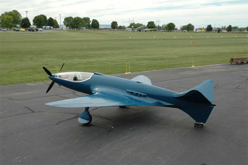

Head in the clouds Posted April 13, 2013 Posted April 13, 2013 Here is everyone's chance to become an important part of aviation history. For those who don't know of the Bugatti "Blue Dream" it was the most technologically advanced aircraft of its time but never flew because of the outbreak of war. It was hidden in a barn near Paris for the duration and languished there for over 50 years until it was discovered in a poor state. It has been reverse engineered and the construction of an exact replica is well under way. The airframe is complete and now the tricky part of engines and transmission is being started. Kickstarter will fund the rest of the project provided a $50k target of fundraising is successful, so far nearly $20k has been pledged. This is important folks - it's the only aircraft ever built by Bugatti, it's the most technologically advanced aircraft of its time and still exceptionally advanced nearly eighty years later. Not only that, typical of Bugatti, it's one of the most beautiful airframes you'll ever see. Here is a link to where you can make a difference, from just $10, and everyone gets a reward. On that page is a link to lots more info about this awesome aircraft - click on the words "innovative Bugatti 100P". Come on folks, get behind this truly worthwhile piece of aviation history. Here's a pic of the Blue Dream to whet your appetite -
pmccarthy Posted April 13, 2013 Posted April 13, 2013 A lovely picture but what drives the propellor?

mothra Posted April 14, 2013 Posted April 14, 2013 Always loved Bugatti designs, well perhaps not that ugly p.o.s. Veyron but thats just a badge enginnering exercise. Even if it doesnt fly, what a beautiful thing! 1

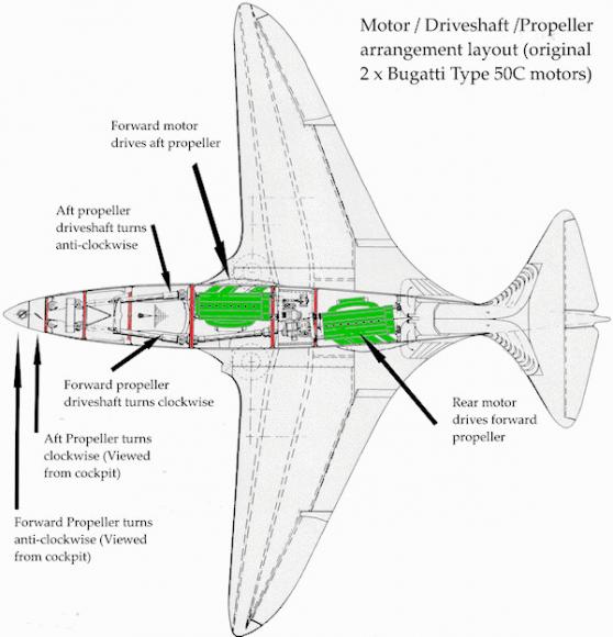

Guest Maj Millard Posted April 14, 2013 Posted April 14, 2013 This is indeed a beautifull design, possibly the most beautifull ever built. Is this the one that the EAA have ?....and in typical Bugatti fashion I'm sure it would go like hell.......... pmccarthy.....The mid-mounted engine drives two counter-rotating props via drive-shafts that go below the pilot, right through the cockpit...That means the pilot would have a high-rpm drive- shaft rotating just inches from his family jewels ! ... bet that would make you fly good !!...........Maj...
Head in the clouds Posted April 14, 2013 Author Posted April 14, 2013 It's actually got twin engines and twin driveshafts each side of the pilot, to a single gearbox in the nose -
Guest Maj Millard Posted April 14, 2013 Posted April 14, 2013 Mmmmm....very advanced, way before the Learfan did the same thing basically ( in a pusher configuration). The one thing FAA didn't like about the Learfan set-up was the one gearbox, on what was to be a transport cat aircraft. They were worried if it should ever run out of oil. Lear got around it by developing a special polimer plug which melted at high temps, and supplied oil-like lubricant to the gearbox for another two hours. ...............................Maj...

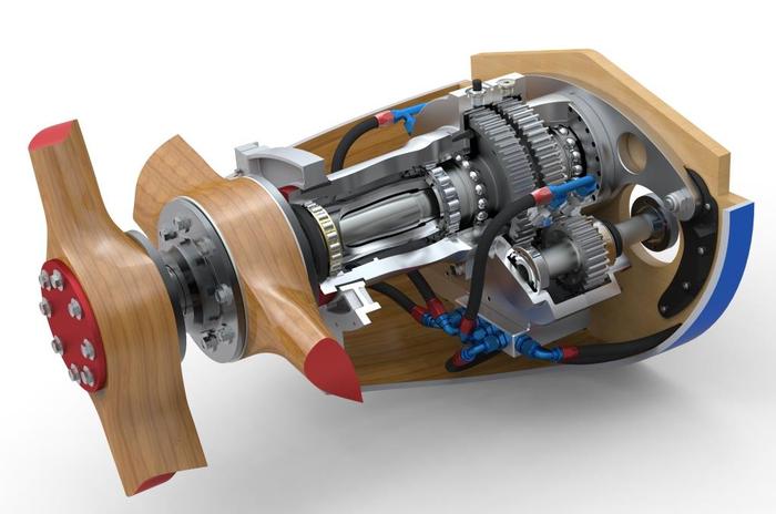

Head in the clouds Posted April 26, 2013 Author Posted April 26, 2013 Bump news - The gearbox arrived from UK a couple of days ago and fitted perfectly into the airframe, a terrific result, and the compound spinner is being constructed at this moment - an interesting spinner since the front half spins one way and the rear half the other way. Best news of all - it was getting a bit worrying because the sponsorship amount didn't move much at all for a few days and so was still $18,000 to go with only 11 days left by yesterday but gladly one very fortunate person has bought a pit crew sponsorship for $5000, so they'll be there to see and help with the early testing. I wish I had $5000 to spare, I'd be there in a flash! So the target is back in the reachable zone at $12,000 to go and 10 days left to raise it. Come on Aussies, who can't afford just a few bucks to be a part of history? This isn't just a replica plane, it's a faithful exact copy of the most beautiful plane ever IMHO, and the original has NEVER FLOWN. The Bugatti must fly.

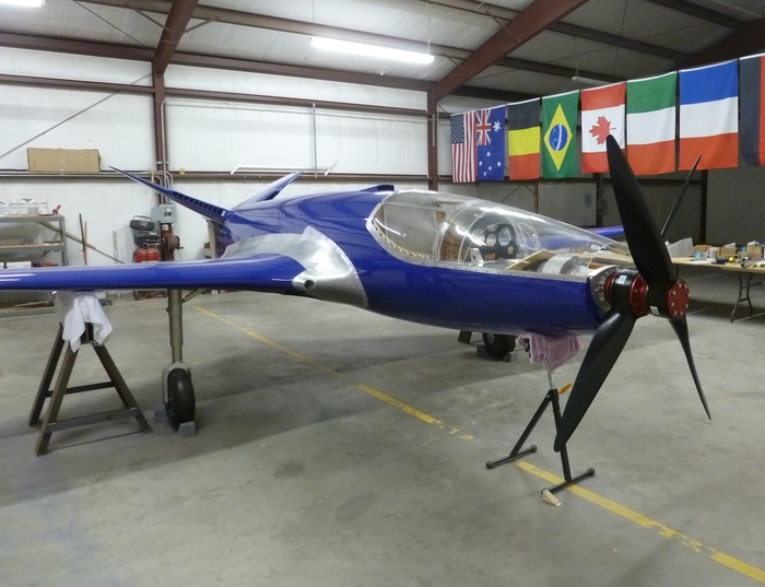

Head in the clouds Posted April 27, 2013 Author Posted April 27, 2013 Latest update from Scotty on the build progress - We've made significant progress over the course of the past few days. The most important milestone was the successful trial installation of the gearbox and propellers. We also covered the rudder and rudder-vator flight control surfaces. The ailerons are nearly complete, as are many of the small cockpit details. We are heartened - and humbled - by the warm and enthusiastic reception you've given us. We're more enthused now than ever and hope you'll encourage your friends to help us meet our fundraising goal. Note you can see the gearbox in the nose and the props hanging off it. And the tailfeathers look great ... You're a good man rgmwa, guess I'll have to buy a bit more to catch up with ya' - maybe a prop bolt, or perhaps a turnbuckle ...

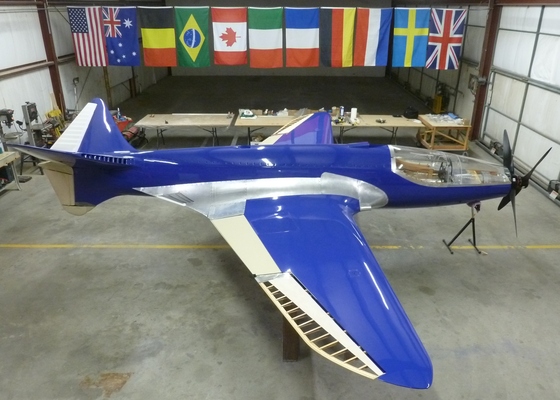

Head in the clouds Posted April 29, 2013 Author Posted April 29, 2013 Seven days to go and only $4700 needed to meet the minimum target, - the Blue Dream will fly! Unfortunately I'm sure it's going to cost more than the minimums so keep digging deep folks. They've posted a close up of the props and gearbox assembly, looks great and here's the link to the Bugatti kickstarter site again, if you haven't seen their brief construction video yet, you're missing out on something good. Note the Aussie flag flying proudly over the project, the flags are recognising the contributions of all nations which are helping with the cost of the build.
