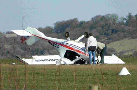

Phil Perry Posted April 16, 2013 Posted April 16, 2013 The pilot got into a "Cyclic" bounce on landing, ( for early learners, this is akin to "Kangarooing" the clutch on your car dddddriving lessons. . . .) which got worse very quickly until the noseleg collapsed, producing the result shown. Maybe a "Go Around" might have been a better idea ( just MY opinion, I wasn't there. . . ) There were, fortunately no major injuries. ( Pilot qualification not reported - - but HEY. . . .Everyone makes mistakes. . . ? ) Incident at Old Sarum airfield, Southern UK, early April 2013. Phil

facthunter Posted April 17, 2013 Posted April 17, 2013 It's a feature of the "simpler" tricycle gear. If the nosewheel is going to contact first , do something about it before it does.nev

facthunter Posted April 17, 2013 Posted April 17, 2013 No NOsewheel is designed to hit first. The aeroplane is flared to a nose-up attitude and settles onto the mains and the nose lowered to the runway (quite carefully in the case of larger aircraft). The porpoising that gradually gets worse is more a thing of smaller planes where there is no real damping of the landing gear, and spoilers are not deployed. Quite a few "light" aircraft have been written off by this. (Mooneys are susceptible). It's usually caused by too fast an approach, or correcting a bounce by pushing the stick forward. I believe that by the time it has happened twice it is time to give it away and go around. ( IF not sooner). Nev 2

Ballpoint 246niner Posted April 17, 2013 Posted April 17, 2013 We teach conversions in this aircraft and part of the type brief is 1 bounce allowed 2 and go around( just like a tail dragger), the SW has a short tail moment and it will become divergent very quickly as the elevator runs out of effectiveness. The LS and MC versions are much more benign , but as other have said, pilots should not think the nose wheel should be part of the landing process, it is particularly vulnerable in most if not all tricycle ultralight aircraft. 1 1

Phil Perry Posted April 17, 2013 Author Posted April 17, 2013 Quote No NOsewheel is designed to hit first. The aeroplane is flared to a nose-up attitude and settles onto the mains and the nose lowered to the runway (quite carefully in the case of larger aircraft). The porpoising that gradually gets worse is more a thing of smaller planes where there is no real damping of the landing gear, and spoilers are not deployed. Quite a few "light" aircraft have been written off by this. (Mooneys are susceptible). It's usually caused by too fast an approach, or correcting a bounce by pushing the stick forward. I believe that by the time it has happened twice it is time to give it away and go around. ( IF not sooner). Nev I agree most vociferously ( is that a real word ? ) Learning to fly in tailwheel aircraft helped me a lot in this regard, as most normal landings were either three point or at least a teeny bit of tail down applied. I didn't get into "Wheel" landings until a little further in training, so it got ingrained as the default attitude for landings. This "Nose - First" thing must be getting more prevalent though, as on my last re-val flight in a Pa28/200 Arrow 3, the young AFI in charge was really getting sweaty when he thought I might "Nose" it in at the end of a simulated engine off approach. . . even though I promised him I wouldn't. . . !! I have flown with an ex-Dak pilot of many years, who had not flown a light aircraft with trike U/C for over a decade, . . . ( for non - Dakkers, wheel landings are the norm as the fuselage near the tail will kink just forward of the fin if you get a loaded 3 point landing attempt badly wrong ) he was GOING to nose it in, as his normal, comfortable "Wheel - Landing" attitude was a little bit too tail - up, and the Piper Tipacer would not have liked this at all. . . . especially seeing as we were travelling at around 78 Kts at the time ( ! ) For the engineering - minded amongst you, have a GOOD look at what's securing the nosewheel in YOUR light sport aircraft, what it's bolted to, and how strong it isn't. . . and it all becomes clear. As another poster on this thread has already highlighted, it's for parking and taxying, and also to prevent the prop from hitting the grass, concrete or gravel until the flight controls begin to work their black magic . . . . Has anyone here done a nice, well flared "Gear - Up" landing. . . OOPS, Don't answer that, Off Topic. . . . need another thread. Phil.
Phil Perry Posted April 17, 2013 Author Posted April 17, 2013 Quote It's a feature of the "simpler" tricycle gear. If the nosewheel is going to contact first , do something about it before it does.nev Ahhh, . . . but doesn't that mean teaching students at a very early stage in their training how to "Think Ahead of the aeroplane " ?? I never found out how to satisfactorily teach that bit ! ! ! ! ! ! Good point though. Phil

facthunter Posted April 19, 2013 Posted April 19, 2013 That's a pretty good example of what happens if you persist (and HE/SHE ccertainly DID). You can't coordinate the controls to correct it. Going around is the answer and the earlier the better the outcome. Nev
