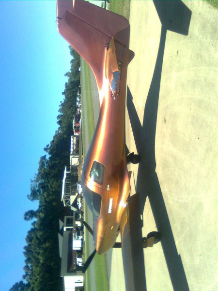

Guest Maj Millard Posted May 9, 2013 Posted May 9, 2013 There is a Lancair in Shute harbor with a full-on pearl paint job (purple). I seem to recall he said he put it in the base paint with clear over the top......................................Maj...
Guest Maj Millard Posted May 9, 2013 Posted May 9, 2013 I do have Cols Email if you want to talk with him about it directly, looks pretty stunning as it goes past the hangar approaching 160 kts ! ...............................Maj...

Mick Posted May 9, 2013 Posted May 9, 2013 looks pretty stunning as it goes past the hangar approaching 160 kts !...........Maj... Does that mean if I paint the Skylark like that it will do 160kts too?
Guest Maj Millard Posted May 9, 2013 Posted May 9, 2013 Only if u put an IO-360 in it with a custom 3-blade Hoffman prop !!!...actually that Lancair will do about 199 at full tilt.....................................................................Maj...
