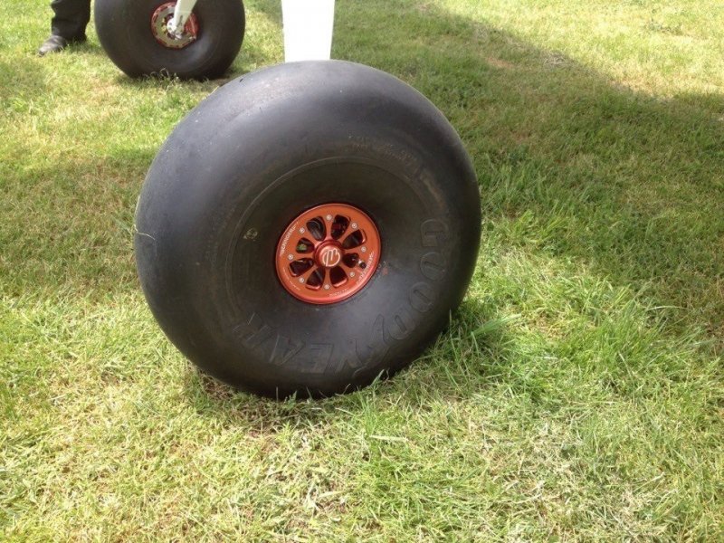

metalman Posted May 5, 2013 Posted May 5, 2013 I'm looking at the Beringer wheels for my Kitfox type, I really like their pneumatic tailwheel, and the bigass bush wheels , saving as we speak!
Patrick Normoyle Posted May 5, 2013 Posted May 5, 2013 Metalman2, how much did your bush wheel tyres cost ? What is their size ?
metalman Posted May 5, 2013 Posted May 5, 2013 Haven't bought them ,,,yet! I'm estimating $3500 for two mains, brakes,master cylinders axles and a tailwheel,,,,I'll have to built new gear to fit it up but I want to do that anyway , very nice gear and quite light, they also do kits with normal size tyres . The eurofox in my avatar is one I rent, my plane is airborne now so I'm keen to fit the same gear, very cool ,and it didn't mess with the cruise speed much, it did make wheelers a bit different though http://www.beringer-brakes.com/ Here's their web site, doesn't work on iPads though

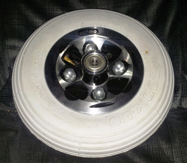

Guest nunans Posted May 6, 2013 Posted May 6, 2013 Hey Old Koreelah, where did you source your wheelchair type wheel and what size is it? I have been looking online for a 120-125mm to no avail.. I have the same kind of wheel on my pup, the tires and tubes are available from the wheel chair mobility shops and the size is 200x50 (8x2inch) The wheels used are a split plastic rim Fallshaw brand here's a link https://www.fallshaw.com.au/wheels/pneumatic/plastic The one I use is the grey plastic one in the centre, they are rated to 75kg but handle plenty more than that and also take bouncing along the paddock at 50 knots alright too !! If you need or have any ballast at the rear to help with c of g then I have this machined wheel with the same tire and tube fitted to it brand new. It weighs more than the plastic fallshaw but is much stronger. (the plastic ones can spread a bit if you run too much pressure) Pm me if you want to buy the machined wheel.
