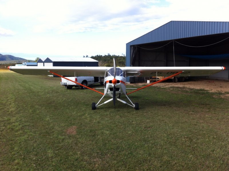

Doug Evans Posted May 19, 2013 Author Posted May 19, 2013 Quote Bolly 68inch 3 blade great performer just fitted one 70 it cruise and is approved for Lightwing That a 582 or 912 ? Just fitted a 72 " bolly 2 blade today got 1000 ft climb and a cruise of 75 @ 5800 very impressed
Steve Donald Posted May 20, 2013 Posted May 20, 2013 582 blue top are you getting 75 out of the 582 ? i asked about the 2 blade 72 inch and they talked me out of it, i know 2 blades is best 2 for go 3 for show, glad your happy with that the 100hp rotax only just makes 80 ish thats a good outcome for you for sure.
Doug Evans Posted May 20, 2013 Author Posted May 20, 2013 Quote 582 blue top are you getting 75 out of the 582 ? i asked about the 2 blade 72 inch and they talked me out of it, i know 2 blades is best 2 for go 3 for show, glad your happy with that the 100hp rotax only just makes 80 ish thats a good outcome for you for sure. Yes very impressed I away flown behind 3blades so was a bit sus but it worked out good even looks the part . That was what bolly said was certified for the 582 s that why I went that way ..
Steve Donald Posted May 20, 2013 Posted May 20, 2013 Quote Yes very impressed I away flown behind 3blades so was a bit sus but it worked out good even looks the part .That was what bolly said was certified for the 582 s that why I went that way .. oh yes that looks the part bloody serious prop hec it would have heaps of static thrust bet the brake wont hold it, even the 3 blade i had to tie off to hold it for run up test, but yea nice props for sure lightwing only approve bolly and Kieve which i havent heard about for years and thats it for prop choices acording to Howard, still Bolly kicks arse anyway so i am happy. 1
